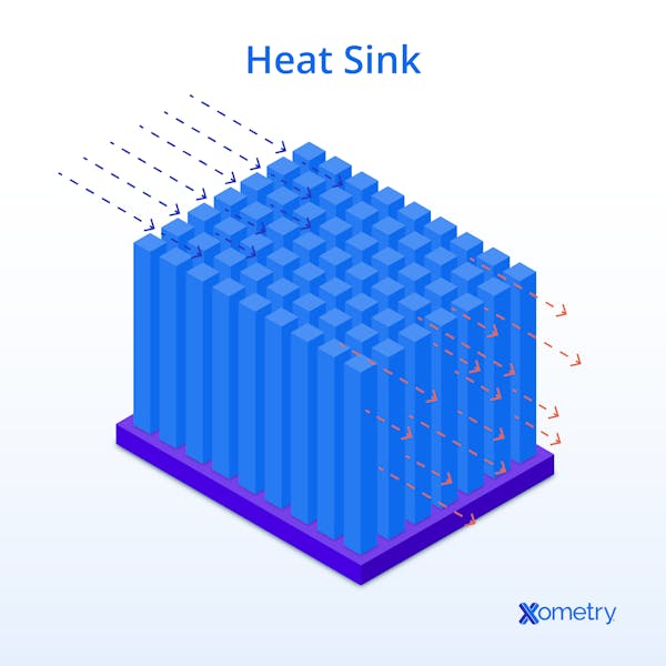

How Does a Heat Sink Work?
A heat sink works by increasing the transfer rate of heat from the hot solid medium to a less hot or cool fluid medium. The heat sink achieves this with the use of pins or fins to increase the surface area and sometimes with the aid of a fan to increase the flow rate. The rate at which heat is dissipated is determined by the heat sink size, type, material, and location.
An illustration showing how a heat sink works
