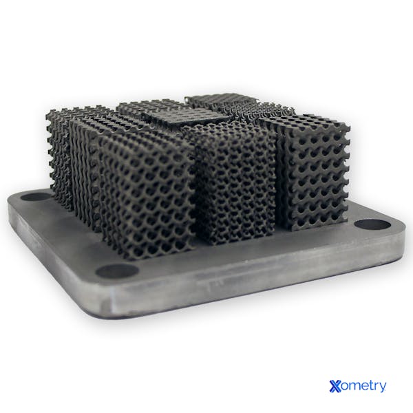

One of the most impressive characteristics of 3D printing is the ability to manufacture parts with complex internal lattice structures that would be impossible with traditional manufacturing techniques.
3D printed part with lattice structure

Lattice 3D print with DMLS
