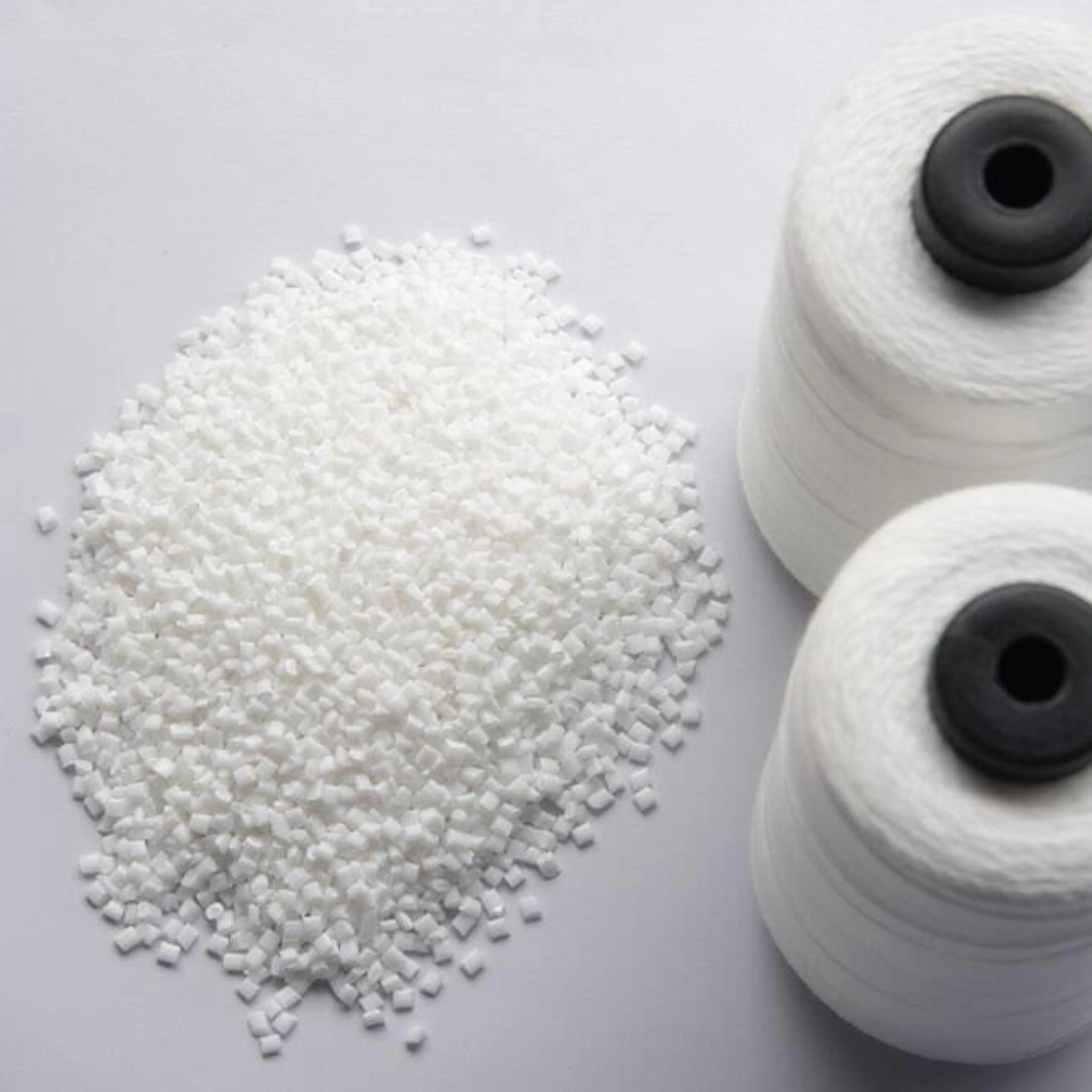

White PET chips. Image Credit: Shutterstock.com/RecycleMan
PET (polyethylene terephthalate) is the most common type of polyester material on the market. It is valued for its excellent mechanical, electrical, chemical resistance, and thermal properties. PET was patented in 1941 by Dickson and Whinfield when they combined phthalic acid with glycol-based substances. When used for fabric, PET is known as polyester, though it’s not technically the only form of polyester. Modern PET is composed of ethylene glycol and terephthalic acid. Ethylene is a colorless liquid derived from glycol while terephthalic acid is a solid crystal that comes from xylene. Beyond clothing, you’re likely to find PET employed for waterproofing, bottling, food packaging, Tupperware, and insulated bottles. This article will discuss PET primarily in the context of 3D printing and look at its uses, properties, and applications.
