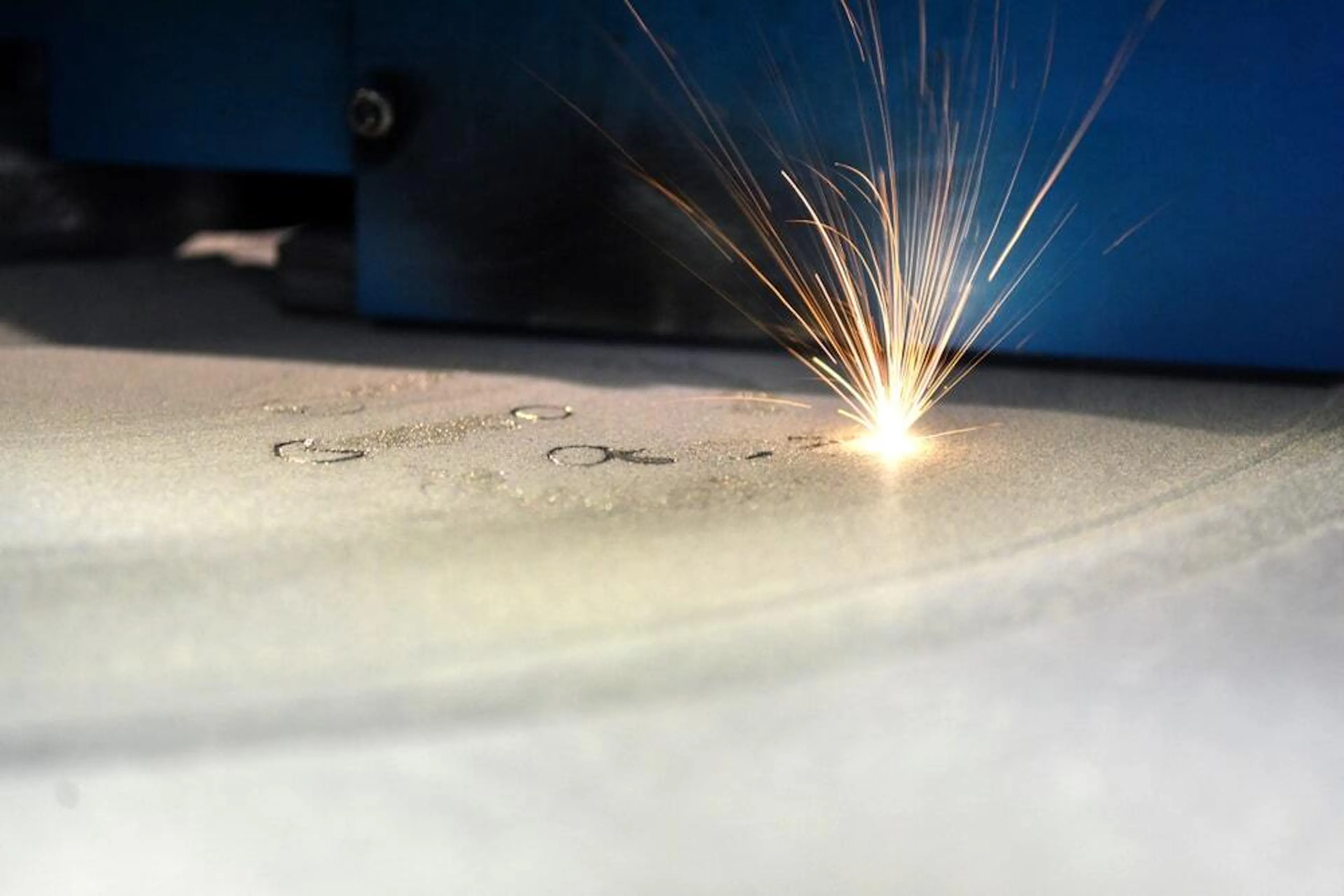

Metal 3D printing. Image Credit: Shutterstock.com/MarinaGrigorivna
