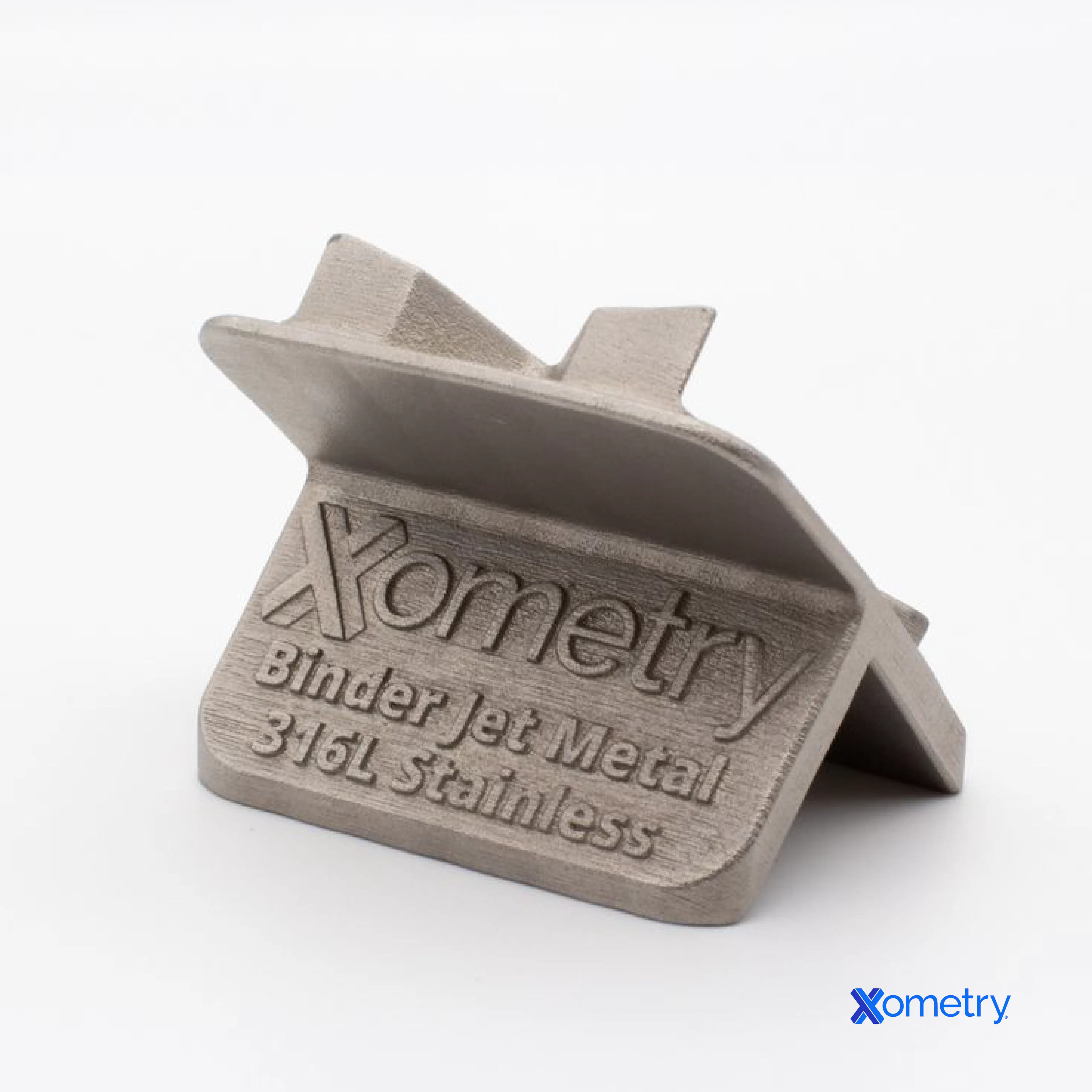

What Is Binder Jetting in Metal 3D Printing?
Binder Jetting in metal 3D printing selectively deposits a liquid binding agent onto a spread metal powder bed, layer by layer, to create a fragile green part without applying heat during the build phase. Sintering temperature depends on the alloy (typically ~70–90% of melting temperature); values vary widely (e.g., ~1,200–1,400°C for steels, lower for some alloys, higher for others). The absence of a high-energy beam during printing eliminates thermal gradients and residual stress, reducing warpage in complex geometries. Binder Jetting supports a wide range of materials, including 316L stainless steel, 17-4 PH stainless steel, copper, and iron-based alloys. Production throughput exceeds that of laser-based systems because multiple print heads deposit binder across the full powder bed simultaneously. The scalability and throughput of binder jetting make it a strong candidate for high-volume production, but it is not universally the preferred process.
Is Binder Jetting Suitable for High-Volume Metal Part Production?
Yes, binder jetting is suitable for high-volume metal part production. Binder jetting is suitable for high-volume metal part production due to its high throughput, low per-part cost, and absence of support structures across standard geometries. Print speeds reach 10,000 cm³/hour on industrial systems, processing hundreds of small parts per build cycle. The elimination of support structures reduces post-processing labor, a key cost driver in laser-based powder bed systems. Sintering furnaces process entire build boxes of green parts simultaneously, decoupling printing speed from densification throughput. Unit costs drop significantly as build volume increases because the binder and powder costs remain low relative to laser machine time. Automotive manufacturers producing transmission components, hydraulic valves, and gearbox housings at scale choose binder jetting as one of the leading candidates for high-volume metal AM, but it is not universally the leading process.

Binder jet 316L stainless steel part.
