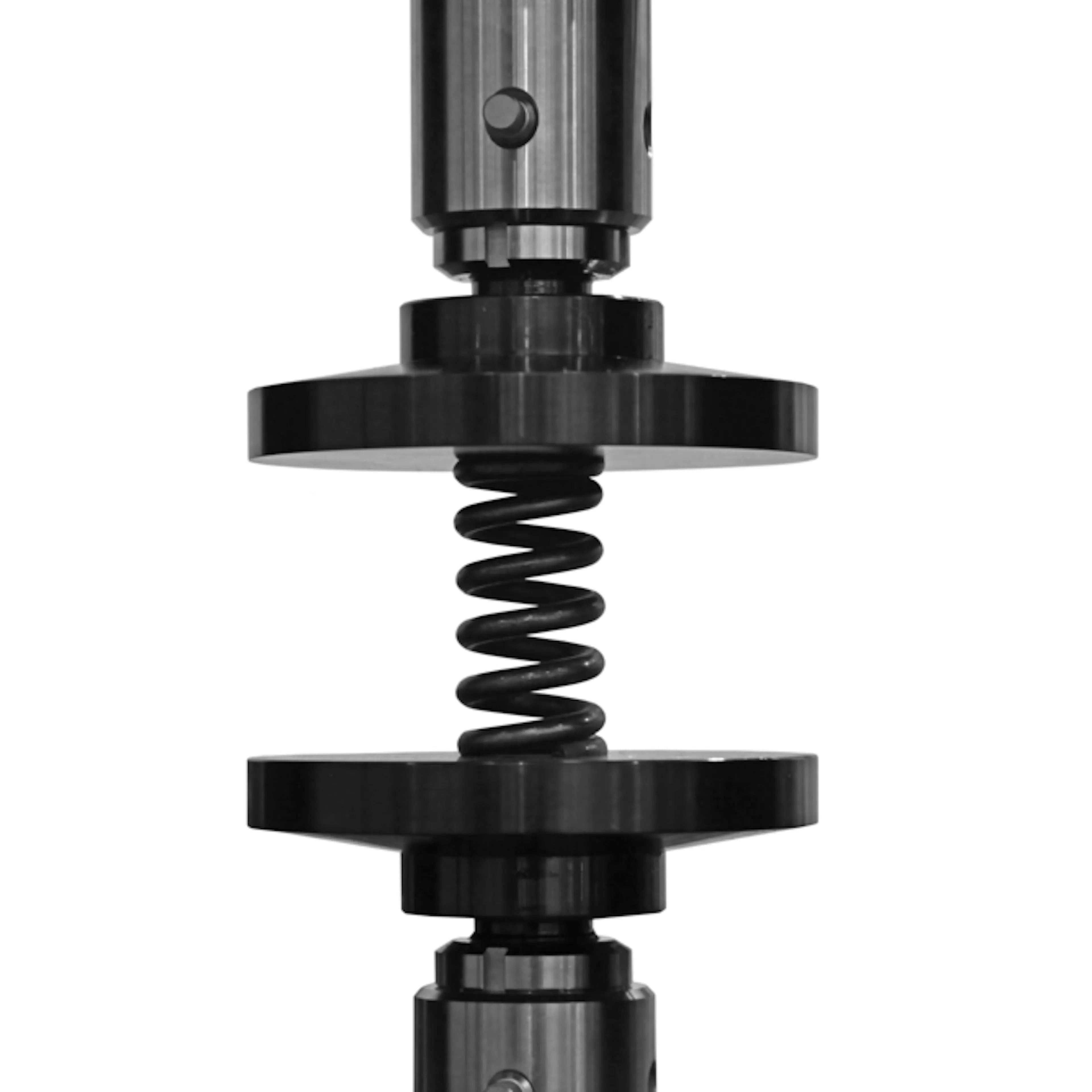

How to Test Compressive Stress?
An overview of how to determine compressive stress is provided below:
- Sample Preparation: Prepare a sample of the substance to be tested. Depending on the test method and the type of material being tested, this may entail cutting, drilling, or molding the material into a particular shape or size.
- Test Setup: Place the sample between two platens on a testing device as part of the test setup. The platens, which are typically made of steel, are intended to evenly distribute the compressive force across the sample's surface.
- Loading: Using a testing apparatus such as a universal testing machine, a compressive load is continuously applied to the sample. The test method typically specifies the rate of loading, which may change depending on the kind of material being tested.
- Measuring Load and Deformation: The testing apparatus measures the amount of force being applied as well as the deformation or displacement of the sample as the compressive load is applied to it. These measurements are used to calculate the material's instantaneous compressive stress and strain.
- Failure and Data Analysis: An Increasing load is applied until the sample fails or reaches a predetermined load or deformation limit. The compressive strength of the material is then determined by analyzing the test data.
