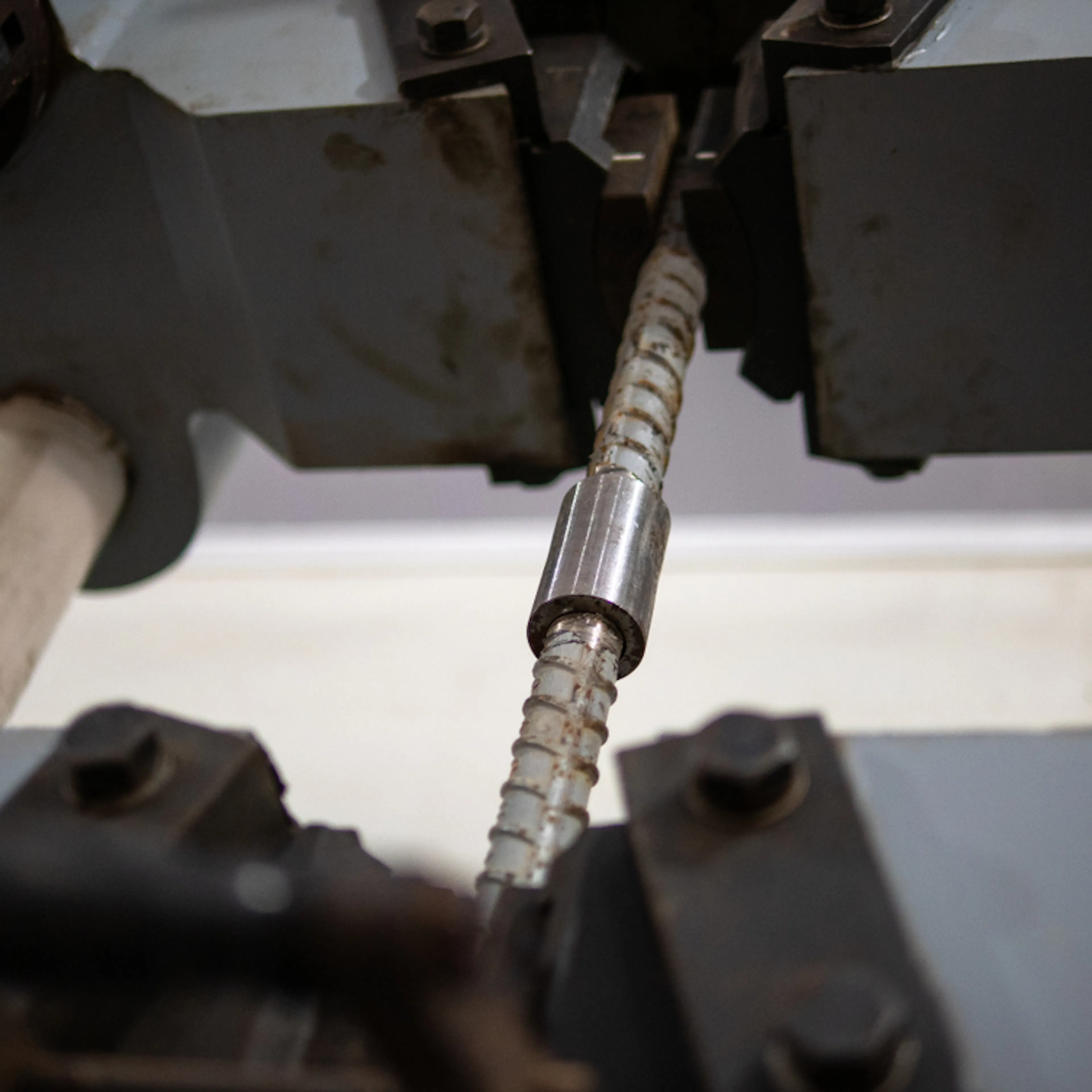

Tensile and yield strength testing. Image Credit: Shutterstock.com/Tohsurat

  1. Prepare the Test Specimen. Machine the specimen to a standardized geometry per ASTM E8 or ISO 6892-1. Measure the original gauge length (L₀) and cross-sectional dimensions (diameter for cylindrical specimens or width and thickness for flat specimens) using calibrated calipers before testing begins.
  2. Mount the Specimen in the Testing Machine. Secure the specimen in the grips of a universal testing machine (UTM). Align the specimen axially to prevent bending or eccentric loading, which introduces measurement error into the force and stress data.
  3. Apply Load and Record Data. Apply tensile force at a controlled crosshead speed, typically from 1 mm/min to 10 mm/min per the applicable standard. Record continuous force (F) and extension data throughout the test using the load cell and extensometer.

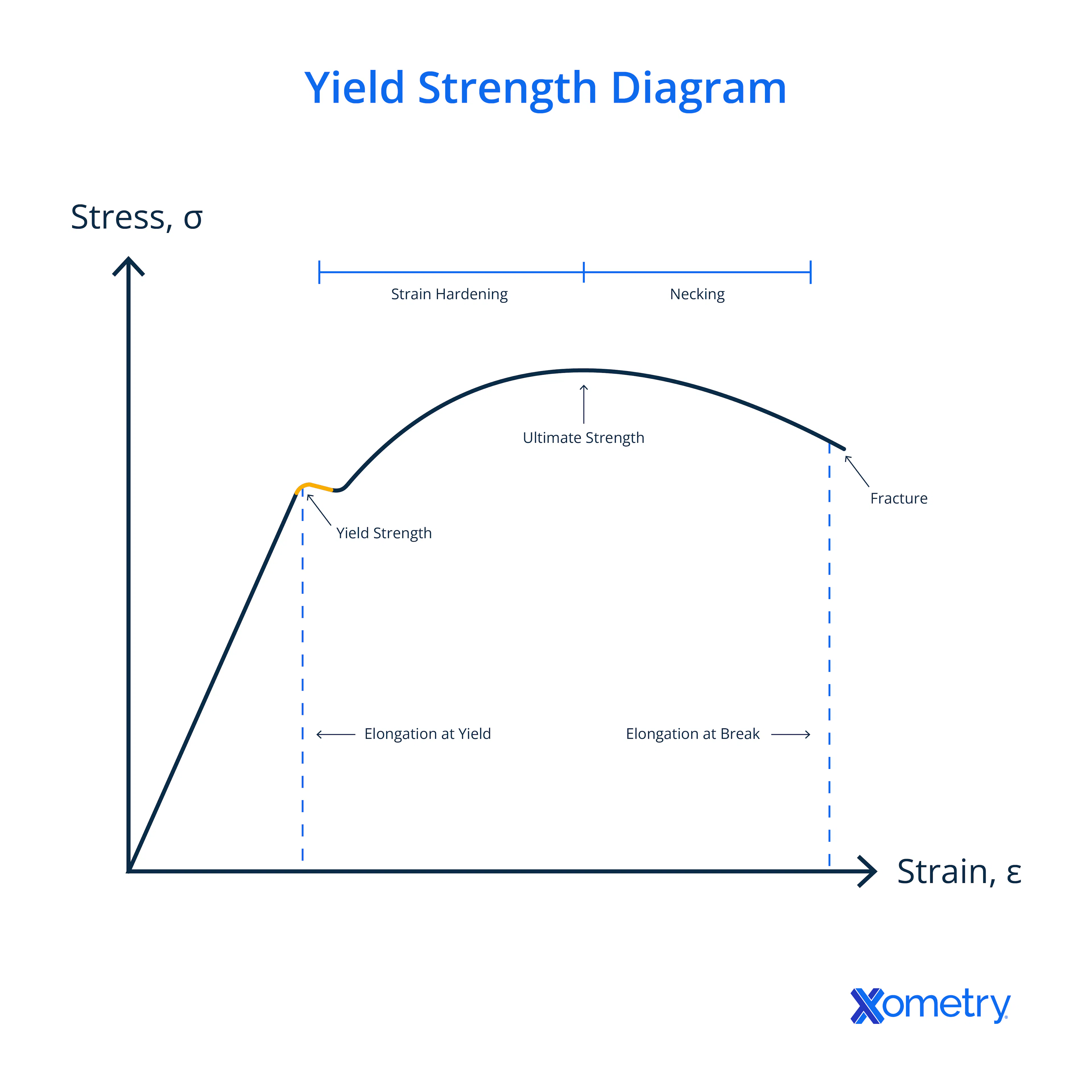

How Is Yield Strength Shown on a Stress-Strain Curve?
Yield strength is shown on a stress-strain curve as the point where the curve departs from its initial linear behavior, marking the boundary from elastic to plastic deformation. The linear portion of the curve reflects elastic behavior governed by Hooke's Law, where stress and strain increase proportionally. The curve bends or levels at the yield point, indicating that the material no longer returns to its original shape upon removal of the load.
The yield point marks the end of the elastic region, separating recoverable deformation from permanent structural change. A distinct upper yield point appears as a peak on curves for low-carbon steel, followed by a drop to a lower yield point and a flat plastic plateau, with values from 200 MPa to 250 MPa for the lower yield point. The 0.2% offset method is applied for materials without a clear yield point, such as aluminum alloys, drawing a line parallel to the elastic slope from a strain of 0.002 to intersect the curve at the yield strength. The stress-strain curve aids interpretation by providing a visual and quantitative representation of material behavior, and the graph serves as the primary analytical tool for identifying what is referred to in materials testing as the Stress Strain Curve.
Where Is the Yield Point in a Stress-Strain Curve?
The yield point is located at the end of the elastic region on the stress-strain curve, precisely where the linear relationship from stress to strain ceases to hold. The internal atomic bonds and dislocation structures within the material reach a critical stress state at a value, causing irreversible deformation to begin. The exact location on the curve depends on the material type and the method used to define yielding.
The yield point follows the linear elastic section of the curve, where stress and strain increase proportionally at a rate defined by the elastic modulus. The curve transitions into the plastic deformation region, beyond the yield point, where strain continues to increase with comparatively less stress increase. The yield point appears at a clearly identifiable stress drop, for mild steel,  from these values are typical for certain mild steels but vary significantly depending on composition and processing. The yield point begins a permanent change in the material's internal geometry, making accurate identification critical for defining allowable stress limits in engineering components. Proper location of the yield point on the stress-strain curve supports structural analysis, component sizing, and material selection across mechanical and civil engineering applications.
