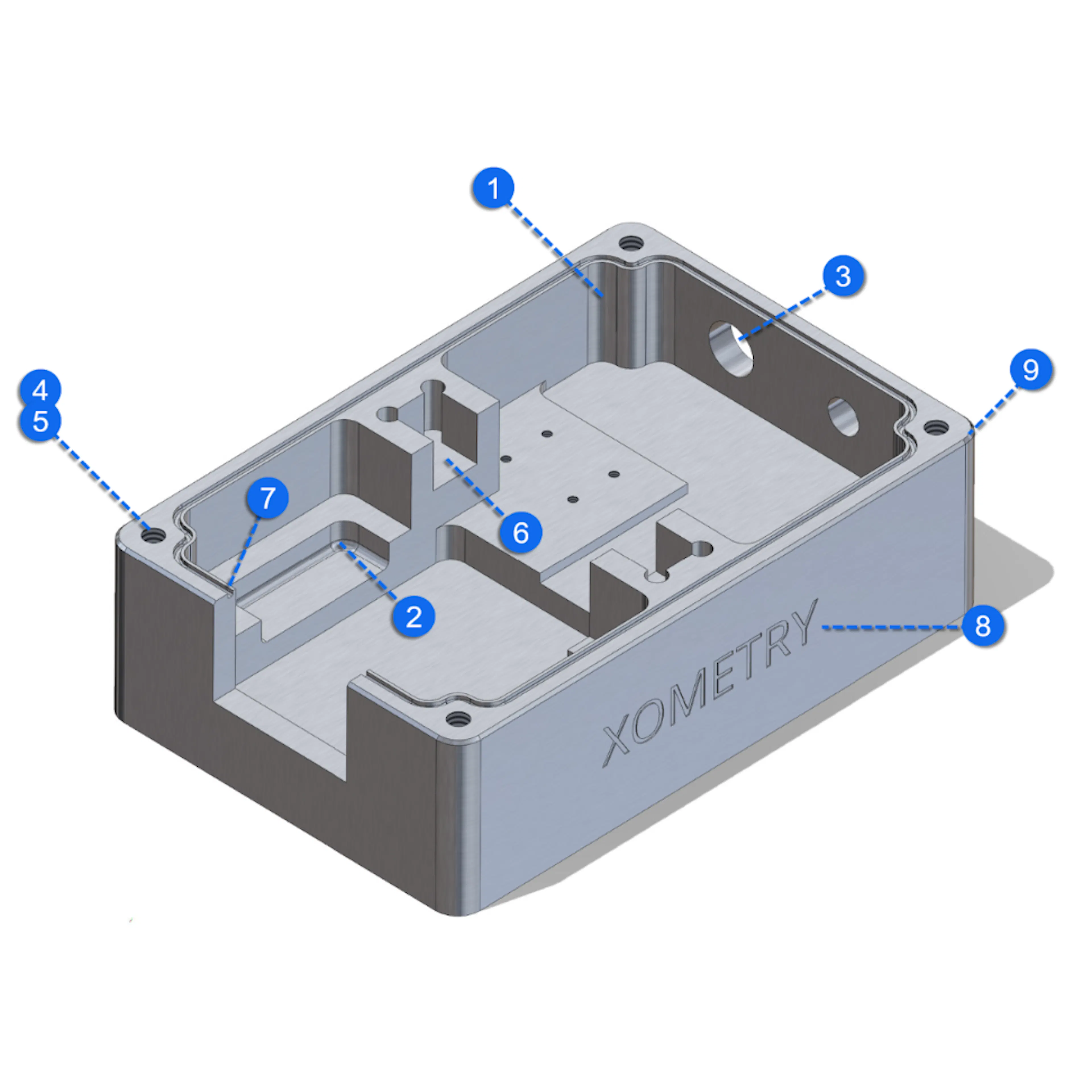

I've learned much about Thread Depth, fillet dimensions, and flat-bottomed drilled holes that will help my future part cogs. What's your favorite DFM trick that you think is underutilized or sparks joy whenever you see it?
Just because we can't machine sharp corners doesn't mean there aren't methods to fit sharp features together. I love seeing circular relief cuts in the corners of a square pocket. You can do the same thing for hex sockets and keyed features. They follow DFM best practices and ensure mating parts fit appropriately. Our CNC design reference poster shows that off well.
So when uploading the 3D model to Xometry, do you automatically change to the radius in the bottom or we need to have the radius in there
You will need to design in the radius appropriately for any sharp internal corners.

Outside chamfer or fillet? Which feature would be easier to machine?
Chamfers are easier to machine and lower cost, often producible in one machining pass vs several passes or surfacing for external radii.
When should we call out or use chamfers?
Design in chamfers that hold a cosmetic purpose to your part. You do not need to model any edge breaks, Xometry will deburr every machined part you produce. If you prefer a machined edge break, make sure to call that out in a technical drawing.

Does the auto-quote care how solidworks has shown/modeled the thread? For example I think there are three options, hidden, dashed or thread cutout?
Hide the thread! We need a hole modeled to the correct drill size (or with enough material to cut on external threads). An accompanying technical print with the thread call out will be our guide for thread type, depth, and inspection requirements.
Are threaded inserts or tapped blind holes more cost effective?
Taps are cheaper because they do not require extra setups and labor. Typically the use of a threaded insert, such as a helical insert or key set insert, is when you know in the use of the part the thread may wear out or need repair (e.g., the part will feel high shock and vibe). We also see threaded inserts on softer parts, like aluminum or even plastic, adding strength to the assembled components and preventing stripping.
What' the best way to indicate thread depth (versus total hole depth) on a drawing?
At a minimum, the thread form, series, major diameter, threads per inch, class of fit, and depth should be specified. Thread depth is often symbolized with a ↧. E.g., 5/16-18 UNC - 2B ↧ .750" would indicate a thread depth of .75 inches.

So if I use a 1/4-20 bolt, do I want thread depth to be 0.5?
That would be on the maximum end of our design recommendations: Length < 2x thread diameter. Be sue to add additional hole depth of at least 50% the hole diameter beyond your thread diameter.
