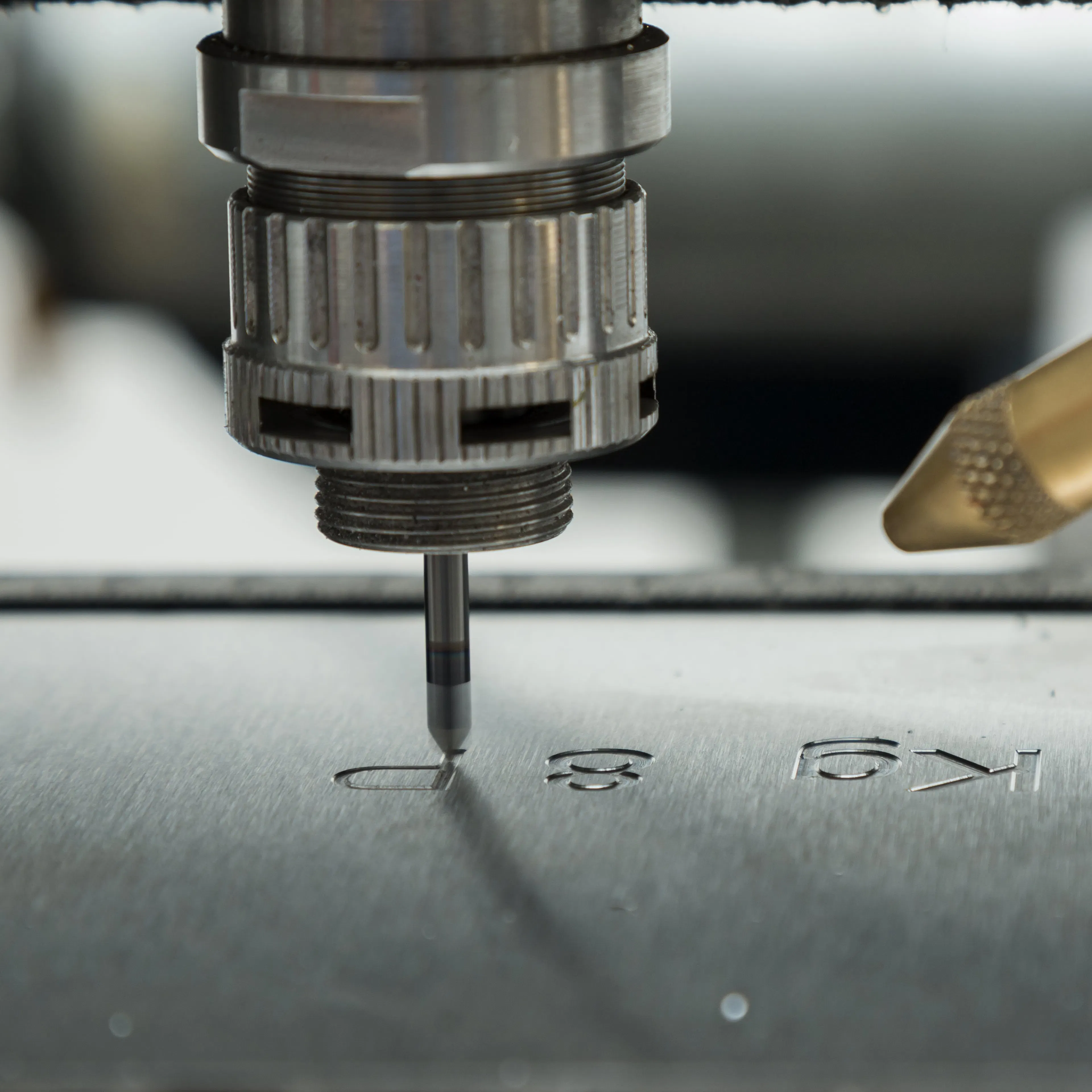

Rotary Engraving
Rotary engraving uses a spinning cutter with a motor-powered spindle to cut or "rout", either entirely through the substrate to create cut-out shapes or at a programmed depth to create grooves that form characters and graphics. The rotary machine engraving method can be used to engrave a wide range of materials, including various plastics, acrylic, glass, wood, ceramic, stone, and solid surface.
Diamond Drag Engraving
Diamond engraving is a variation of rotary engraving. The same machine can be used with a diamond-tipped, non-rotating cutter called a "graver" to mark different materials by scribing lines or grooves into the surface. This method is used mainly for engraving metal.
Using a diamond drag engraver, Rotary engraving systems can also engrave on just about any machinable bare metal such as aluminum, brass, stainless steel, silver, gold, platinum, and titanium. This means the rotary process can be used to personalize just about any item, including off-the-shelf items. Some applications of rotary engraving include watches and jewelry, identification bracelets, pens, die struck medals, charms, and brass or aluminum plates.
