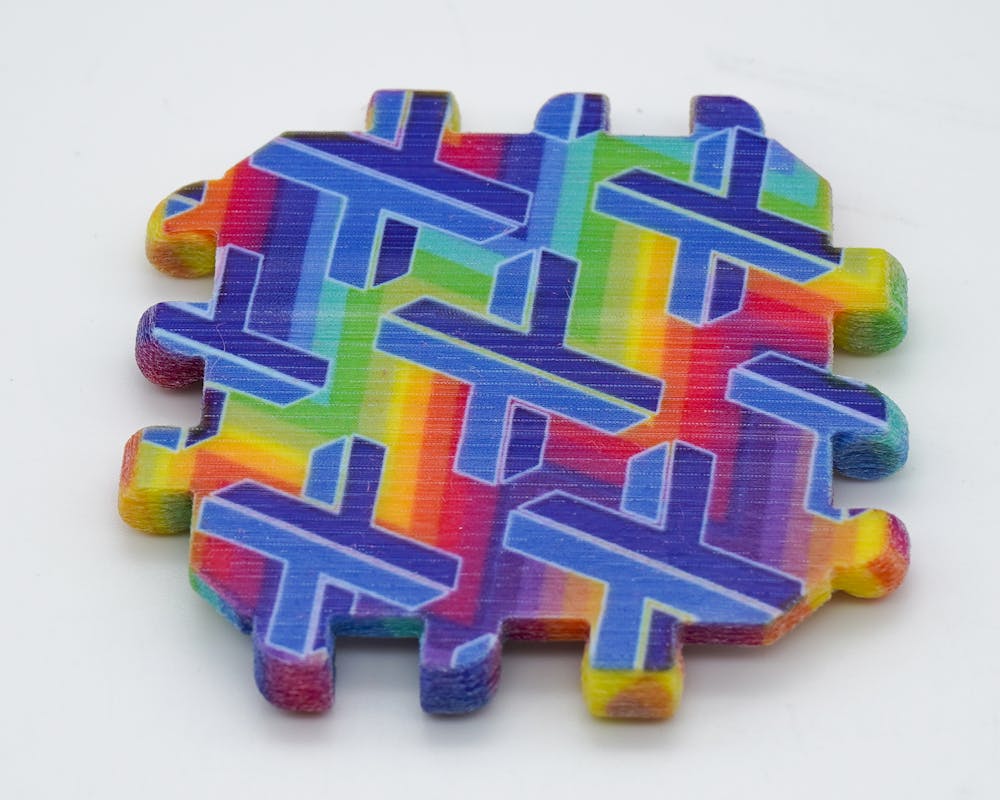

For this video, we used these 3D printable polypanels as our test subject. Here is a list of the processes and materials that were tested:

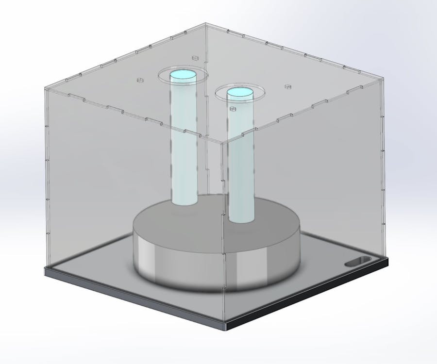

The UV Test Chamber
To perform our UV resistance test, we designed and built a customized chamber to house a powerful UV-C light designed to purify air in HVAC systems. We utilized our Sheet Cutting service to cut the chamber panels from mirrored polycarbonate. To ensure even exposure across the parts, the assembled 3D-printed parts were placed on a turn table inside the chamber.

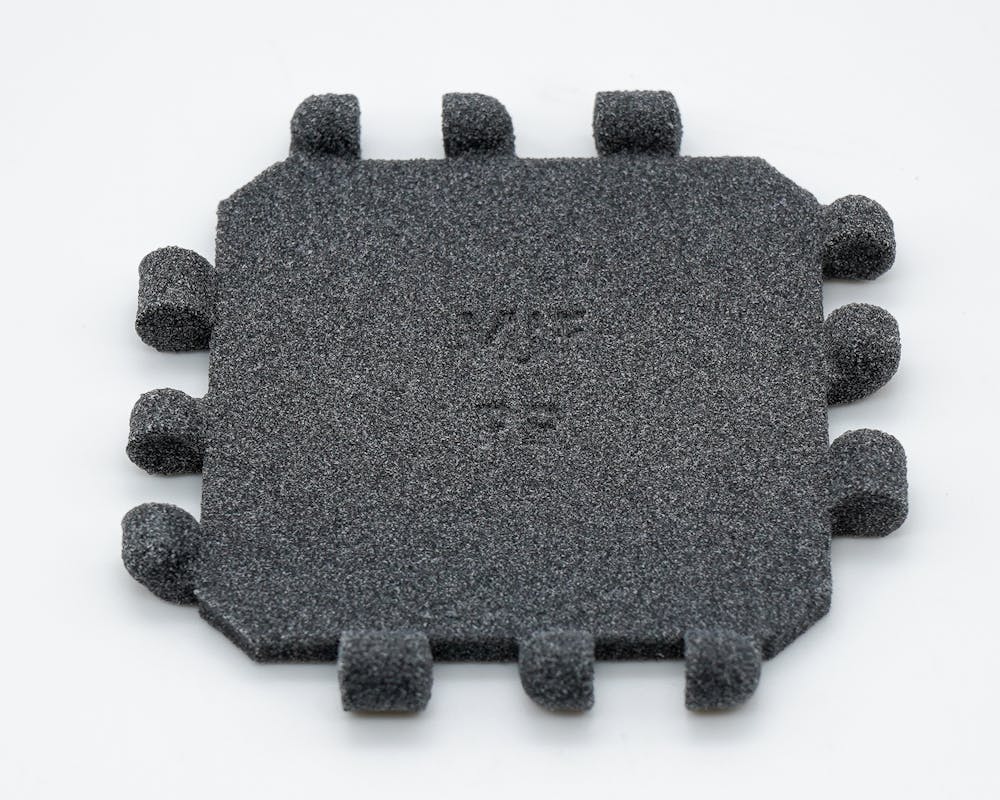

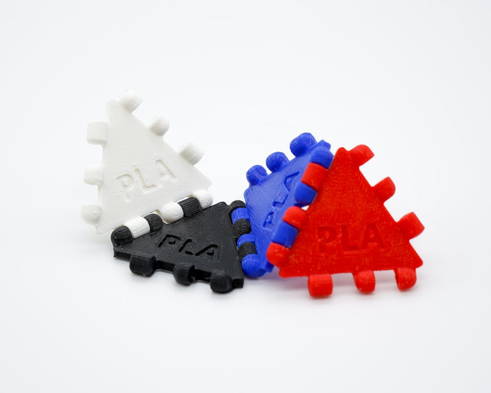

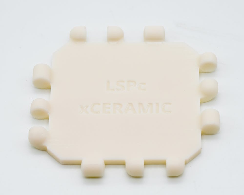

Part Photo Gallery
In the image gallery below, you'll find a few photos of the poly panels we printed for the test. These photos are BEFORE the experiment. If you want to see how they turned out after the test, be sure to check out the video!
Faded 3D Printed Parts
3D Print UV Resistance Results
PolyJet Multi-Color
Left - UV Exposed, Right - Control
PolyJet Multi-Material

FFF PLA
UV Exposed

HP MJF, Dyed Black

LSPc xCERAMIC
