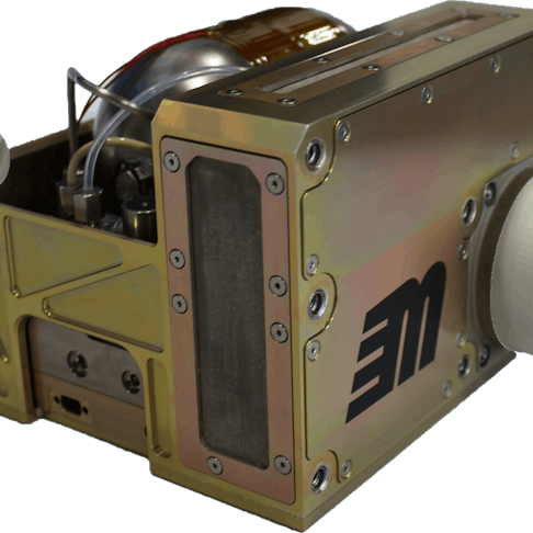

Phase Four aerospace engineer Austin Prater designed an exoskeleton for an EP system that delivers 6-10 mN of thrust and is sized to power a small satellite. The exoskeleton measures approximately 7” by 8” by 5” and is designed to hold various modular subassemblies, including the fluid and valve system, thruster head, and power electronics.
Unlike the Hall thruster, Phase Four’s RF thruster does not rely on expensive, difficult-to-source components like hollow cathodes. Finally, Phase Four designed its EP system with as few assembly components as possible to reduce the number of vulnerable connections that could malfunction during flight. This would increase rigidity, ensure easy assembly, and reduce upfront production costs. The company named its new, trailblazing product Maxwell.

Xometry manufactured seven key components for Phase Four. The most complex part was an exoskeleton for the EP system that was machined from a single billet of aluminum, reducing the total number of components, thereby eliminating vulnerable connections and increasing overall structural integrity. Xometry machined the lightweight chassis components to precision tolerances as specified by Phase Four, finished the parts with a protective chemical conversion coating, and installed threaded inserts where needed.
The unibody exoskeleton to Maxwell with all assembled components. Image Credit: Phase Four
The additional parts Xometry manufactured include a base plate, a front cover, and frames. These parts not only needed tight tolerances, but also had strict surface finish and flatness requirements. Xometry manufactured them exactly to spec, allowing Prater to assemble the product pain-free. Xometry’s aerospace manufacturing partners deliver parts with guaranteed complete precision because, as Prater puts it, “You only have one shot at putting a spacecraft in into orbit.”
