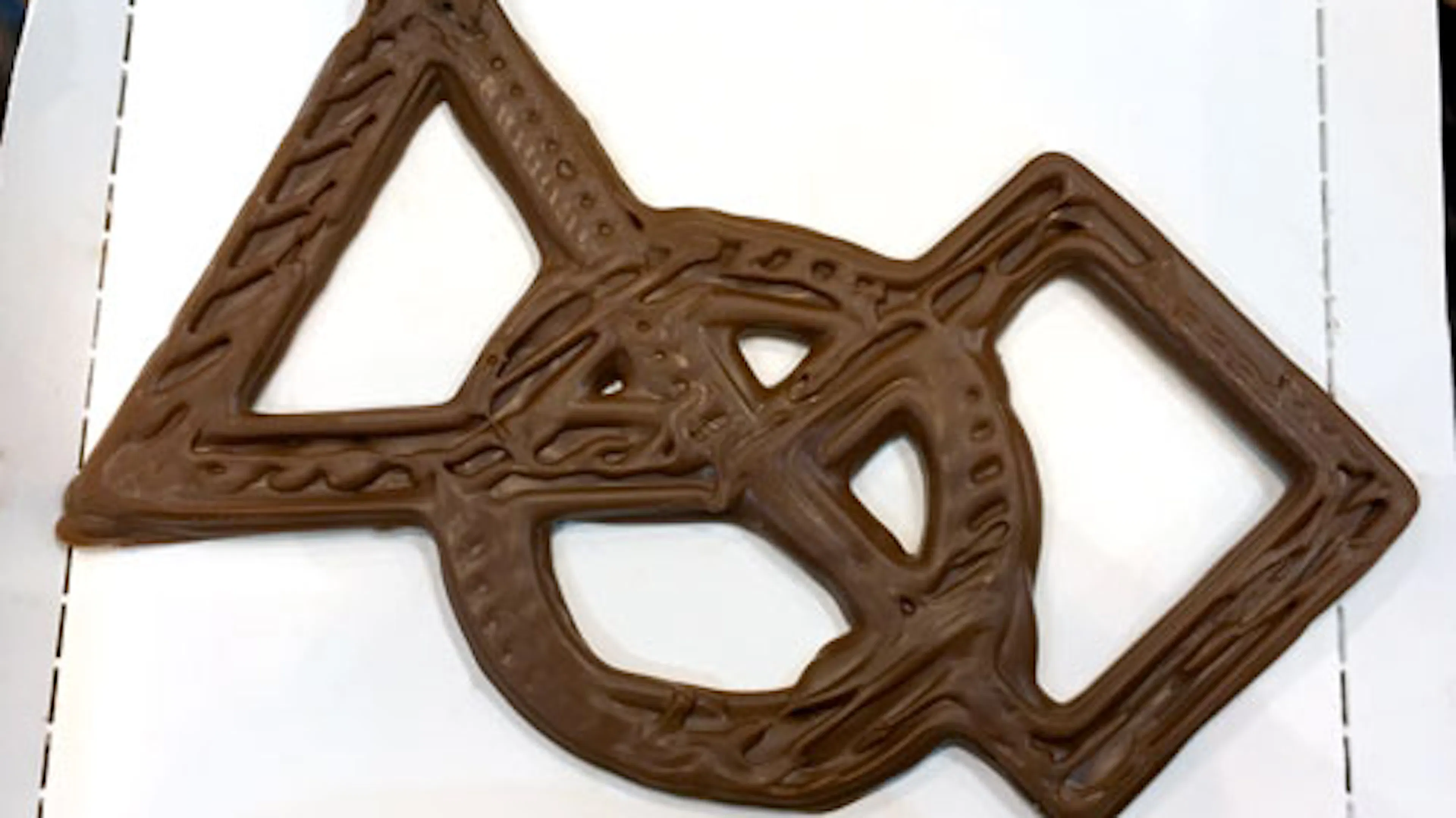

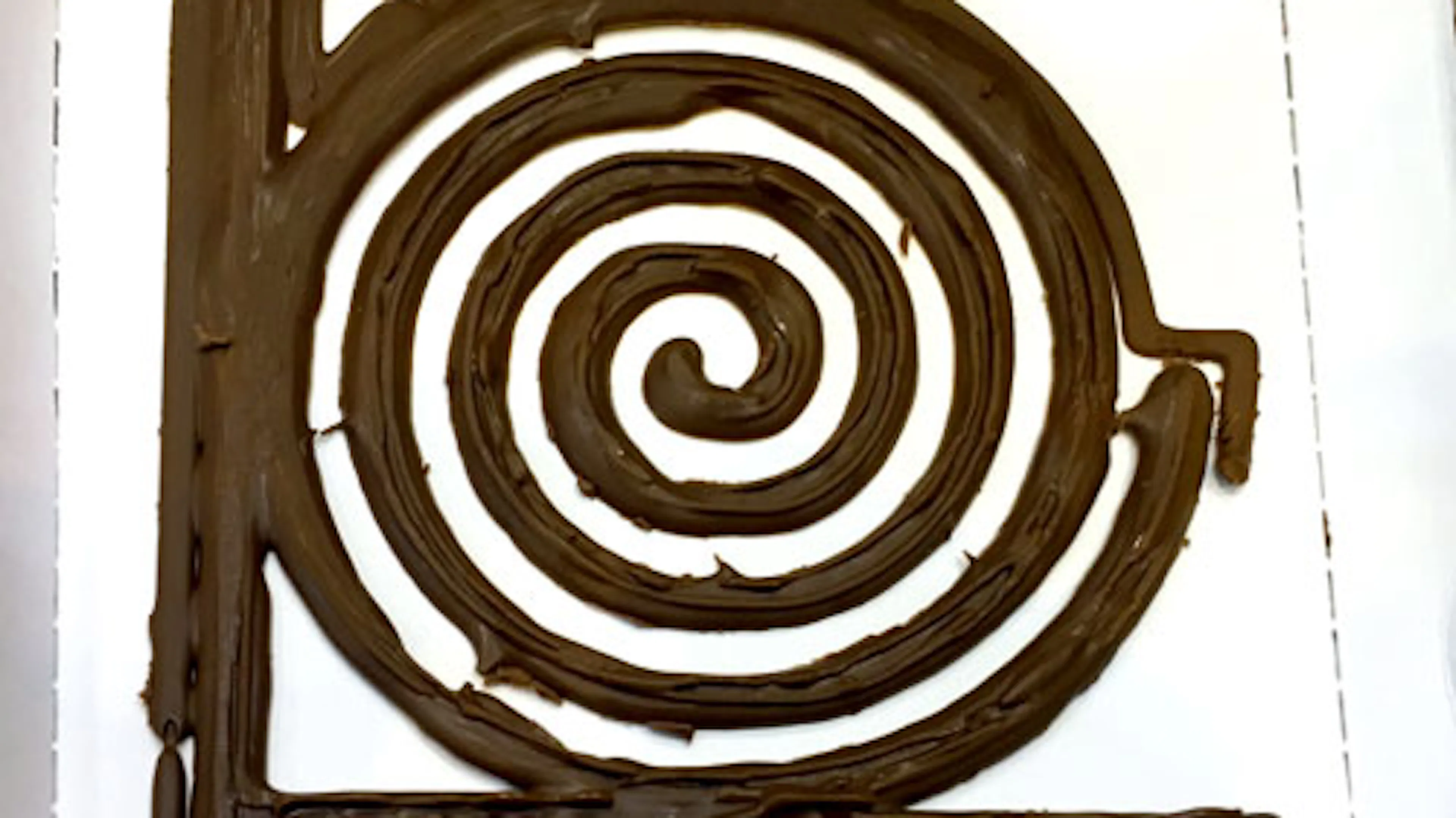

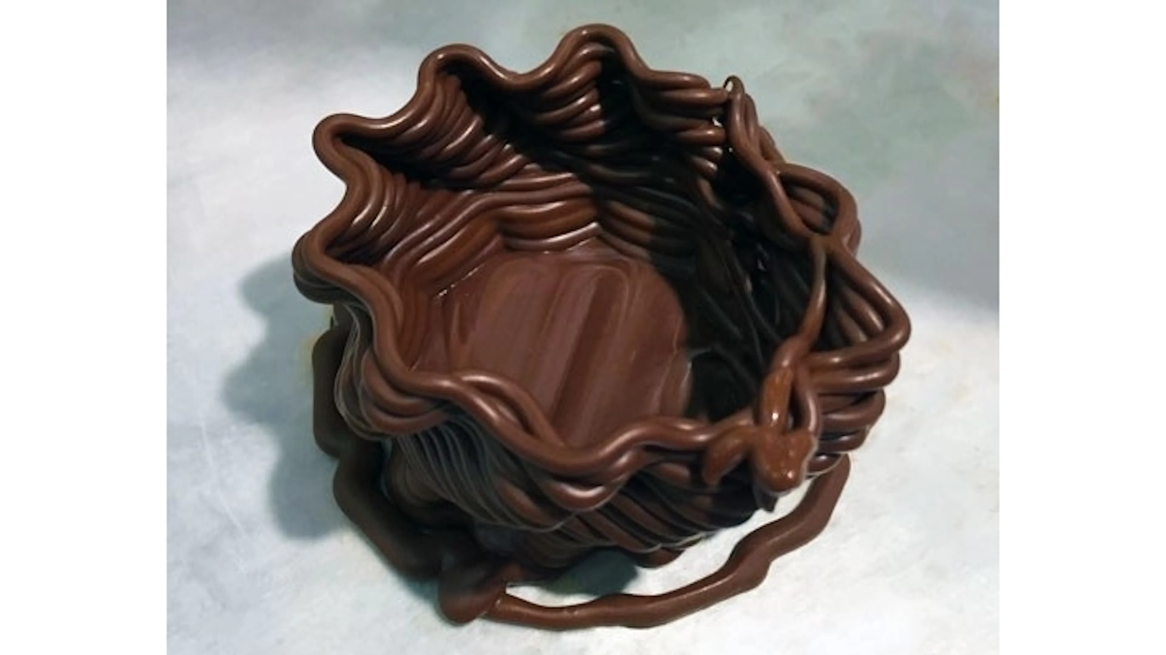

In her junior year of high school, Weinstein combined her love of food and 3D printing by building a 3D chocolate printer. She cobbled together her first prototype with plywood, nuts, and bolts and paired it with an extrusion head, motor, and cooling system. At the time, however, it was unpredictable: it could only build 5-10 chocolate layers tall, melting as it grew because of an inefficient cooling system. Then, the plywood was held together loosely and at irregular angles, causing the machine to bend and flex as it printed.

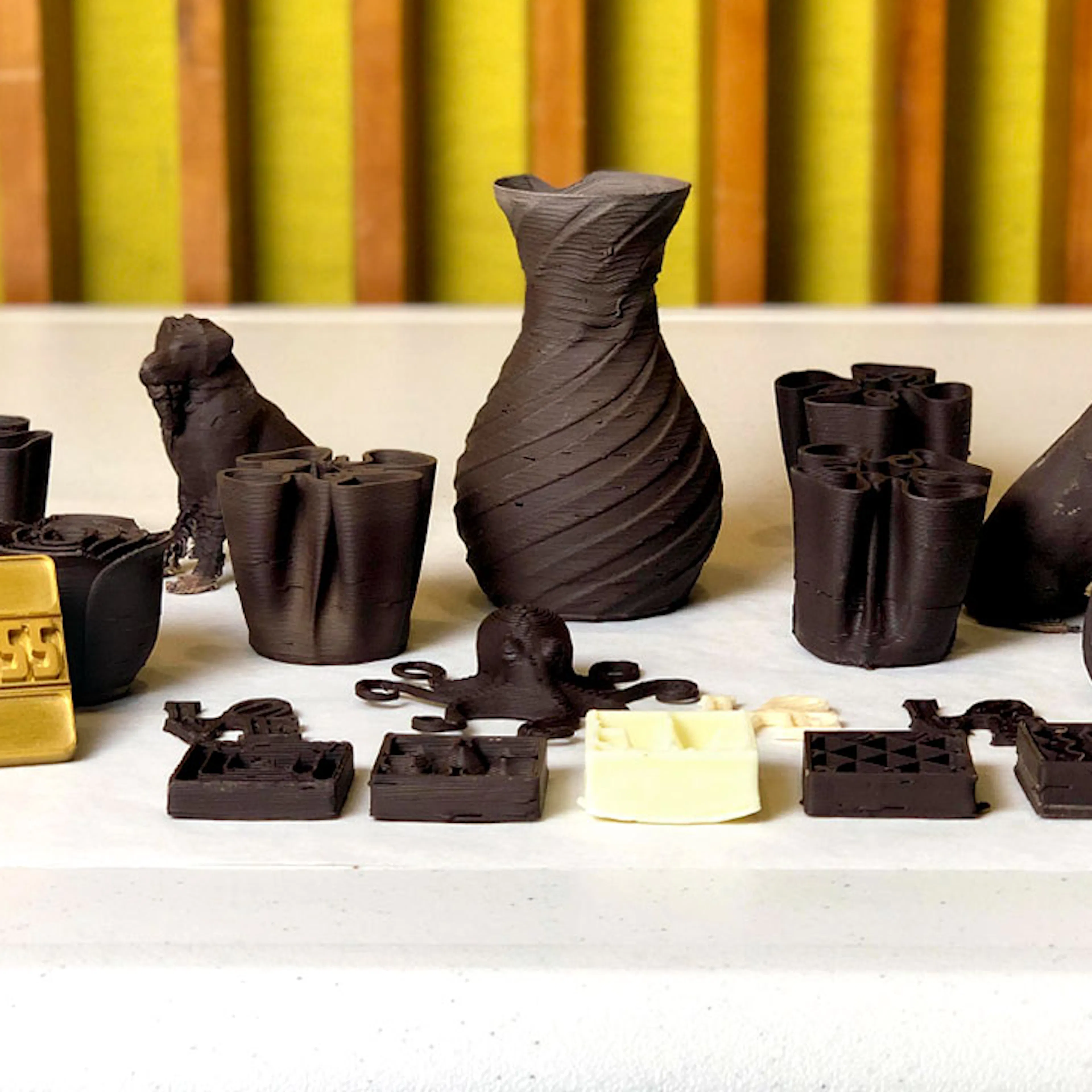

Weinstein gave up the project for the next two years, saying on her blog, “I have to realize that all great projects must come to an end.” However, she never fully gave up her passion project. In her third year, Weinstein applied her new engineering skills by improving the cooling system and the extrusion components. It successfully printed higher layers and accurate shapes. Emboldened, Weinstein brought the second prototype to Maker Faire in New York City. Onlookers were amazed by the custom chocolate creations, which made Weinstein realize the project was worth pursuing further.

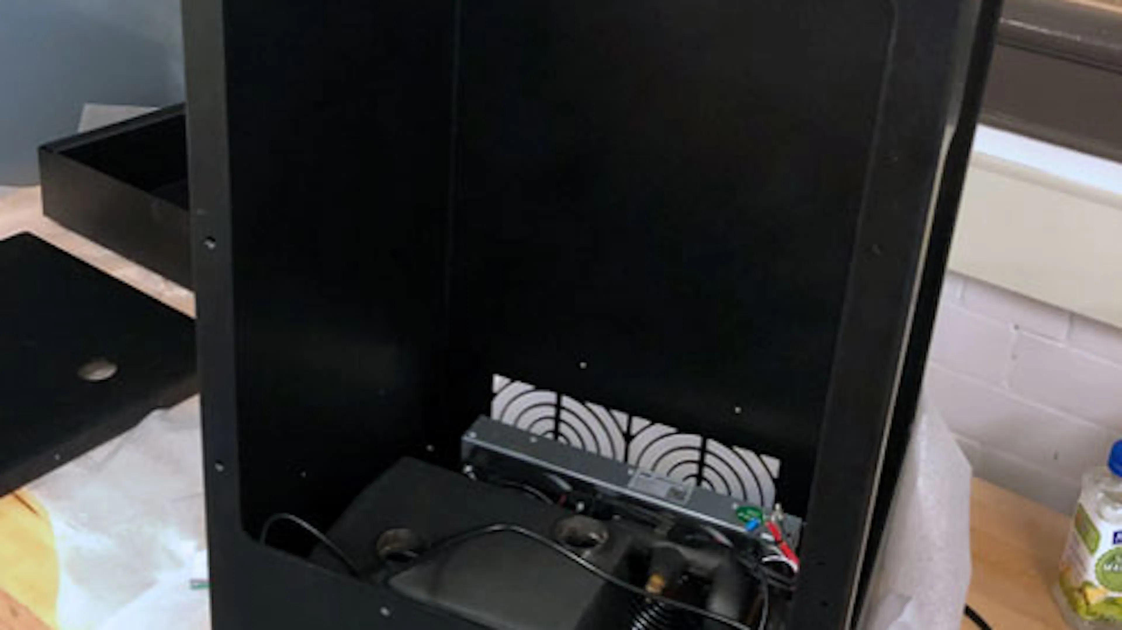

Although the team had the first prototype to reference, the 3D chocolate printer was wholly dismantled and rebuilt from the ground up. All the major systems were redesigned, including motion, cooling, heating, and extrusion. For the frame, they knew they would need an enclosure that eliminated all flexing. With further research, they decided sheet metal would be a cost-effective and highly stable structure.

The team considered manufacturing the sheet metal parts in-house at the University of Pennsylvania’s student workspace, but the school lacked advanced sheet metal equipment. It would have taken the team approximately two weeks to manufacture a part of the same size, and even then it would have lacked the same precision (with much larger tolerances) and anodize coating.
Weinstein's team decided to quote with Xometry and discovered they could receive parts a week sooner than other manufacturers. They also received a call from a Xometry sales representative, who provided design-for-manufacturability feedback. This was instrumental to the success of the order since no one on Weinstein’s team had ever designed for sheet metal.
Cocoa Press Unveiled: The Final Product
Xometry manufactured the 3D chocolate printer frame out of Aluminum 5052 Sheet Metal, a rigid material that provides stability to the machine. In total, the frame measures 21” wide by 15” deep and 20” tall. The were manufactured with precisely positioned inserts that allow a secure assembly and perfect alignment. This precise fit not only ensures stability but eliminates the possibility of food particles getting stuck in crevices. Lastly, a black anodize finish ensures the machine will not corrode and can be easily cleaned.
The completed parts exceeded the team’s expectations in both function and aesthetic. The solid structural base allows the motion system to maintain greater printing consistency. The sheet metal parts have helped reduced the print fail rate from 50-75% to under 10% of the time.

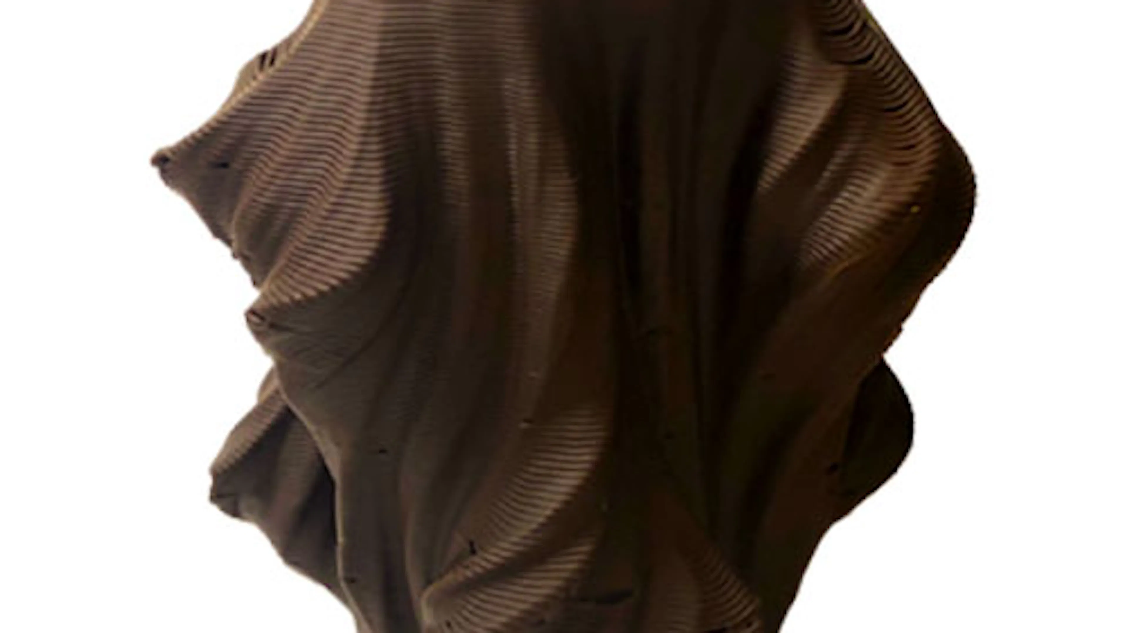

In addition to the new frame, the final product implements design improvements that allow chocolate walls as high as 6 inches, or approximately 200 layers. The insulated cooling system lowers the enclosure’s temperature to 15 degrees Celsius, allowing for 50% faster printing than the previous prototype. The extrusion system is more reliable and is powered by air pressure instead of a motor.
The printer can print in white, milk, and dark chocolate and will be able to handle any brand of chocolate bean bar. Most importantly, all the components are safe for food contact, since the final design ensures the chocolate only touches the syringe and nozzle, then prints directly onto parchment paper. The walls are made of Delrin and polycarbonate, both food-safe plastics, and the electronics are housed separately in the non-refrigerated area.
