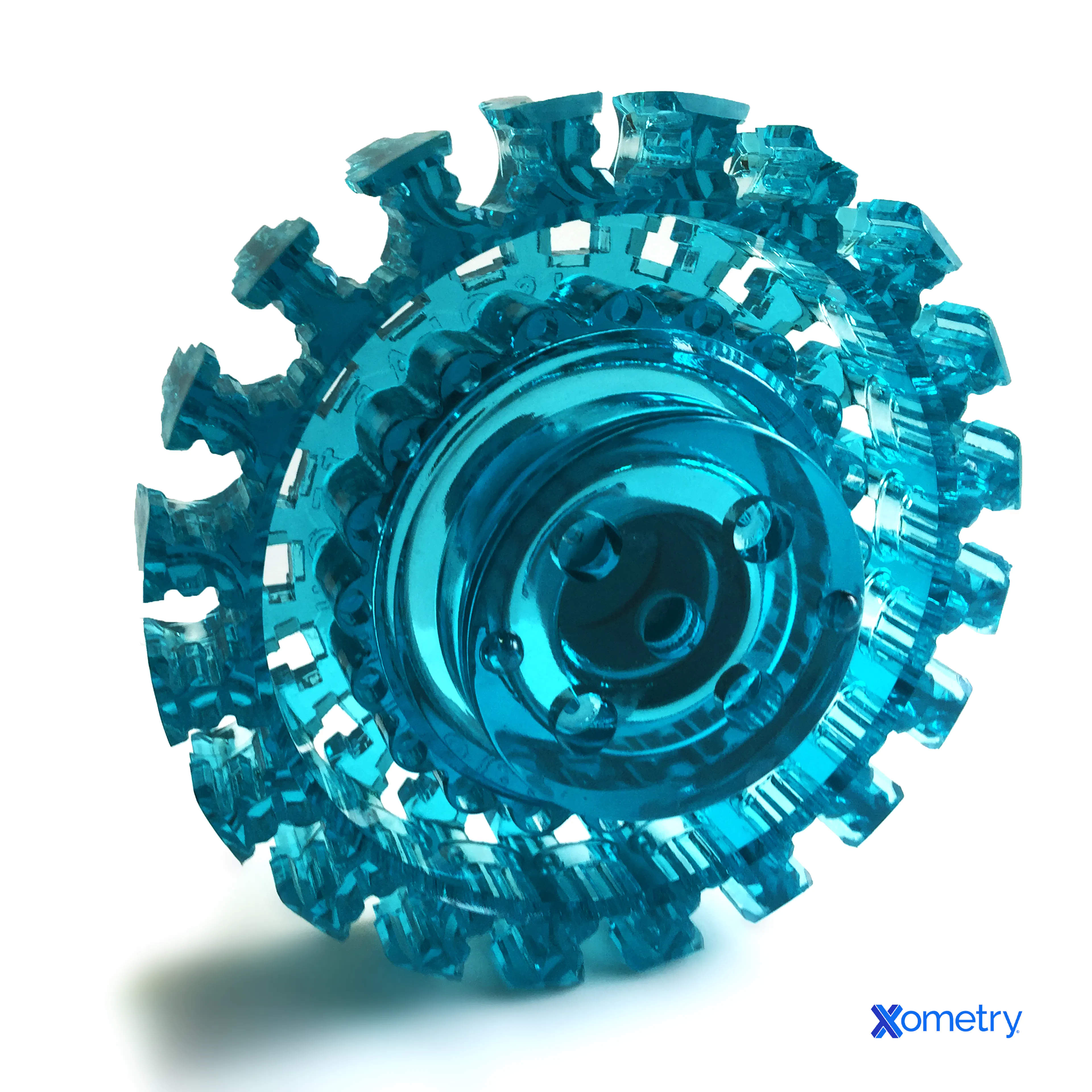

Urethane casting provides end-use, rigid or flexible plastic parts with production-level quality. Built without expensive and time-consuming hard tooling, our urethane casting process uses a 3D printed master pattern and silicone molds to deliver high-quality, short-run parts.

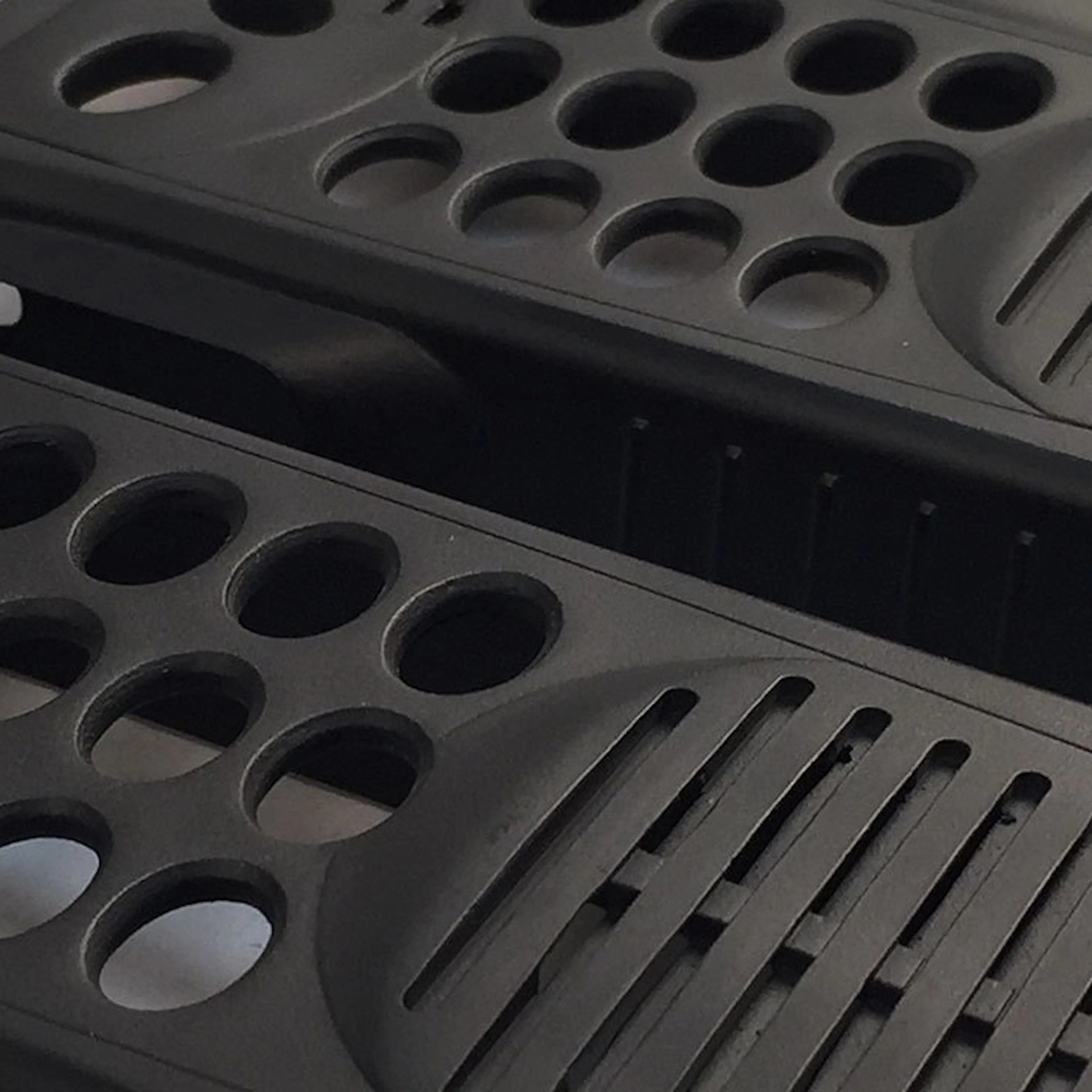

3. Standard vs. custom finishes
Standard urethane cast finishes include matte and sanded. Custom finishes like polished surfaces may increase the price of your part.
Polyurethane part
Polyurethane part
4. Give even wall thickness
The wall thickness of your part should be even throughout so that the urethane can flow into the silicone mold and cure at the same rate. Uniform wall thickness is important in order mitigate potential design issues. Xometry recommends at least 0.020’’ (0.5mm) wall thickness for small parts, and at least 0.040’’(1mm) wall thickness for larger parts. The larger the part, the larger the wall should be to ensure proper support. Also remember that knife edges, or very acute angles, should be blunted by a fillet or chamfer for a repeatable design.
