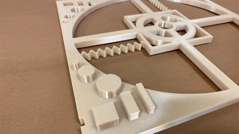

This is not to say that 3D printed parts are wildly unreliable. Before manufacturers even plan your part in a build, they calibrate machines to assure they can produce parts that meet specified CAD dimensions. Standard operating procedures for standardizing and calibrating industrial additive manufacturing machines include scale and offset calibration, where a 3D printing technician will build test parts, measure the results, and input the results into the machine to build preparation software. This software adjusts the scale and the edge offsets of the parts to better fit the CAD to the print.
![Xometry Image](https://images.prismic.io/xometry-marketing/1759c3e5-b860-4980-a133-c477eabf4912_FDM+calibration+part+-+repeatability+white+paper+-+20201118.png?auto=compress%2Cformat&rect=0%2C0%2C792%2C445&w=792&h=445&fit=max)
Fused deposition modeling part used for machine calibration
Another standard 3D printing calibration procedure is to set up thermal controls. This can include heated build chambers, part beds, and sensors. For example, industrial 3D printing platforms like SLS or HP MJF use sensors to automatically track and heat specific zones to help even out thermal imbalances.
A final standard that manufacturers use to regulate 3D printing tolerances is the careful storage and handling of materials. Raw materials are typically stored in a dry, dark place to prevent moisture absorption, exposure to UV light, and oxidation that can degrade their performance and ability to fuse.

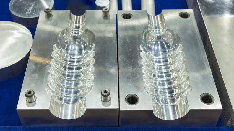

Factors That Can Affect the Tolerances of Injection Molded Parts
When it comes to repeatability, injection molding is a leader. This is because injection molding melts down pelletized material and injects it into a mold (also called a molding tool). The mold ejects the part and then repeats again and again until you have hundreds or thousands of identical parts. This molding tool is typically made of metal and is perfected via multiple iterations of cutting and tuning. Once you have the final tool, it can make parts with extremely high levels of precision of +/- 0.004” or better. This process is so repeatable that even miniscule details, like the grain or pattern on the metal tool, will show in the exact same place each time on the part.
Like 3D printing and CNC machining, various factors can affect the tolerances of injection molding parts.
Factor | Description | Example |
Factor Machine Set-up | Description An injection molding run uses the same tool tuned to specific machine parameters such as the size of the shot of molten plastic going into the mold, the tool clamping force, and the material feed section’s temperature. These are all part of the tool “bio” that all must be specified for that part’s machine parameters and kept the same if the part production ceases and is started again at another time. | Example Both shot size and injection pressure will affect how features resolve in molding parts. For example, low pressure can result in a short shot, meaning not enough material is injected into the mold, resulting in incomplete features. Part of production’s setup is doing a “shot study” to test different parameters until the desired result is achieved and used for the remainder of the run. |
Factor Manual Processes | Description Injection molding can incorporate manual processes like hand loaded inserts or manually trimming runners off of gates. There may be slight deviations on those features from part to part. | Example For most low-volume production runs, the runner requires manual removal. Typically this is done with hand tools. In higher volume production, this can be mitigated by moving to a hot-runner gate that eliminates the need for manual trimming. |
Factor Tool Wear | Description A tool that molds abrasive materials can leave wear on a feature of the tool. This can typically be found around the gate area where the material is injected at very high pressure. | Example Prototype molds made of aluminum are softer and more prone to wear with abrasive materials such as glass-filled nylon. Production molds are made in much harder materials which mitigates this issue. |
Factor Material Condition | Description Material condition, from pellet uniformity to humidity level, can affect how it behaves when melted and injected into the part cavity. | Example Many plastics will naturally absorb moisture in the air. If pelletized material is not dried prior to molding, the molded part will have high humidity. This can cause visible streaks in the part or even affect the overall part fill. Drying the stock material before molding can prevent this variation. |

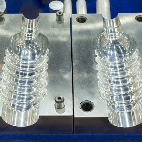

How Manufacturers Achieve Consistent Injection Molding Tolerances
If the tool is newly created, it is validated with production run samples, otherwise known as T1 shots. A tool is approved after it can create 10 good parts from a mold. When the machine is reset for subsequent runs, it is common to hold one of the original samples, using the same tool bio, as a template to check against the new batch. Additionally, since a single injection molding run may thousands of parts, each part of that batch is almost guaranteed to look identical.
![An injection molding tool](https://images.prismic.io/xometry-marketing/896a4fc3-5a13-4f4f-aeaf-3f073237935a_injectionmolding-tool-2020-11-12.jpeg?auto=compress%2Cformat&rect=0%2C19%2C1500%2C843&w=792&h=445&fit=max)
An injection molding tool. This tool is made out of CNC machining, then tested with T1 samples to perfect the part geometry.
Bottom Line: Should You Use Injection Molding to Achieve Repeatable Parts?
Overall, injection molding remains the most repeatable manufacturing process. The upfront communication and cost investment that goes into a mold tool can often be worthwhile if you need an extremely repeatable process for a large set of parts. Most consumer products, from your keyboard to your dashboard are all injection molded, meaning that everything works, fits, and can be easily manufactured at scale.
