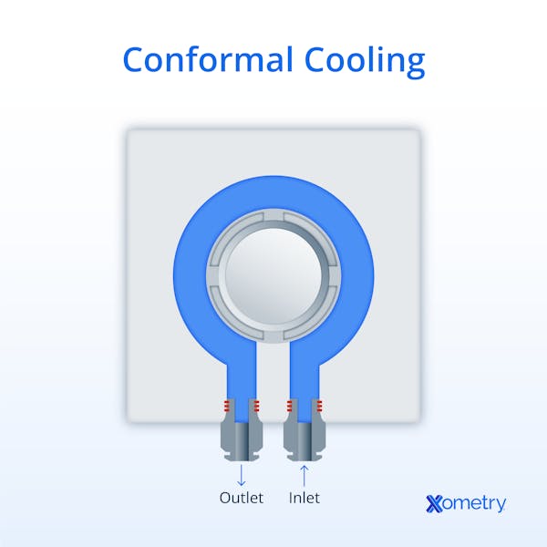

Conformal cooling is a technique that incorporates custom cooling channels into the tools used in plastic injection molding or blow molding processes. The cooling channels can be specifically designed to match part geometries for more effective and uniform cooling. Pairing conformal cooling with injection molding can reduce cycle times by 10 to 40%, and sometimes even up to 70%, compared to conventional cooling methods.
How Does Conformal Cooling Work?
Conformal cooling works by circulating a coolant through channels designed into injection molds for plastic parts. The coolant can be either liquid or gas, depending on the application’s requirements. Liquid conformal cooling is used with plastic injection molding materials that cannot withstand high temperatures or that require fast cycle times. Gas conformal cooling, on the other hand, is used for less demanding applications where the material being molded has higher temperature resistance and/or longer cycle times are used (i.e., polycarbonate). While water is used as a coolant for most applications, oil is used when the mold should be chilled at temperatures close to or above the boiling point of water. If the mold needs to be cooled at low temperatures (below the freezing temperature of water), a mixture of ethylene glycol and water is typically used. For gas coolants, air can be used, but this is not as efficient as the other coolant options (e.g., water).
