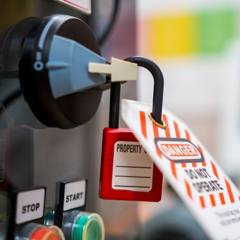

They also operate the control panel, provide manual feeding of material, as well as service and maintain the machine using lockout/tagout procedures and additional measures— all of which can expose them to risks.

  1. Before even touching the machine, all operators must be adequately trained in machine operation, workspace management, and proper lockout/tag-out protocol.
