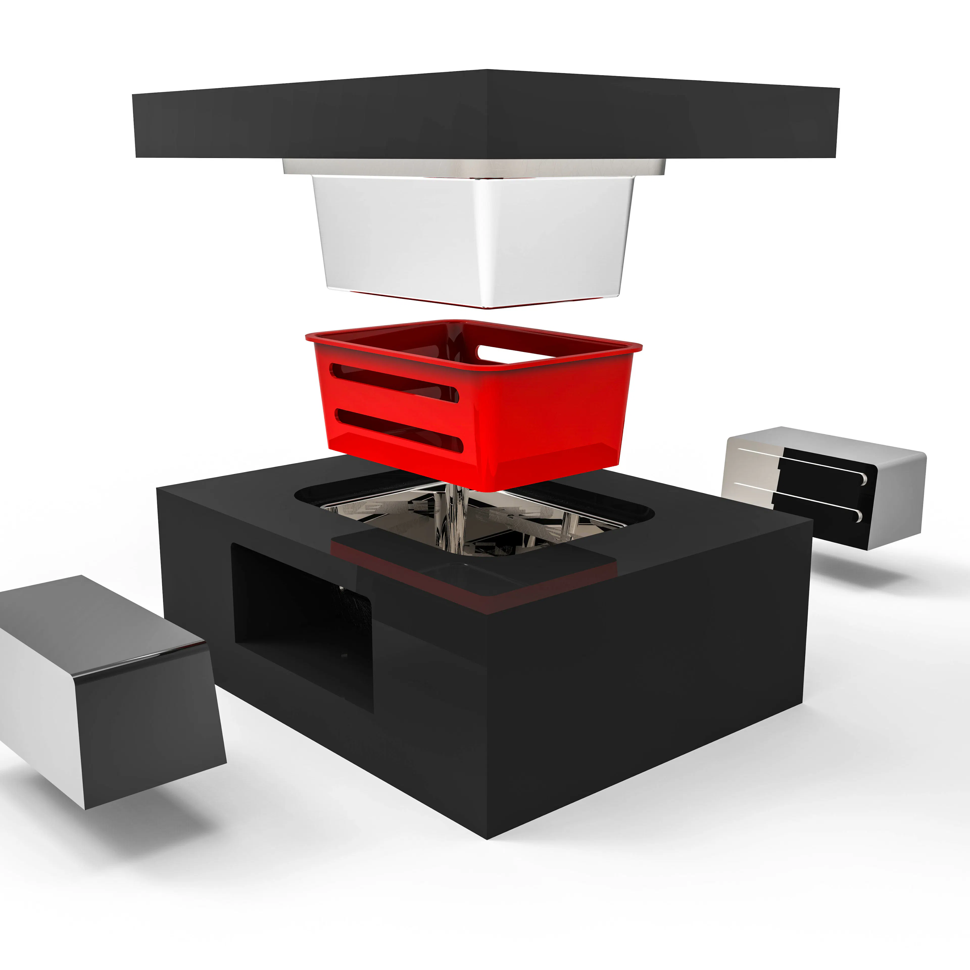

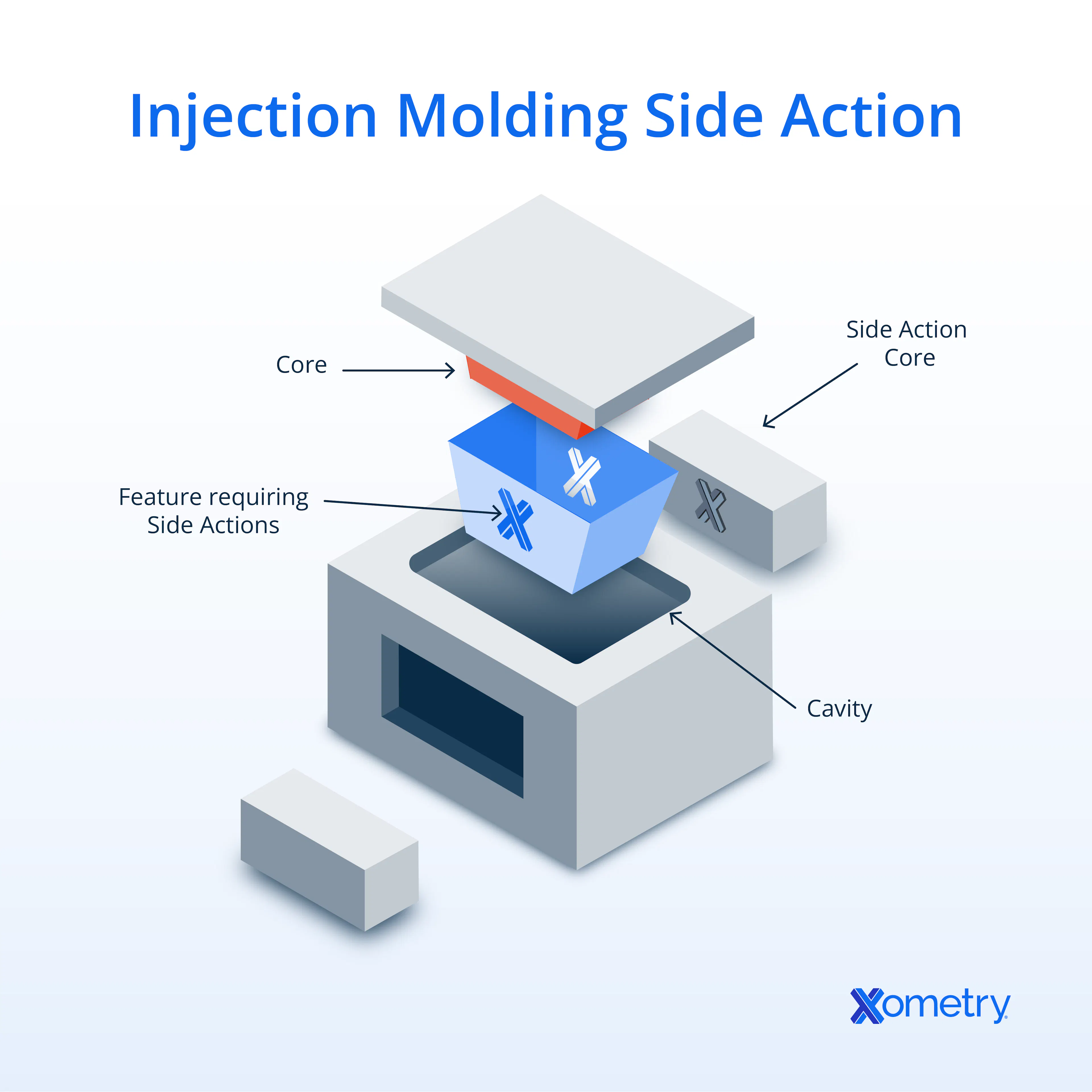

Injection molding side actions are inserts (sometimes referred to as “features”) added to the mold in order to create undercut geometry. Undercut features are perpendicular to the main parting line and cannot be produced with a straight-pull mold, or in other words, by pulling apart the two halves of the mold and ejecting the part. When side actions are added to the mold, they allow material to flow around them to form the undercut feature. The side actions must then be removed manually or automatically to allow part ejection.
Side actions are beneficial because they increase the options for what part geometries your part can have. However, side actions can dramatically increase molding production costs, so it is helpful to consider whether you need them or whether you can avoid them by designing slot features.

It should also be noted that because side actions do not follow the general tool direction, undercut features require draft angles specific to the action’s movement. For more design strategies, download our Injection Molding Design Guide.
