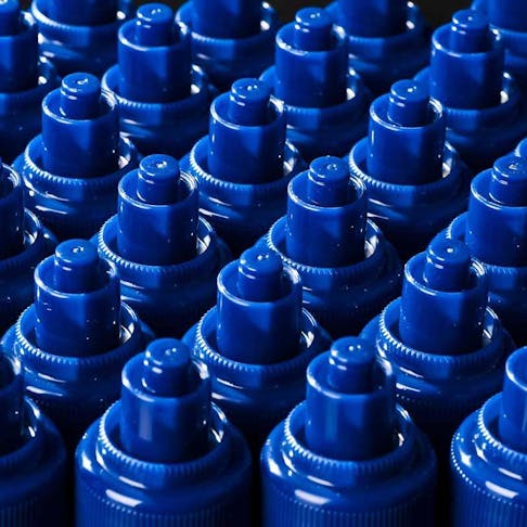

Injection molding is a manufacturing process used for the mass production of identical plastic parts. It’s a method of plastic injection where molten plastic is inserted into a mold to produce a part in the shape of the mold cavity, creating a physical representation of modeled plastic parts. Plastic injection molding has been around since the late 19th century and continues to be popular. If you look around, injection molded parts are everywhere, from the keys on your keyboard to the dashboard of your car to your X-Wing LEGO set.
The plastic injection molding process is commonly used when large amounts of parts are needed quickly, when piece prices need to remain low, and when all parts need to be identical in size and other metrics. The main benefit of this process is its cost effectiveness; sometimes it costs just cents per part for parts at scale. “At scale” typically refers to volumes ranging from thousands to hundreds of thousands of parts. However, it also is one of the most repeatable manufacturing processes, and it also has the highest variety of materials, colors, and cosmetics when compared to CNC machining or even 3D printing.
