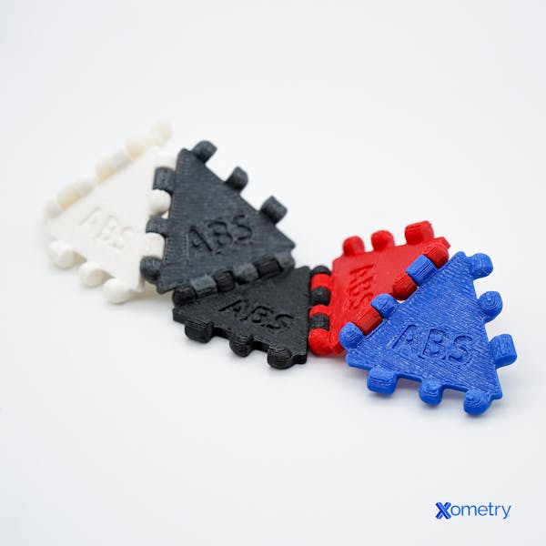

ABS Plastic
ABS (acrylonitrile butadiene styrene) is a high-strength general-purpose engineering plastic used for many commercial products. ABS is durable and lightweight. It is a terpolymer created by polymerizing styrene and acrylonitrile in the presence of polybutadiene. The proportions can differ from 15% to 35% acrylonitrile, 5% to 30% butadiene and 40% to 60% styrene.
ABS resin is an opaque thermoplastic polymer and an engineering-grade plastic. There are many advantages to using ABS. It’s tough, has good dimensional stability, resists impacts and scratching, and is hard to break. ABS is a good insulator and doesn’t conduct electricity or give off fumes if exposed to fire. These are essential considerations for product developers working on electrical devices.
ABS is used to make products such as electronics, phone adaptors, keyboards, phone hardware, wall socket plastic guards, LEGO bricks, drainpipe systems, and kitchen appliances.
Molding Temperature of ABS Plastic
ABS has a low melting or molding temperature, making it ideal for injection molding. The process temperature is approximately 40-80 °C, preferably as high within that range as possible. Using a higher mold temperature tends to lengthen the molding cycle time, so the mold temperature setting depends on what is most appropriate for the individual product that is to be molded.
