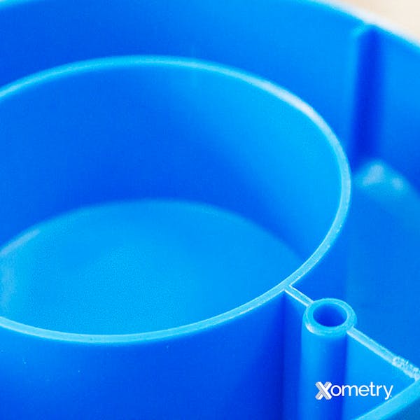

An example of plastic ribs in an blue injection molding part

Ribs are thin features in plastic injection-molded parts that run perpendicular to walls or planes. They are common features for many reasons such as those listed below:
  1. Prevent Warpage - Thick part walls will affect the cooling rate of injected plastic. The material that is in contact with the mold’s surfaces will cool quickest while that in the middle takes longer. This uneven cooling causes internal stresses in the material which, in turn, cause the final part to warp. To combat this, part walls are made relatively thin. However, those thin features are structurally weak so they need to be reinforced with ribs.
  2. Support Other Features - Ribs are also used to support isolated features like bosses used as fastening points. These bosses need structural support, so they are connected to the side walls with ribs. If they are too far from side walls, isolated ribs are used to reinforce them.
  3. Reduce Material Use - Strategically placed injection-molded ribs can improve the part’s stiffness in critical areas. The stiffness can thus meet your requirements while everything else remains thin and lightweight.
  4. Improve Mold Flow - Injection-molded ribs can be strategically placed to pull double duty. If they’re properly designed for manufacturing, they improve the molten plastic’s flow into the mold in addition to strengthening the end product.
