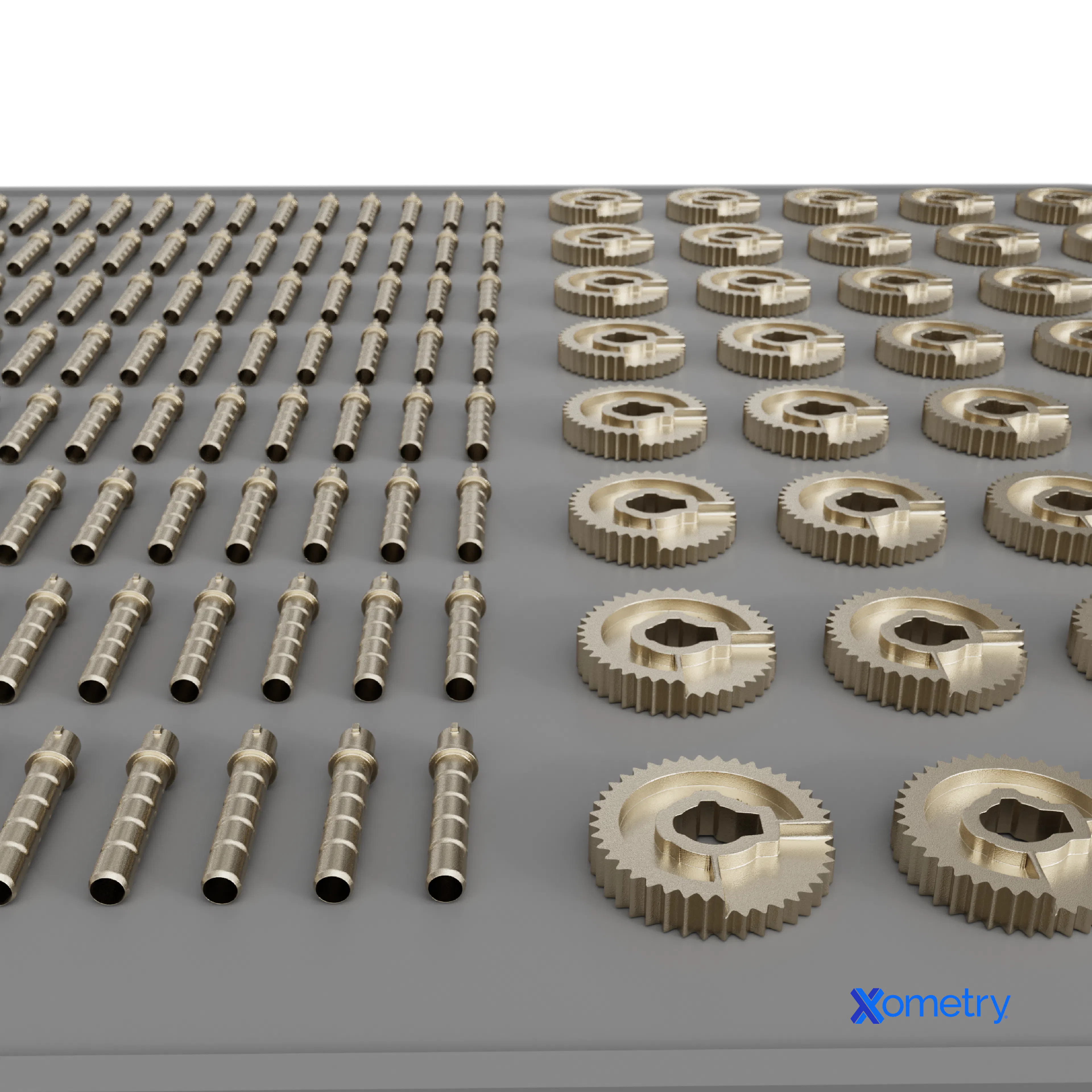

1. CNC Milling and Turning
There are two main types of CNC machining technologies. CNC mills are automated cutting machines. They cut away unwanted material with a rotating spindle head. Turning spins material against a stationary tool to remove material into the desired shape. They work well with a range of materials, including plastic, aluminum, stainless steel, and titanium.
How CNC Machining and Turning Works
CNC turning involves the use of either CNC lathes or multi-axis CNC turning centers. Manufacturers use CNC lathes to turn materials for cylindrical and concentric features on parts. Live tooling lathes incorporate end mill cutting tools and drills to produce off-axis features without the need to change platforms. Specialized CNC-lathes, often called Swiss machines, are designed to produce small parts with complex features quickly by combining multiple tools and spindles within the machine.
A typical lathe will rotate the part on a central axis to remove features by engaging rigid cutting tools. Other features performed by a lathe include the creation of internal and external threads, creating flanged features, O-ring grooves, and knurled textures.
CNC lathes and CNC mills have different axis configurations. CNC lathes are typically 3- or 4-axis machines with a single spindle. 3-axis CNC machining works materials on X, Y, and Z axes, removing shavings along these three directions. 4-axis tools incorporate movements outside of concentric features on lathes and a tilt on mills. Lathes are ideal for circular parts and are more operationally intensive for irregular shapes and sharp edges, the reverse for mills.
More modern CNC technologies support up to 5 axes. These tools add tilt and rotation to traditional X, Y, and Z axes, enabling precise cutting for more detailed parts. 5-axis machining is also more efficient as it can create more part features in a single operation. Mills are available in several configurations, often employing 3-, 4-, and 5-axes.
CNC stands for Computer Numeric Controlled, and operators control CNC mills and lathes with G-Code—a programming language that provides machine-movement instructions. Modern programming instructions are created through computer-aided manufacturing (CAM) software. This code instructs the machine where to move the tool head. It also controls its speed and feeds, which are rotation, cut depth, and workpiece movement. The G-Code complexity depends on the machine’s number of axes and the toolsets used.

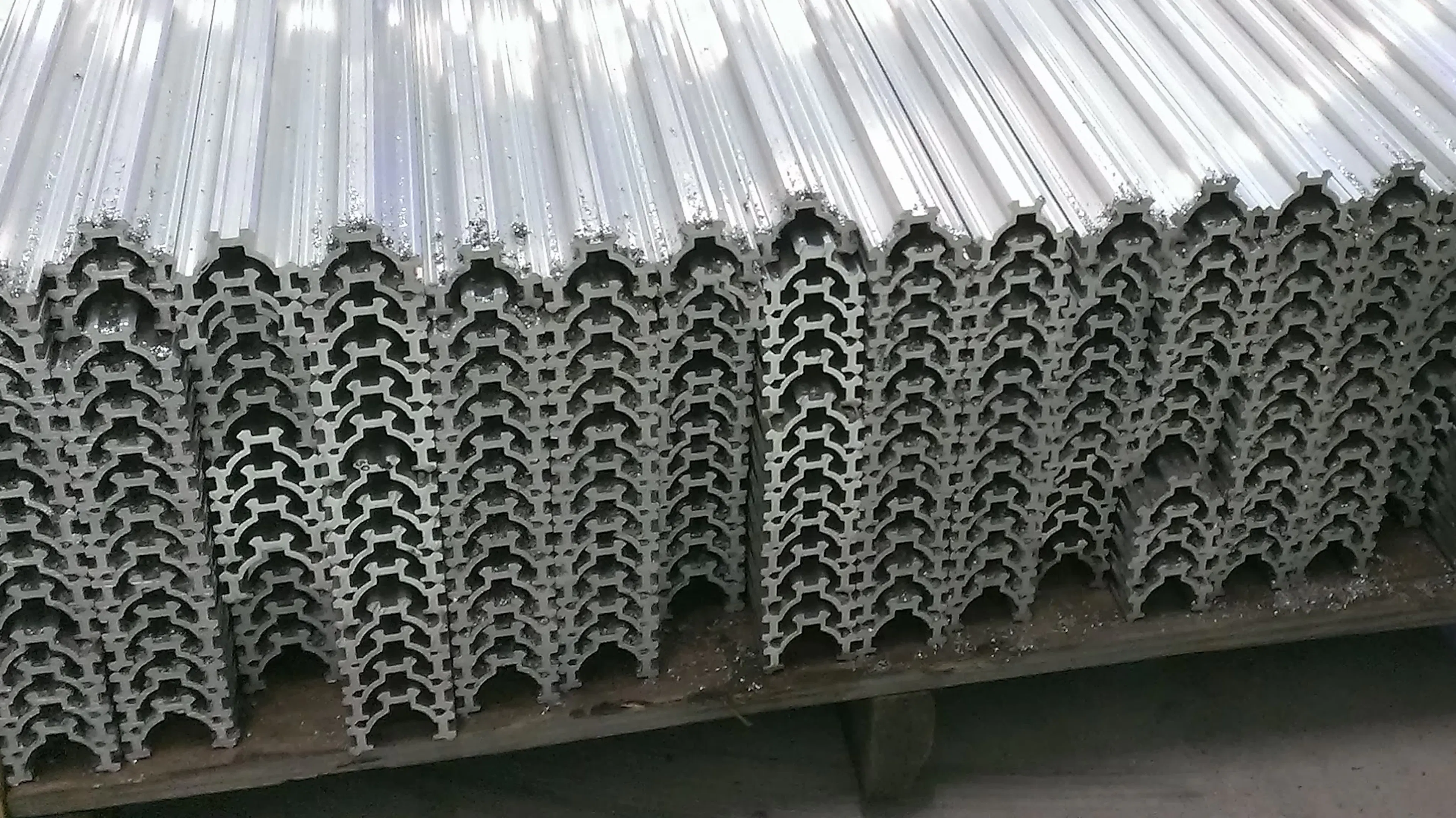

2. Extrusion
Extrusion involves pushing heated metal or plastic through a die. In practice, it resembles squeezing a tube of toothpaste. The die creates a net shape, such as a tube, L-structure, or more complex features. Metal part extrusion typically requires post finishing, such as cutting, drilling, or machining. It’s ideal for high volumes of parts that require constant cross-sections.
That’s because extrusion profiles can be almost any shape with a continuous cross-section. A great example is framing for windows, with multiple features to secure different panes in the assembly. They can even be hollow, such as square, round, or hexagonal tubing. Manufacturers determine its form when creating the shape of the die.
How Extrusion Works
The three types of extrusion are hot extrusion, cold extrusion, and friction. Hot extrusion involves high temperatures to keep work material from hardening. Cold extrusion involves near room temperatures, which provides some advantages over hot extrusion. The material may be stronger, have less oxidation, or have closer tolerances. Finally, friction extrusion involves the use of force to push the charge against the die.
Extrusion Materials
Extrusion materials can be either plastics or metals. Roughly 80% of extruded metal parts are aluminum alloy. Meanwhile, polyethylene is most common in plastic extrusions.

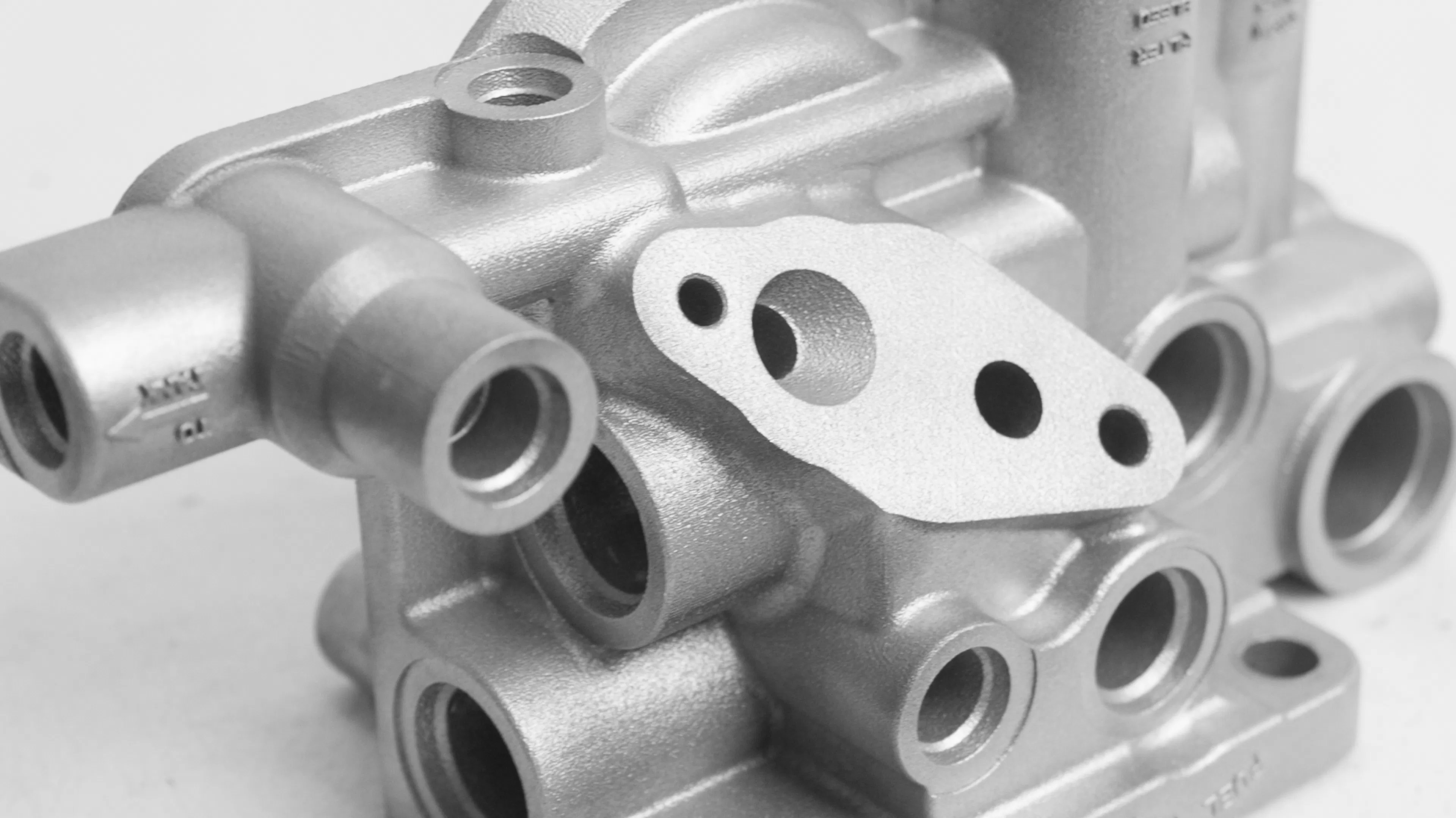

3. Metal Casting
Metal casting is a long-standing manufacturing process. It involves pouring liquid metal into a mold. The liquid metal hardens in the form of the desired shape. It is then cooled and extracted from the mold.
Modern metal casting is precise, automated, and uses advanced tools. But its principles remain the same. Its wide use is a testament to the success of this method.
How It Works
The metal casting process begins with patternmaking. Patterns create part-shaped voids in the mold prior to pouring in the liquid metal. Modern patternmaking methods use precise calculations to achieve the desired shape. This can include scaling to account for shrinkage as well as having an excess material thickness in preparation for post CNC finishing.
In many cases, the mold is destroyed during the casting process. This is a planned step when sand casting, where a cast formed from sand is broken apart to reveal the finished part. New sand casting molds are easy to make, and sand is often reclaimed to create new molds.
Metal casting may also involve the use of wax in a process called investment casting. Manufacturers start by building a wax model of the final product. The wax is covered in layers of ceramic before the wax is heated and removed. The ceramic shapes the mold, its interior imprinted with a pattern shaped by the wax.
Each of these two techniques has benefits. Sand casting is a simpler process, for example, and easy to repeat. Investment casting requires more preparation but may perform better when creating intricate parts. Sand casting is often more costly; investment casting requires more labor to change a given design. Manufacturers must determine the best process given their budget and labor limitations, and the qualities they want for their parts.

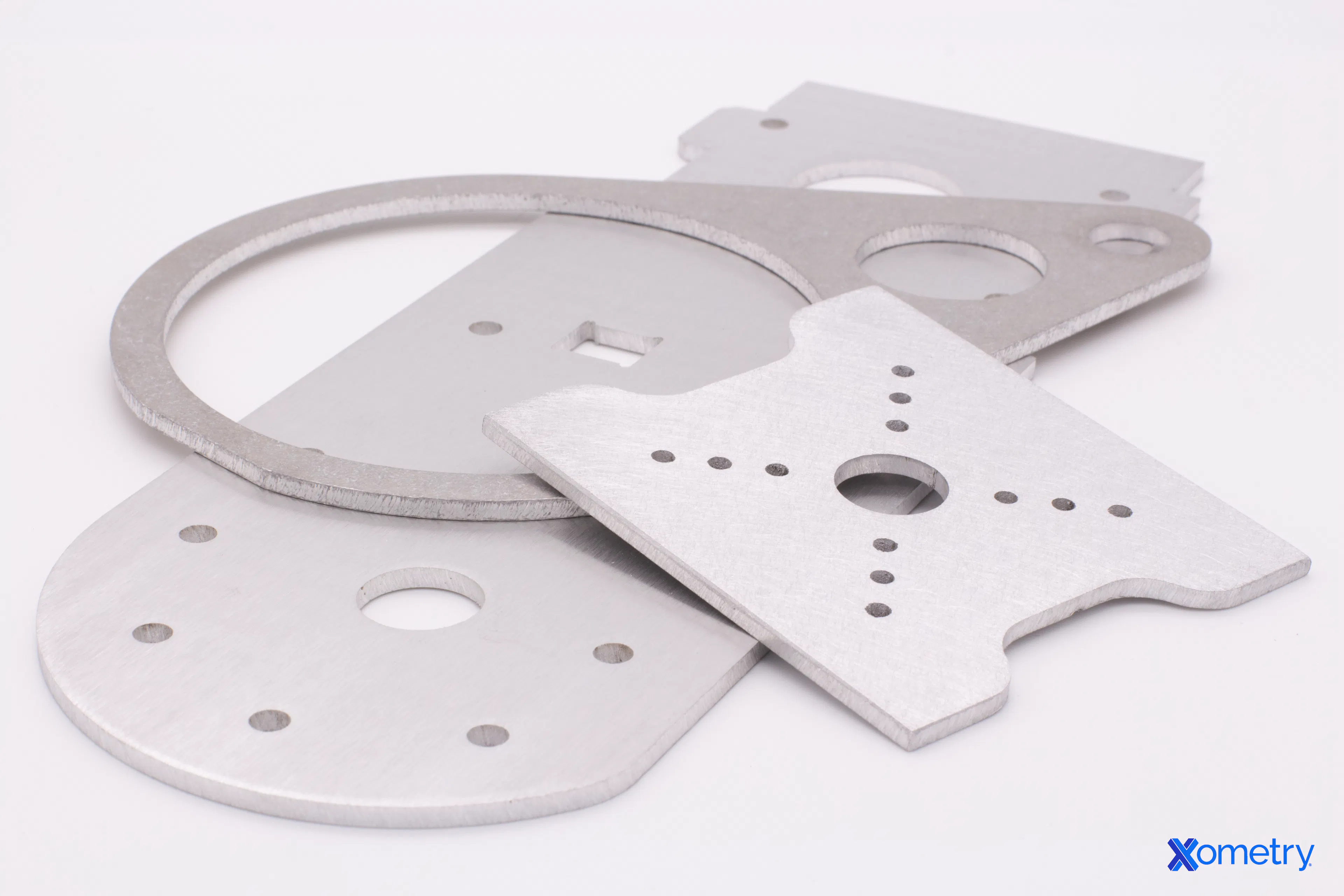

7. Sheet Metal and Stamping
Sheet metal fabrication involves cutting parts from metal sheets. The blanked sheets may then be processed through brakes and die presses to create angular bends and forms, building a 3-dimensional structure. Sheet metal services feature stamping to produce these parts at rapid paces. In fact, stamping is faster than any other metal-working process.
How It Works
Stamping machines cut and bend parts out of sheet metal. Workers feed stamping presses a cut or coil of sheet metal. The machine straightens the metal as it is fed into the press. Strategic application of force allows manufacturers to adapt the shape of parts. Bending applies force at an angle, for example, creating a desired angle in the part. Manufacturers use press brakes for this process, which are available in different sizes and lengths to accommodate the needs of the manufacturer. Sheet metal parts can be welded or riveted to create structural elements. Press-fit inserts, such as PEM inserts, can add mating features like bosses, threads, and more without the need of custom machining.
Sheet Metal Materials
Sheet metal is often made of aluminum, copper, or steel. Sheet metal also has a wide variety of finishes. This includes anodizing, plating, powder coating, and painting.

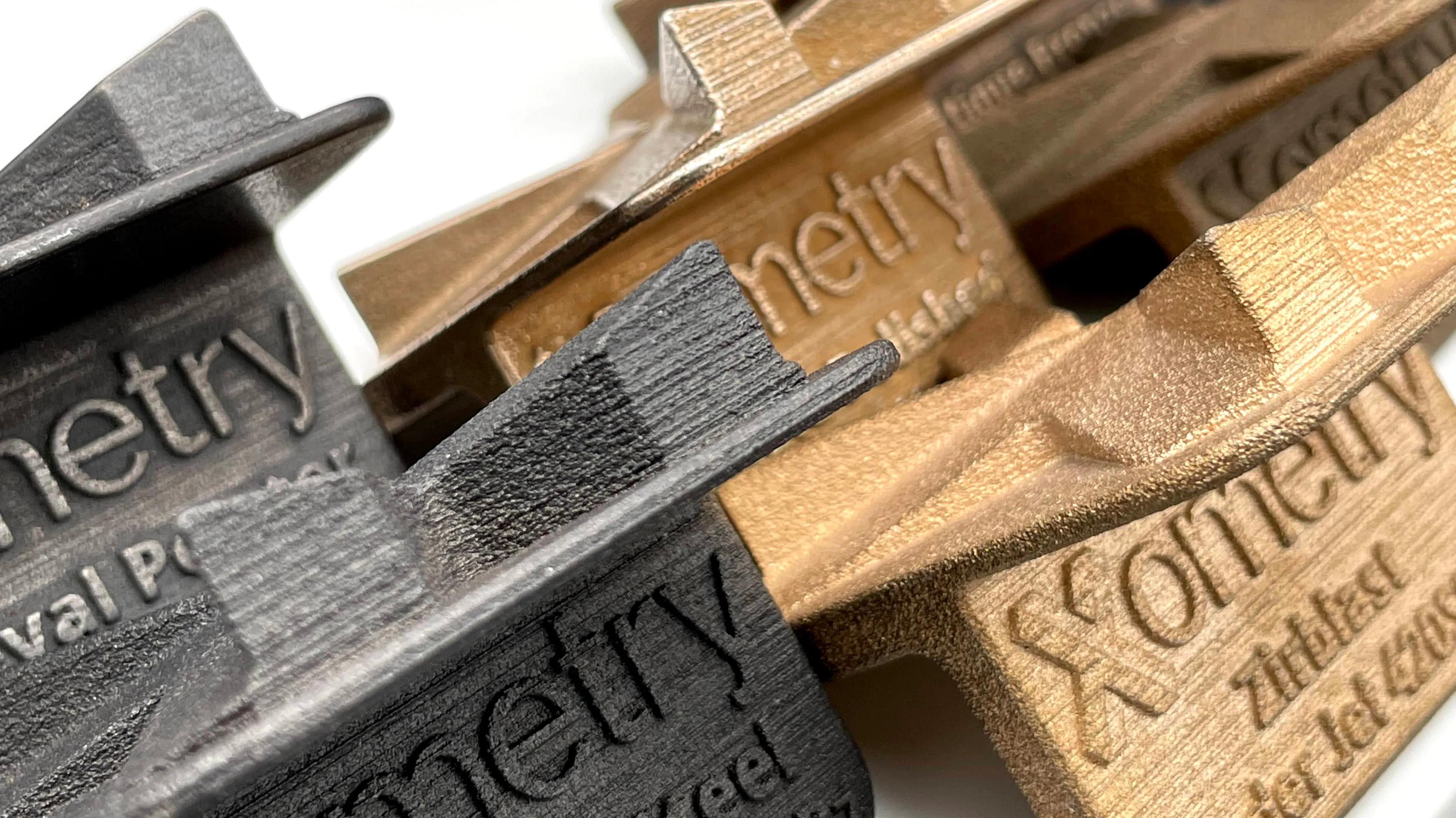

8. Metal 3D Printing
Metal 3D printing services use precise lasers to create metal parts. It is ideal for experimentation and low-volume, high-value parts, but is not as scalable as many of the other metal processes listed. That’s why it is often used for prototypes, as well as substitutes for low-volume casting.
How It Works
3D printing, also known as additive manufacturing, fuses metal in a controlled environment via an energy source. With direct metal laser sintering (DMLS), metal powder is fused layer-by-layer using a laser in an inert environment. Metal binder jetting 3D prints metal parts in a 2-stage process, using an inkjet to bond metal together to a green stage before a secondary furnace process solidifies the metal. Binder jetting can make a metal composite, such as bronze and steel, or a single-alloy, depending on the needs. Metal 3D printing is unique in that it can produce all-in-one assemblies and geometries with inaccessible areas using standard tooling. An example of inaccessible features with traditional processes is building lattice-like structures on a part. This is not possible with traditional molding or casting techniques. Techniques that come close would nonetheless require more time and complexity to produce a single unit.
Metal 3D Printing Materials
The typical stock material for metal 3D printing is atomized powder, but can sometimes be sheet or wire-fed. The printer follows a data path created using a 3D CAD file of the part. Common metal materials include powder in stainless steel, titanium, Inconel, copper, or aluminum materials.
Materials used in metal 3D printers often come from powder metallurgy. Adoption of new materials for metal 3D printers requires significant research to build a robust, and repeatable method of building parts without failure or defects. This means the material choices currently available for metal 3D printing are narrow compared to machining, metal casting, and other fabrication methods.
