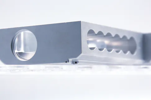

Bead blasting is a type of abrasive blasting process in which media is projected onto a surface. The process is often performed using abrasive blast cabinets, which typically use compressed air to accelerate the media. They also provide an enclosed space for the operator to work up close with parts and help avoid spreading dust or contaminants into the air. Round glass beads are widely used for bead blasting and Xometry's media of choice for the process.

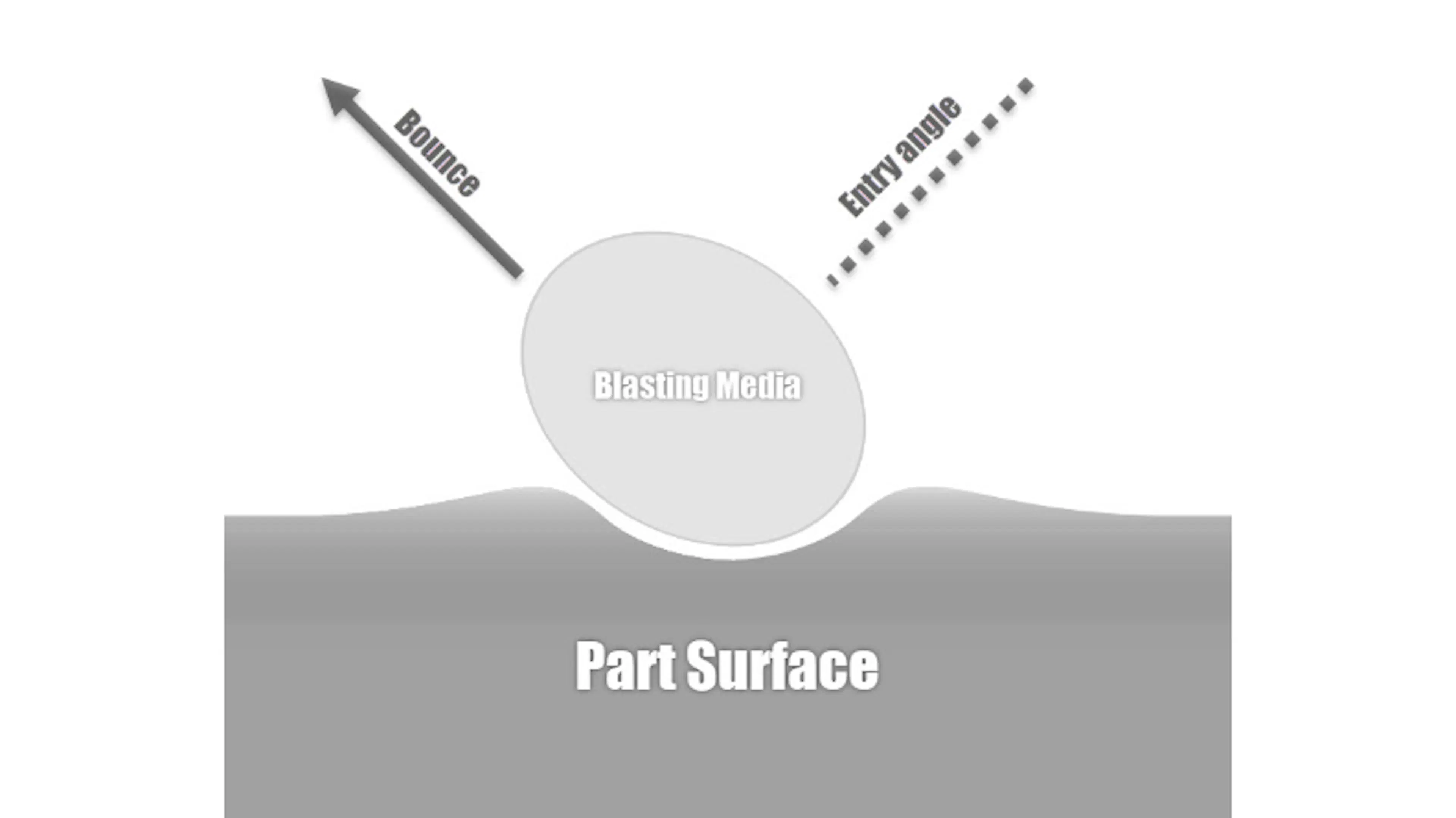

Unlike other types of media blasting, which typically use angular-shaped media, bead blasting is associated with the use of spherical-shaped media. When a piece of rounded media impacts a part's surface, it produces a tiny dimple at the impact location. As the process continues, thousands of these dimples consistently form over the surface. When using finer grades, the blasted surface will appear bright with a matte or satin-like texture due to how light reflects off the dimpled surface. Coarser beads can be used to produce a rougher but uniform surface.
Diagram of a surface dimple created during the bead blasting process

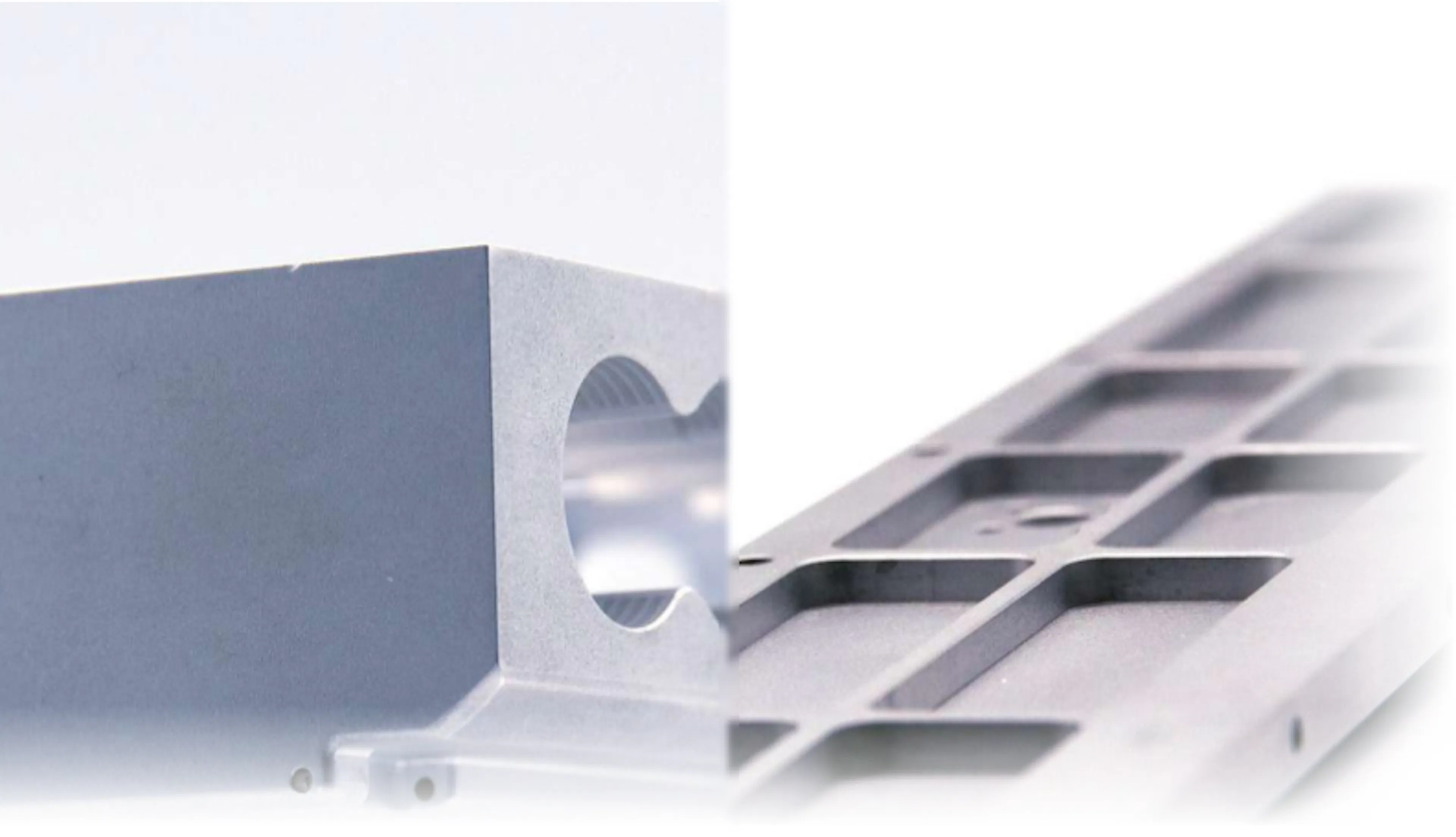

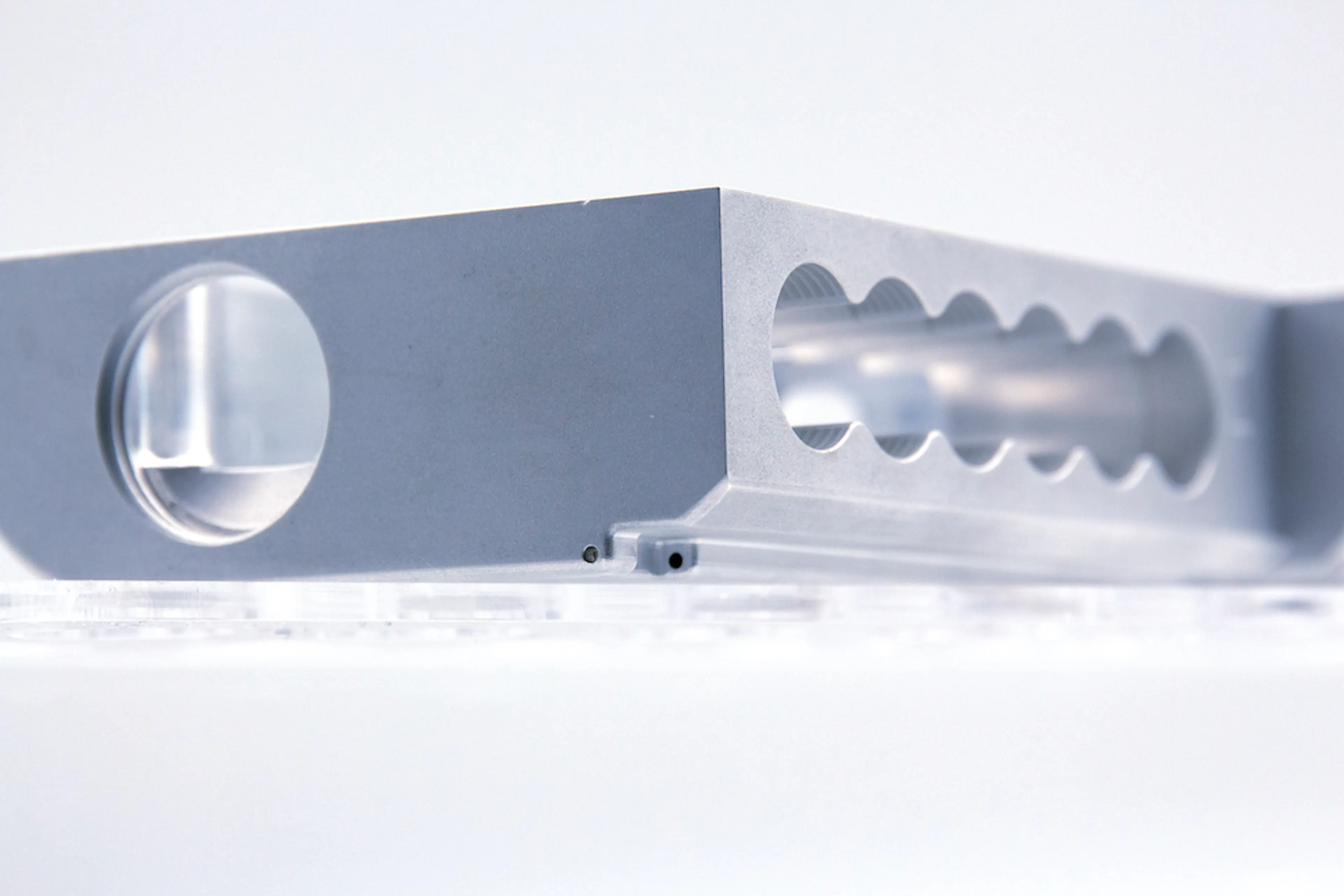

Glass Bead
Glass beads are one of the most commonly used media types for the bead blasting process. They are usually made from a type of lead-free, soda-lime glass which is environmentally friendly as it does not contain free silica and is chemically inert. When used appropriately, glass bead media is quite durable and can often be re-used up to 30 times. This type of media will not colorize the surface on impact and thus help maintain the material's base color.
While versatile for many applications, glass bead may not be as suitable for extremely tough materials and is ineffective at etching the surface for paint preparation. This type of media is ideal for surface cleaning, semi-polishing, or peening applications.

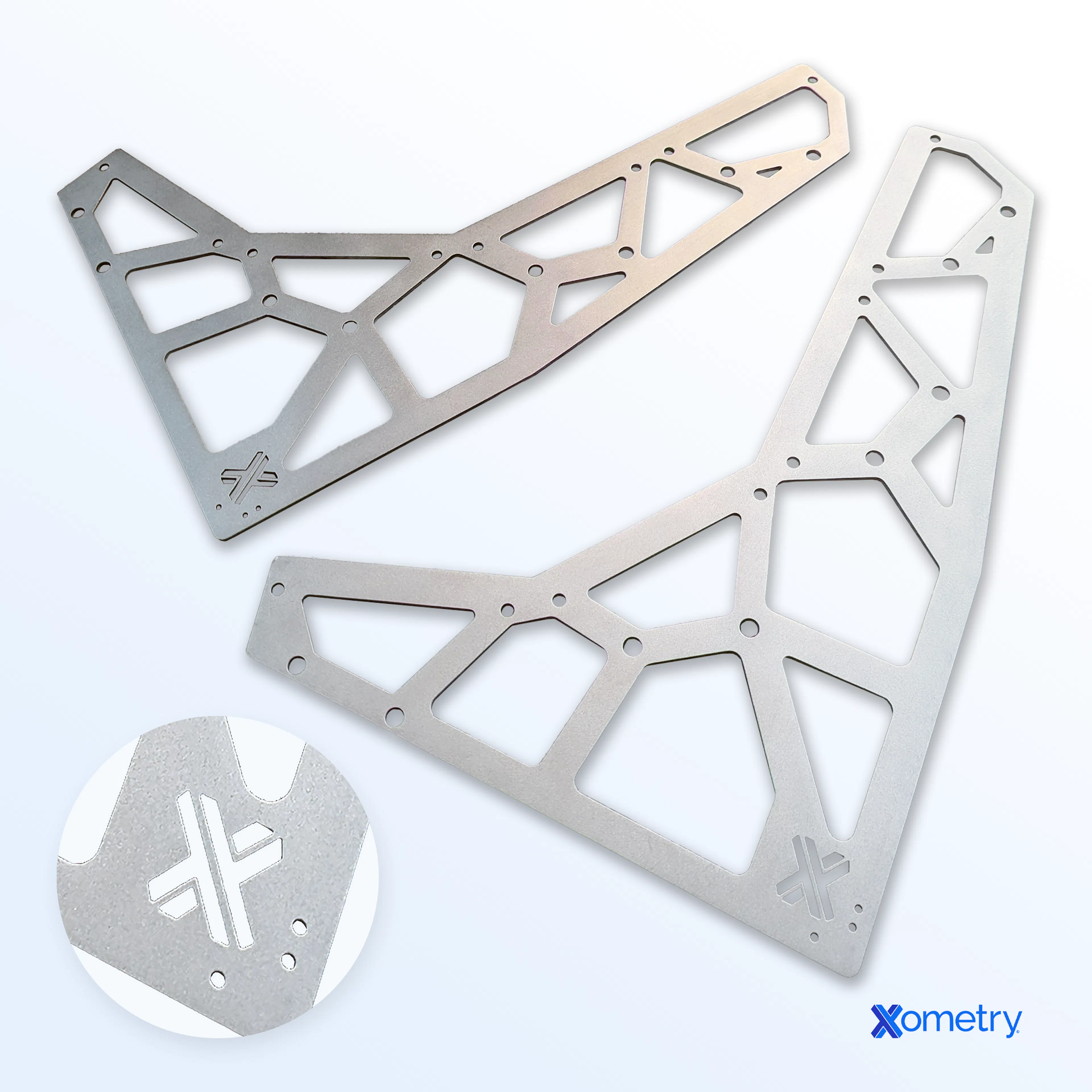

Laser cut aluminum parts made by Xometry with a glass bead blasted finish.
