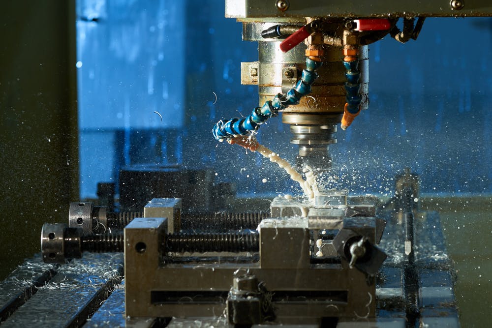

What Is a CNC Mill?
A CNC (Computer Numerical Control) mill is a type of machining tool that uses computerized controls to operate and manipulate a rotating cylindrical cutter. It removes material from a workpiece to create parts with precise dimensions and shapes. CNC mills can work on various materials and are essential in industries requiring high precision, such as aerospace and electronics. Figure 1 is an example of a CNC mill:
Slide 1 of 1
CNC mill
CNC mill
CNC mill
A CNC mill.
Image Credit: Shutterstock.com/al7
How Does a CNC Mill Work?
A CNC mill removes material from a workpiece using a spinning cutting tool. The machine moves the tool along several axes to shape the material into the required shape according to a computer program, commonly in G-code. This technology makes it possible to manufacture parts for a variety of industries with high accuracy and complex geometries. CNC mills can produce complex and detailed parts because they can work on several axes, usually three to five. CNC routers excel with softer materials and offer expansive work areas ideal for large sheets. Conversely, CNC mills are tailored for hard materials like steel and titanium, featuring smaller workspaces that accommodate compact, hard material blocks.
What Is the Purpose of a CNC Mill?
The purpose of a CNC mill is to remove material from a workpiece to create accurate and complex parts. It is essential in industries that demand high accuracy, such as aerospace and electronics, where it is used to machine a variety of materials into final components.
What Is the Importance of a CNC Mill?
CNC mills are essential to modern production because of their great precision and reproducibility in producing complicated parts. They are essential for sectors like aerospace and medical device manufacturing that have high standards. The precision of CNC mills leads to improved efficiency, reduced waste, and the ability to fabricate intricate designs that would be impossible with manual machining.
What Types of Materials Can a CNC Mill Work With?
CNC mills can work with a broad range of materials, including metals like aluminum, brass, steel, and titanium, as well as plastics such as acetal (POM), acrylics (PMMA), polycarbonate (PC), and polypropylene (PP). They are also capable of machining wood and various foams. The choice of material depends on the specific requirements of the project, including: strength, weight, and resistance to the conditions of the service environment.
