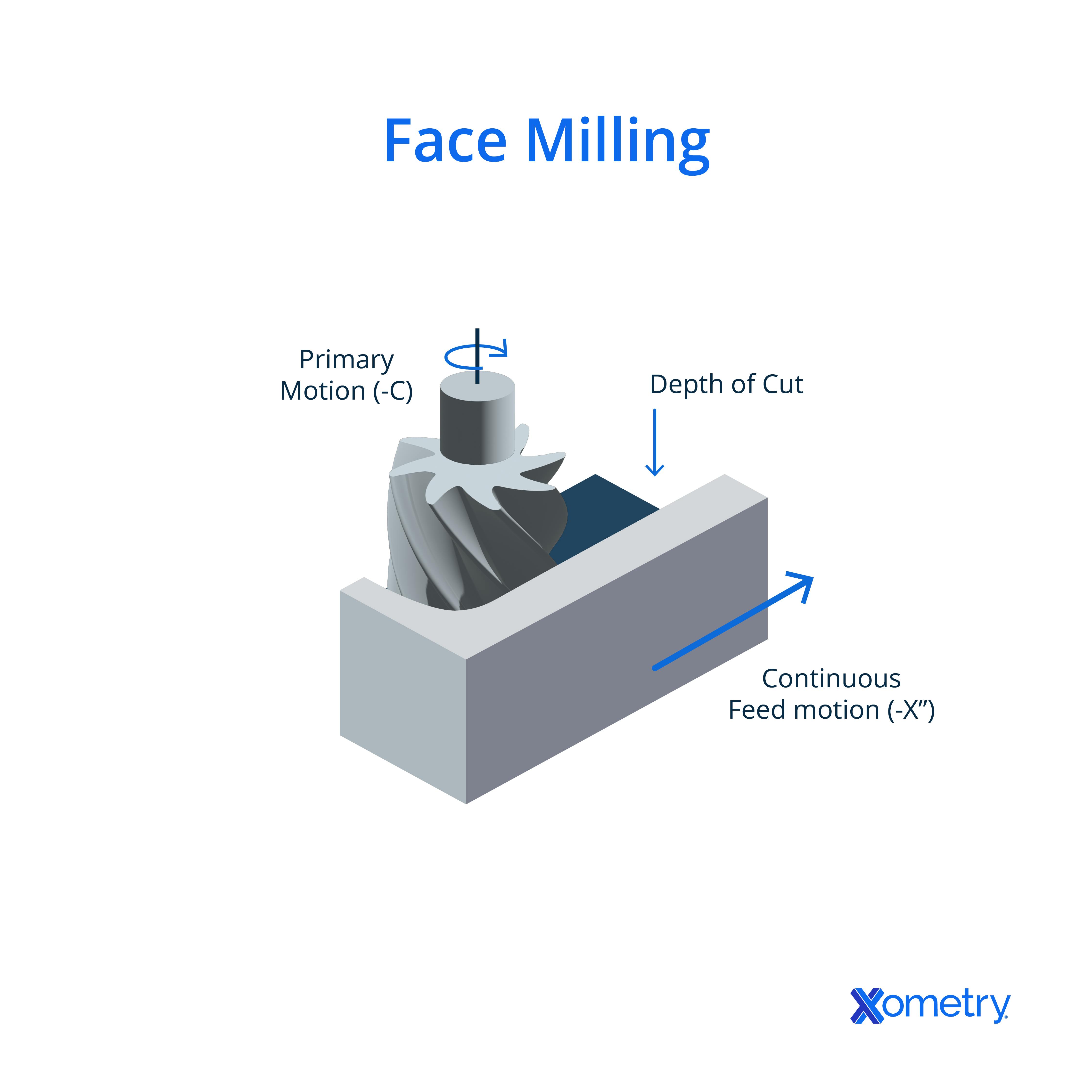

What is Face Milling?
Face milling is used to create high-quality flat surfaces with either a fly cutter, end mill, or shell mill. These cutting tools typically have different head inserts so you can swap them out as necessary, kind of like you would with a regular drill/driver. The material you want to cut should be placed face-up on the machine, perpendicular to the cutter’s axis. After you’ve adjusted all the important settings, like the spindle speed and feed rate, secure the material in place so that you can start cutting. The below diagram depicts the face-milling process.
face milling diagram
Face milling diagram
Some of our customers manage to make their cuts using this process in a single pass, but don’t worry if you need more than one (it happens to the best of us). Face milling does a great job of removing a lot of material quickly, but the surface quality finish is medium. You can face mill lots of metals like steel, aluminum, nickel, brass, and titanium, and use this method for leveling surfaces and raised edges, and making parallel surfaces, pockets, and recesses, too. Tools that are used for face milling are large diameter ones — including square-end tipped, ball nose, radius tipped, and chamfer tipped — and they could have many different inserts.

How Does the Face Milling Process Work?
The face milling process consists of cutting a face that is perpendicular to the tool axis using an end mill, fly cutter, or shell mill. The type of tool used will depend on the application. However, all are used to create flat surfaces on machined parts.
To carry out face milling, the spindle speed, machine feed rate, and other settings appropriate for the workpiece material must first be determined and entered into the cutting program. The workpiece is secured flat on the machine bed so that the face to be cut is perpendicular to the cutting tool axis. Then, the the milling tool is positioned, ready for the cut. The machine must be set for the calculated spindle speed and feed rate, and then the machine can be started and the cutting tool can engage the workpiece. The machining of a face can often be done in one cut, but it may take multiple passes depending on the size of the tool and the face.
