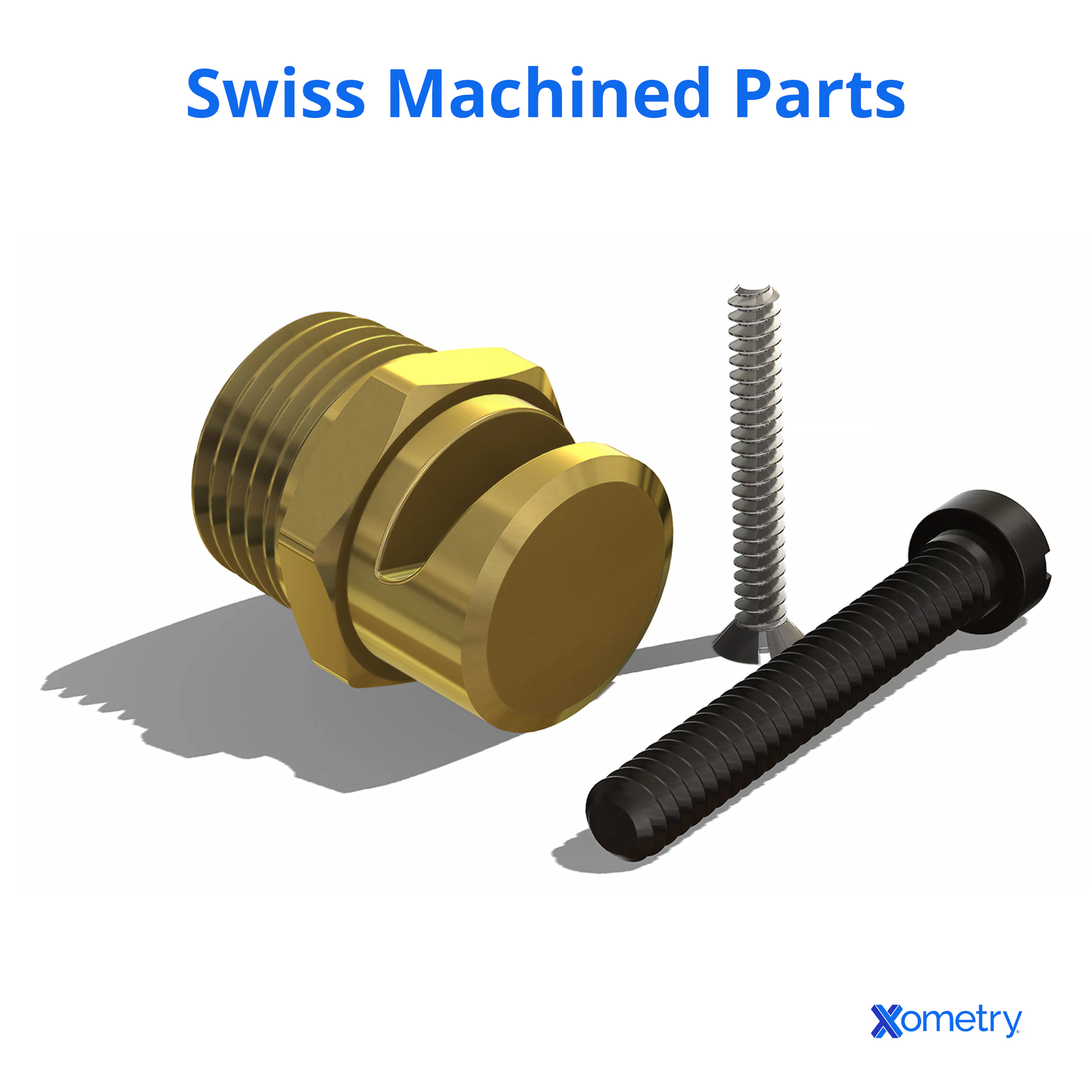

Swiss machining is applied to medical screws, orthopedic pins, aerospace fasteners, electrical connector pins, hydraulic fittings, and miniature shafts generally below 1.25 in diameter. Swiss machining supports materials including brass, copper, aluminum, titanium alloys, stainless steel, nickel alloys, nylon, and Polyether Ether Ketone (PEEK). The configuration maintains stability for parts exceeding 3:1 length to diameter ratios and sustains bar-fed production volumes beyond 10,000 units. Equipment investment exceeds [$150,000], and setup duration ranges from 2 hours to 8 hours per job.
Swiss machined nozzle
A swiss machined nozzle and fine-pitched fasteners.

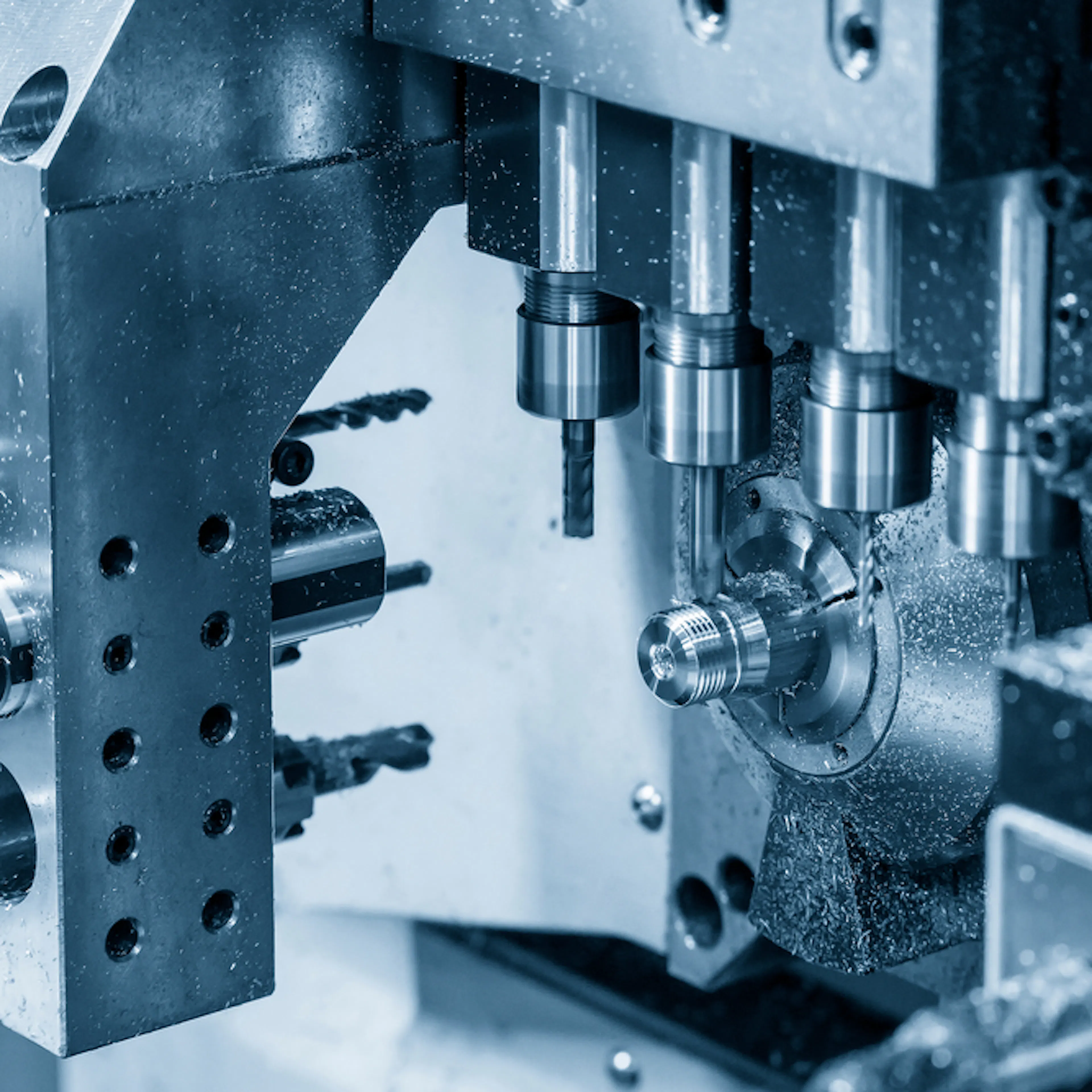

What is Swiss Machining? Swiss machining is a precision manufacturing process that uses a sliding headstock lathe and hardened guide bushing to produce small-diameter, complex components from bar stock. Swiss machining supports the material directly at the cutting plane, typically eliminating unsupported length between the tool and the guide bushing, which reduces radial deflection and vibration. The sliding headstock feeds the workpiece axially along the Z axis while multiple static and live tools perform turning, drilling, milling, and threading in a single setup. The process is designed for small, intricate parts that require tight concentricity and minimal runout.
Swiss machining achieves dimensional tolerances commonly ranging from ±0.0002 in to ±0.001 in, depending on spindle accuracy, tooling rigidity, and thermal stability. Surface finishes reach 16 µin to 32 µin Ra under controlled feed rates and optimized cutting speeds. The method is optimized for parts below 1.50 in diameter and supports continuous bar feeding for production volumes exceeding 10,000 components. High repeatability and stable support define the precision capability of Swiss machining.
How Does Swiss Machining Differ From CNC Machining?
Swiss machining differs from Computer Numerical Control (CNC) machining by structural configuration and material support method. Swiss machining is a specialized type of CNC machining optimized for small-diameter precision parts below 1.25 in. Conventional CNC lathes clamp material at one end, leaving unsupported stock extended into the cutting zone, which increases deflection risk for slender components when unsupported length exceeds a stable 3:1 length-to-diameter ratio without tailstock or steady rest support. Swiss machines use a sliding headstock and hardened guide bushing that support material directly at the cutting plane, effectively eliminating unsupported length between the bushing and the tool, which reduces radial deflection and vibration. The configuration enables tighter tolerances ranging from ±0.0002 in to ±0.001 in in controlled production environments. Standard CNC machining lathes handle larger diameters above 2.00 in and heavier components, whereas Swiss systems excel at slender parts with length to diameter ratios exceeding 10:1 within CNC machining.
Is Swiss Machining Used for High Precision Parts?
Yes, Swiss machining is used for high-precision components. The hardened guide bushing stabilizes the bar at the cutting interface and restricts unsupported length to a near-zero value, which lowers bending stress and dynamic vibration during cutting. Standard production tolerances typically fall between ±0.0002 in and ±0.001 in, depending, on spindle runout, tool wear condition, thermal growth management, and material behavior. Continuous support during axial feed improves circularity and concentric alignment on slender geometries. Surface finishes generally range from 16 µin to 32 µin Ra under stable feed rates and optimized cutting speeds. Industries including medical device manufacturing, aerospace hardware, precision electronics, and micro mechanical systems rely on the process for batch volumes exceeding 10,000 parts. Integrated live tooling and sub spindle transfer permit multiple operations within one machining cycle, which limits stack up error and strengthens repeatable precision output.
How Does Swiss Lathe Machining Work?
Swiss lathe machining works by feeding bar stock through a hardened guide bushing while tools machine the exposed portion of material. The sliding headstock advances the bar along the Z axis into the cutting zone rather than holding the workpiece stationary. The guide bushing supports the material directly at the cutting zone, minimizing radial deflection and vibration. Multiple tools operate sequentially or simultaneously to perform turning, drilling, threading, cross-drilling, and milling operations in one cycle. Live tooling and sub-spindles allow back-side machining without removing the part. Coolant stabilizes temperature and assists chip evacuation. Production tolerances range from ±0.0005 in to ±0.001 in, depending on setup and material properties.
What Makes Swiss Lathe Machining Different From Regular Lathes?
Swiss lathe machining differs from regular lathes because it uses a guide bushing and sliding headstock to support material directly at the cutting plane. Regular lathes clamp bar stock in a chuck or collet at one end and extend unsupported material into the cutting zone, which increases bending forces and deflection on slender parts. Swiss systems position the guide bushing immediately adjacent to the cutting tool, effectively eliminating unsupported length during material removal. The sliding headstock advances the workpiece longitudinally along the Z axis while multiple tools remain arranged around the cutting area. The configuration enables tighter production tolerances commonly between ±0.0005 in and ±0.001 in, depending on machine calibration, spindle accuracy, and thermal stability. The enhanced support improves dimensional control for long, thin components with length-to-diameter ratios exceeding 3:1.
Does a Swiss Lathe Use a Sliding Headstock?
Yes, a Swiss lathe uses a sliding headstock as a defining mechanical feature. The headstock advances bar stock longitudinally through a hardened guide bushing during machining operations. The guide bushing supports the material directly at the cutting plane, eliminating the cantilevered unsupported length found in conventional lathes, which reduces radial deflection and vibration. Unlike conventional lathes, where the workpiece remains clamped in a stationary spindle and tools travel along the axes, Swiss machines feed the material axially through the guide bushing while tools remain positioned around the cutting zone. The configuration improves dimensional control for slender components with length to diameter ratios greater than 3:1. Production tolerances commonly range from ±0.0002 in to ±0.001 in, depending on material properties, tooling rigidity, spindle accuracy, and thermal stability. Surface finishes reach 16 µin to 32 µin Ra under optimized feed rates and cutting speeds. The sliding headstock structure improves concentricity and repeatability during high-volume bar-fed production.
What is a Swiss Machine Used For?
A Swiss machine is used for manufacturing small, complex precision components from bar stock with high dimensional stability. The process performs turning, drilling, threading, cross-drilling, and milling in a single machining cycle. Typical components include surgical screws, orthopedic pins, aerospace fasteners, hydraulic fittings, connector pins, miniature shafts, and precision bushings. Part diameters remain below 1.50 in, with many applications under 0.75 in. Production tolerances commonly range from ±0.0002 in to ±0.001 in, depending on material selection and setup control. Continuous bar feeding systems support production volumes exceeding 10,000 pieces with consistent repeatability. Industries including medical device manufacturing, aerospace hardware production, electronics, and automotive systems depend on Swiss machines for concentric accuracy, surface finish capability near 16 µin to 32 µin Ra, and efficient high-volume precision manufacturing.
What Kinds of Parts are Made With a Swiss Machine?
The kinds of parts that are made with a Swiss machine are listed below.
  • Surgical Screws: Surgical screws require precise thread geometry and dimensional tolerances within ±0.001 in to ensure proper fixation and compatibility with implants. Swiss machining provides stable support for small diameters under 0.50 in. Surface finishes between 16 µin and 32 µin Ra support biocompatibility requirements.
  • Aerospace Fasteners: Aerospace fasteners demand tight concentricity and repeatable head dimensions. Swiss machines maintain tolerances near ±0.0005 in for miniature threaded components. The process supports high-strength materials, including titanium and stainless steel.
  • Connector Pins: Electronic connector pins require consistent diameter control and smooth surfaces for conductivity. Swiss machining produces diameters under 0.25 in with minimal variation. Continuous bar feeding supports large batch production exceeding 50,000 units with consistent dimensional accuracy.
  • Hydraulic Fittings: Hydraulic fittings require leak-resistant threads and concentric bores within ±0.001 in. Swiss machining maintains consistent sealing surfaces and supports carbon steel and stainless steel materials.
  • Fuel Injector Components: Fuel injector parts require tight dimensional control within ±0.0005 in for proper atomization performance. Swiss machining supports diameters below 0.40 in and ensures repeatable geometry in high-volume production exceeding 100,000 units.
