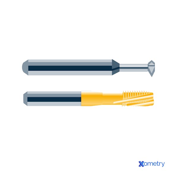

What Does Thread Mill Look Like?
A thread mill bears a resemblance to an end mill but features a thread profile on its side. A thread mill features a shank for secure mounting in tool holders, multiple teeth for cutting threads, a tailored thread profile, an end mill design for precise sizing, and optional coatings to enhance performance. Thread mills come in various sizes and lengths. Their appearance varies based on factors like size and design. Below is a picture so you can get an idea of what a thread mill looks like.
drawing of a thread mill
Drawing of a Thread Mill
This is just an example as their appearance will vary on their size, length, and design — and there’s a whole bunch to choose from.

tapping vs threading
Tapping vs. threading
