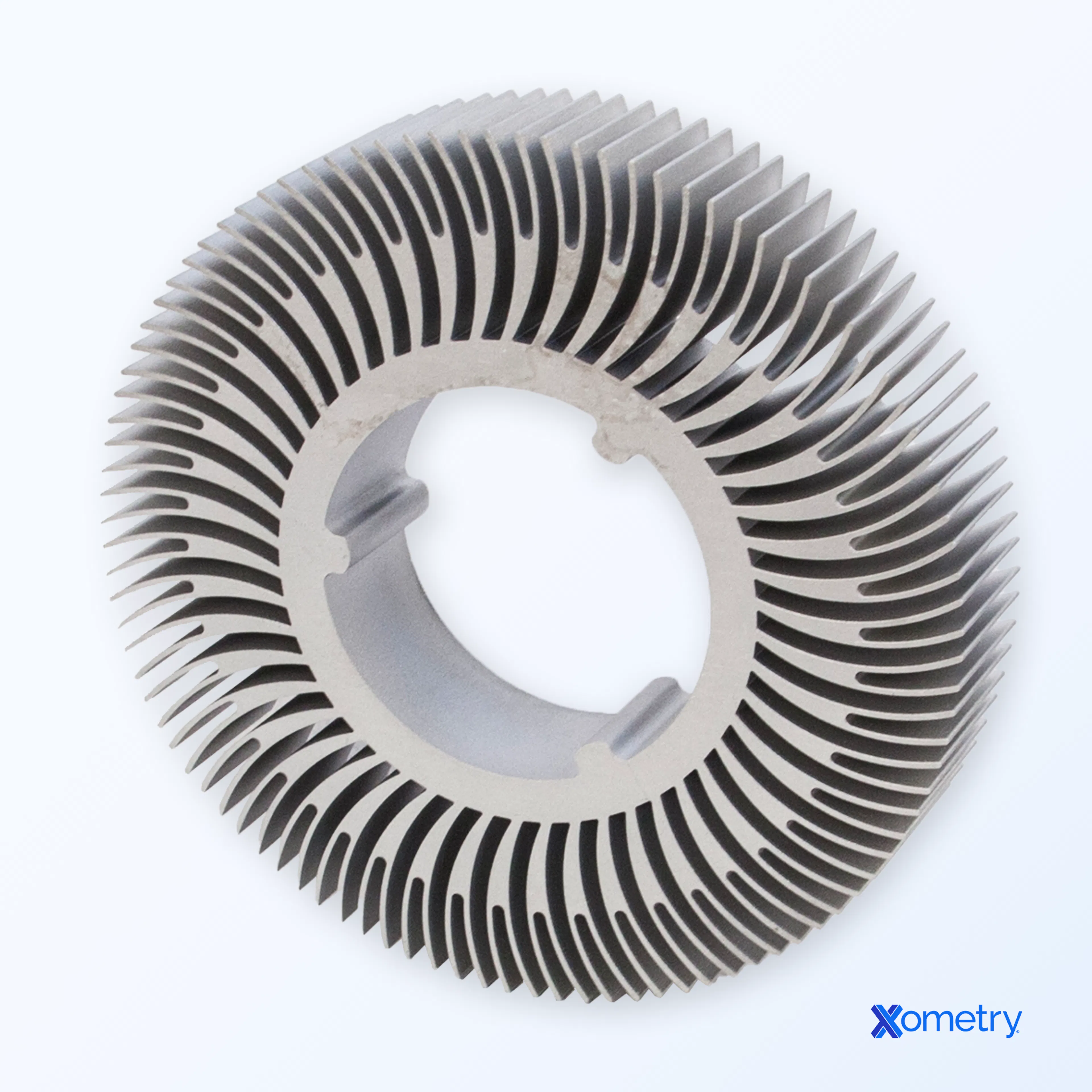

Example of a part Wire EDM would be useful for

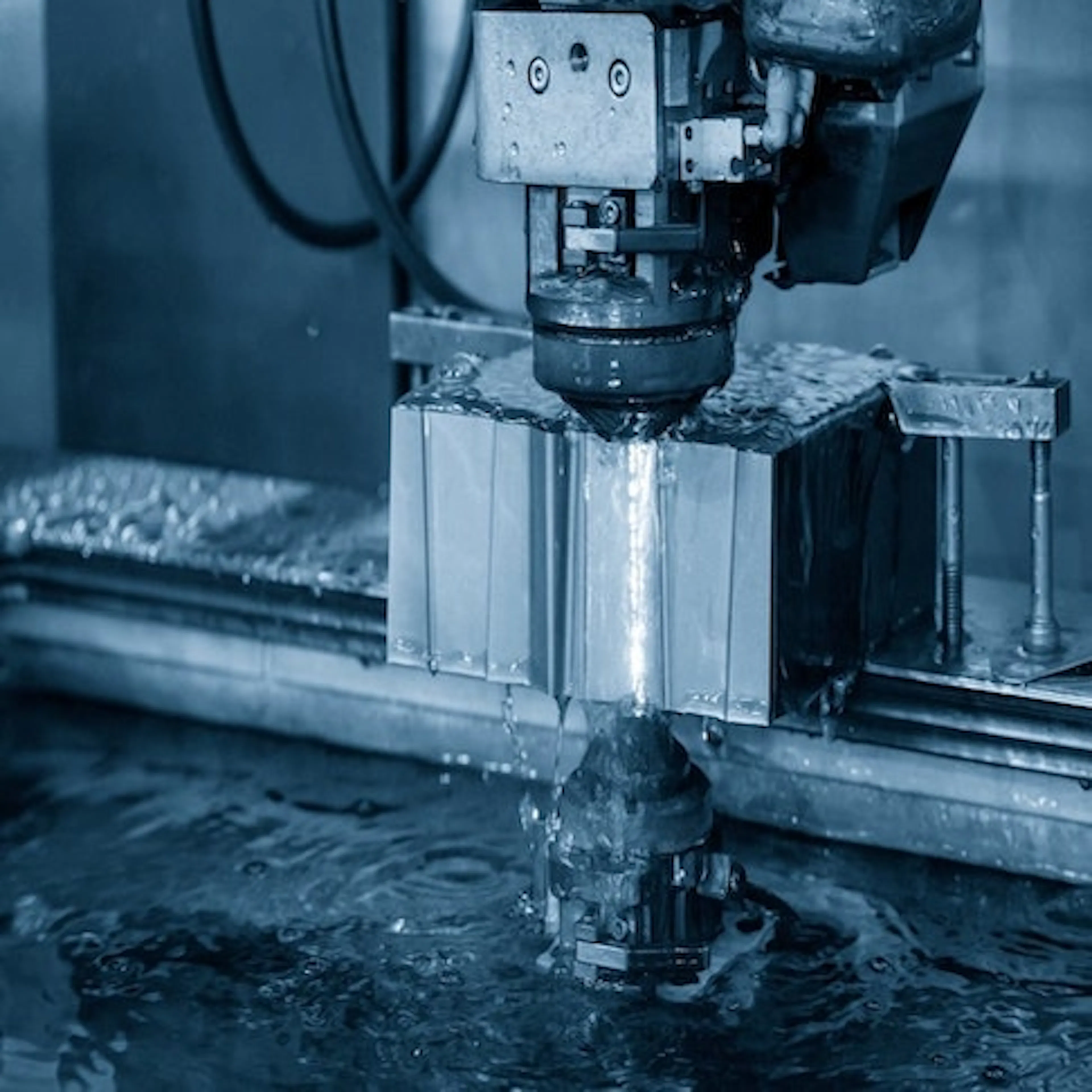

Wire Electrical Discharge Machining (EDM) works by generating electrical sparks between a wire electrode and the workpiece, eroding material without physical contact. CNC control guides the wire along a programmed path. The power supply creates a voltage difference, and the dielectric fluid insulates, cools, and flushes away debris. The dielectric fluid initially acts as an insulator, and when the voltage exceeds the breakdown level of the spark gap, a plasma channel forms that melts and partially vaporizes material. The cycle repeats thousands of times per second with precise movements along multiple axes.
The wire remains in constant motion to prevent breakage, with tension systems ensuring accuracy. Deionized water is the most common dielectric fluid, cooling the cutting zone. The material must be conductive for the process to work. Wire EDM produces localized heat-affected zones and recast layers, though they are typically small compared to many thermal machining processes and achieves micron-level precision, making it ideal for intricate profiles and sharp corners.
