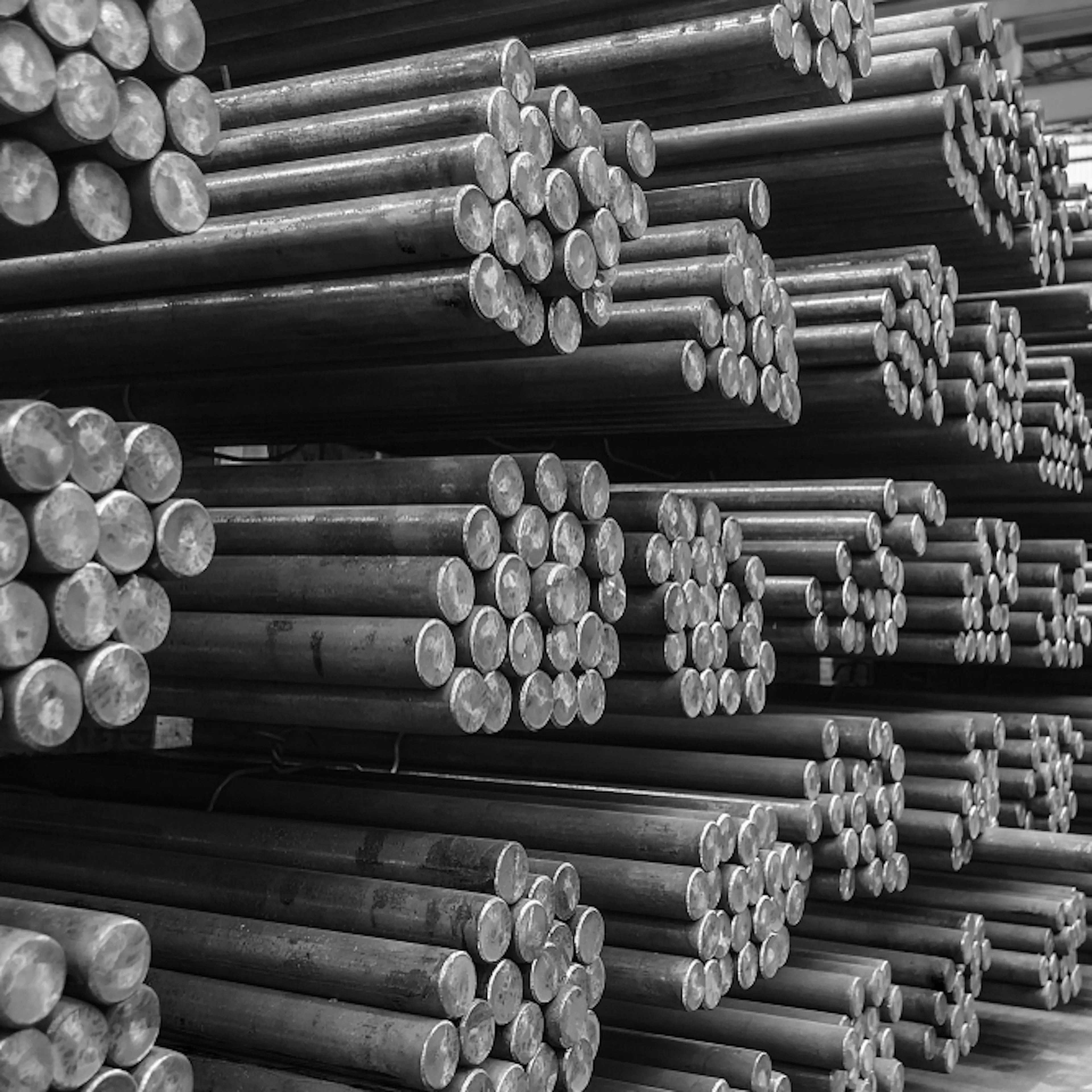

1020 carbon steel rods. Image Credit: Shutterstock.com/Mr. Kosal

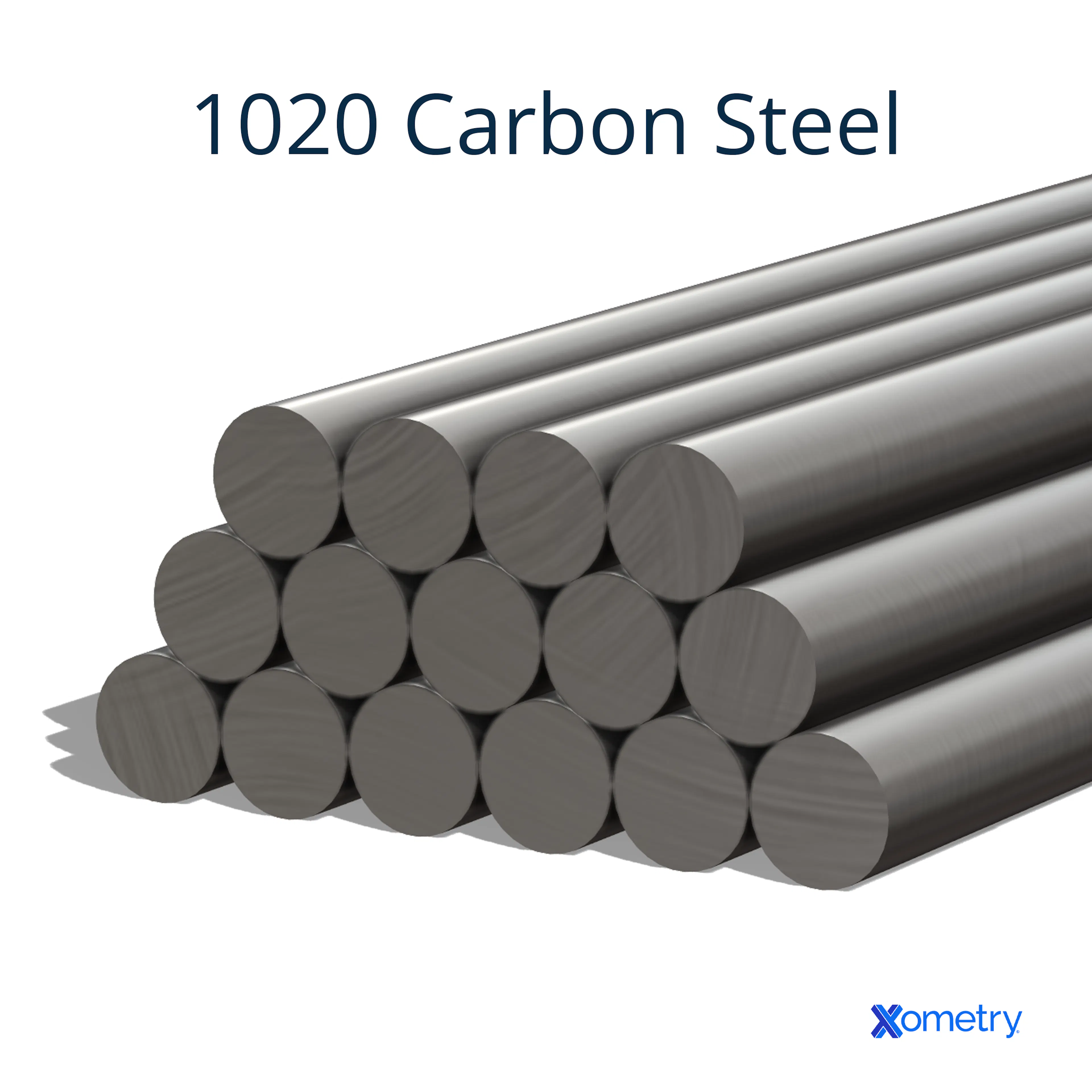

1020 carbon steel is a low-carbon or “mild” steel which means it has a carbon content below 0.3%. In addition to carbon, 1020 steel contains manganese, sulfur, and phosphorus. The low-carbon content of 1020 steel makes it very well suited to machining, welding, and forming. However, that same chemical property prevents 1020 steel from responding well to heat treatment. Material characteristics result in 1020 steel being used in numerous applications, such as: axles, cold-headed bolts, and machine components.
