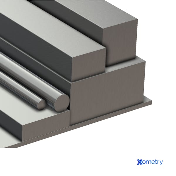

Get to know this popular type of steel that’s used in everything from finishes for your refrigerator to boat fittings.
316 stainless steel. Image Credit: Shutterstock.com/C Levers
316 Stainless Steel is an austenitic stainless steel alloy recognized for its exceptional corrosion resistance, mechanical strength, and long-term durability across demanding industrial environments. 316 Stainless Steel belongs to the 300 series of stainless steels, distinguished by its inclusion of molybdenum, which sets it apart from standard grades. The alloy delivers reliable performance in marine, chemical processing, and medical applications where exposure to moisture, acids, and harsh chemicals is constant.
Stainless steel, as a material category, earns its widespread adoption through a combination of structural strength, aesthetic appeal, and oxidation resistance. The 316 grade modifies the standard austenitic stainless steel composition through elemental addition, including 16% to 18% chromium, 10% to 14% nickel, and 2% to 3% molybdenum. The density of 316 stainless steel measures approximately 7,990 kg/m³ (0.289 lb/in³), making it a reliable and structurally sound material for load-bearing and precision components. The mechanical integrity and chemical stability of the alloy support its reputation as a premier grade within the stainless steel family, referenced extensively in manufacturing platforms such as Xometry for sourcing and machining applications.

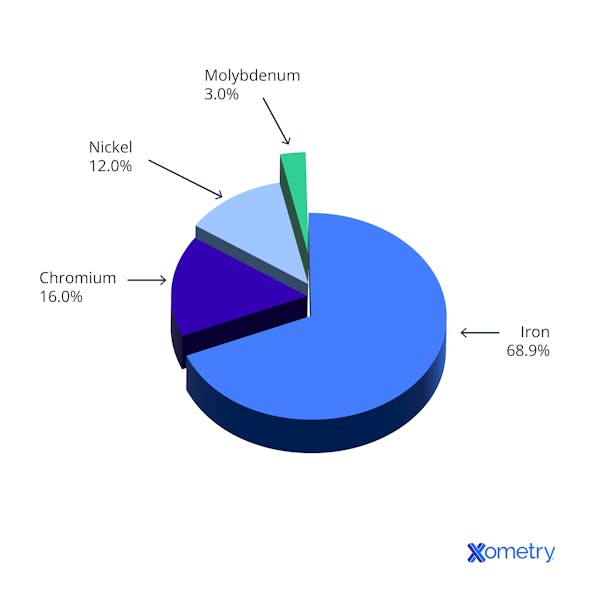

What Is the Chemical Composition of 316 Stainless Steel?
The chemical composition of 316 stainless steel is of iron (Fe) as its base element, supplemented by chromium (Cr), nickel (Ni), and molybdenum (Mo) as the principal alloying elements that define its corrosion resistance and mechanical performance. Chromium content (16% to 18%) generates a passive oxide surface layer that acts as a chemical barrier against rust and oxidation, while molybdenum (2% to 3%) provides targeted protection against pitting and crevice corrosion in chloride environments. Nickel (10% to 14%) stabilizes the austenitic crystal structure and improves ductility and toughness across a wide temperature range. Secondary elements, including carbon (C), manganese (Mn), silicon (Si), phosphorus (P), and sulfur (S), appear in controlled trace quantities that refine the alloy's machinability, weldability, and structural consistency. Carbon content is kept at or below 0.08% to minimize carbide precipitation during welding, a property critical to maintaining corrosion resistance in heat-affected zones. The combined elemental balance ensures 316 stainless steel meets the compositional requirements defined under ASTM A240 and AISI standards, confirming its suitability for high-performance industrial use.
A pie chart displaying the chemical composition of 316 stainless steel.
What Elements Are Included in 316 Stainless Steel Composition?
The elements included in the 316 stainless steel composition are listed below.
  • Iron (Fe): Iron is the base element of 316 stainless steel, comprising the majority of the alloy's composition, typically above 60% by weight. It provides the foundational metallic matrix into which all other alloying elements are dissolved. Iron (Fe) structural properties form the backbone of the alloy's mechanical strength.
  • Chromium (Cr): Chromium is present at 16% to 18% and is responsible for the formation of a passive chromium oxide (Cr₂O₃) layer on the alloy's surface. The passive layer acts as a self-repairing barrier against oxidation and corrosion. Chromium (Cr) is the element that qualifies the alloy as "stainless."
  • Nickel (Ni): Nickel content ranges from 10% to 14% and stabilizes the austenitic crystal structure at room temperature and below. The element enhances the alloy's ductility, toughness, and resistance to acidic environments. Nickel contributes to the non-magnetic character of 316 stainless steel.
  • Molybdenum (Mo): Molybdenum is added at 2% to 3% and is the defining alloying element that differentiates 316 from the 304 grade. The element strengthens the passive oxide film against breakdown in chloride and sulfide-rich environments. Molybdenum directly improves resistance to pitting and crevice corrosion in marine and chemical processing applications.
  • Manganese (Mn): Manganese is included at a maximum of 2% and serves as a deoxidizer during the steelmaking process. The element improves hot workability and contributes to austenite stability. Manganese helps stabilize the austenitic phase of the steel, ensuring uniformity in the material's microstructure.
  • Silicon (Si): Silicon content is limited to a maximum of 0.75% and acts as a deoxidizer during melting and casting. The element improves oxidation resistance at elevated temperatures and contributes to fluidity during casting. Silicon is chemically distinct from silicone polymers, a difference detailed in resources covering Silicone.
  • Carbon (C): Carbon is controlled at a maximum of 0.08% in standard 316 stainless steel to prevent sensitization during welding. Excess carbon reacts with chromium at grain boundaries to form chromium carbides, which depletes corrosion resistance in heat-affected zones. Keeping carbon content low is a primary factor in maintaining the alloy's structural and chemical integrity after fabrication.
  • Phosphorus (P): Phosphorus is present at a maximum of 0.045% and is treated as a residual impurity in stainless steel production. Particularly at low temperatures, elevated concentrations of phosphorus embrittle the alloy and reduce toughness. Strict control of phosphorus content is maintained to meet ASTM A240 compositional standards.
  • Sulfur (S): Sulfur is limited to a maximum of 0.03% and is considered a tramp element in standard 316 stainless steel grades. The presence of sulfur at higher levels reduces corrosion resistance by promoting the formation of manganese sulfide inclusions. Sulfur content is deliberately minimized to preserve the alloy's resistance to pitting and intergranular corrosion.
1. Iron (Fe)
Iron is the base metal in 316 stainless steel, constituting the majority of its mass. It provides the structural foundation of the alloy and determines its basic mechanical characteristics, including density and magnetic response in deformed states. In pure form, iron is highly reactive and prone to oxidation, but when combined with chromium and other alloying elements in 316 stainless steel, the resulting alloy becomes resistant to rust and environmental degradation. Iron is found across structural components in construction (beams, fasteners, and framing systems), where it serves as the backbone of ferrous and stainless steel manufacturing, as in products covered under Iron (Fe).
2. Chromium (Cr)
Chromium is present in 316 stainless steel at a concentration of 16% to 18% and is the element responsible for the alloy's corrosion resistance. The element reacts with oxygen to form a thin, stable chromium oxide (Cr₂O₃) layer on the surface, which acts as a passive barrier against rust and chemical attack. The layer self-repairs when damaged in the presence of oxygen, maintaining the alloy's protective function over time. Chromium is applied across industrial environments (chemical reactors, coastal infrastructure, and medical devices) where persistent corrosion protection is required, as seen in products involving Chromium (Cr).
3. Nickel (Ni)
Nickel is included in 316 stainless steel at 10% to 14% and stabilizes the austenitic face-centered cubic crystal structure at room and elevated temperatures. The element improves the alloy's ductility, toughness, and resistance to impact loading, making the material formable without cracking during machining or fabrication. Nickel also enhances resistance to reducing acids (sulfuric and hydrochloric acids at moderate concentrations) and contributes to the material's performance in cryogenic environments. Industries relying on Nickel (Ni) in 316 stainless steel include aerospace, medical device manufacturing, and food processing, where material integrity at varied temperatures is a manufacturing requirement.
4. Molybdenum (Mo)
Molybdenum is present at 2% to 3% in 316 stainless steel and is the key differentiator from the 304 grade. The element strengthens resistance to pitting and crevice corrosion in chloride environments, including seawater, brine, and chlorinated industrial fluids. Molybdenum also improves elevated temperature strength and resistance to creep, which refers to slow deformation under sustained stress at high temperatures. The element's contribution is measurable in marine hardware, pharmaceutical manufacturing equipment, and chemical processing tanks, where exposure to aggressive chemicals demands long-term material stability. Products covered under Molybdenum (Mo) reflect the grade's suitability for corrosion-critical and high-temperature service environments.
5. Manganese (Mn)
Manganese is present in 316 stainless steel at a maximum concentration of 2% and serves as a deoxidizer during steelmaking, removing oxygen from the melt to prevent porosity in the final product. The element improves hot workability, allowing the alloy to be processed and shaped at elevated temperatures without cracking or surface defects. Manganese also contributes to hardness and tensile strength, supporting the alloy's structural performance. It partially substitutes for nickel in stabilizing the austenitic phase at a lower cost. It makes Manganese (Mn) an essential element in enhancing the alloy's performance.
6. Silicon (Si)
Silicon is included in 316 stainless steel at a maximum of 1% and acts as a deoxidizer in the steel melt, reducing the presence of oxygen-related defects during casting and solidification. The element improves fluidity during casting and contributes to the alloy's resistance to oxidation at elevated temperatures, which is relevant in high-heat industrial processes. Silicon also provides minor strengthening effects through solid solution hardening. Silicon functions differently as a primary material in electronic and semiconductor manufacturing, but in stainless steel alloys, the element supports processing performance and thermal stability, making Silicon (Si) an important component in maintaining the alloy's durability under high-temperature conditions.
7. Carbon (C)
Carbon is present in standard 316 stainless steel at a maximum of 0.08% and plays a role in determining hardness and tensile strength through its interaction with iron and other alloying elements. At low concentrations, carbon contributes to the alloy's strength without significantly compromising ductility. At elevated levels, carbon reacts with chromium at grain boundaries during welding, forming chromium carbides that deplete the passive layer and reduce corrosion resistance, a process called sensitization. Controlling carbon content to within specified limits preserves the performance of the alloy in welded assemblies and heat-affected zones, as addressed in products involving Carbon (C).
8. Phosphorus (P)
Phosphorus is restricted to a maximum of 0.045% in 316 stainless steel and is treated as a trace impurity rather than an intentional alloying element. At controlled levels, phosphorus improves machinability and strength. At elevated concentrations, phosphorus causes embrittlement, particularly at grain boundaries, which reduces toughness and fatigue resistance in service. The element segregates to grain boundaries during solidification, weakening intergranular bonds under mechanical or thermal stress. Strict compositional control during steelmaking keeps phosphorus within allowable limits to preserve the alloy's mechanical performance. Quality control processes governing Phosphorus (P) levels are part of standard stainless steel production specifications under ASTM A240 and EN 10088.
9. Sulfur (S)
Sulfur is present in 316 stainless steel at a maximum of 0.03% and is controlled strictly due to its negative effects on corrosion resistance and ductility. At elevated concentrations, sulfur forms manganese sulfide (MnS) inclusions within the steel matrix, acting as initiation sites for pitting corrosion and reducing resistance in chloride environments. The element is intentionally kept at trace levels to preserve the alloy's corrosion performance. In free-machining stainless steel grades, sulfur is added deliberately at higher levels to improve chip formation during machining. Minimizing Sulfur (S) content remains a defined requirement in ASTM and ISO material specifications for standard 316 applications.
