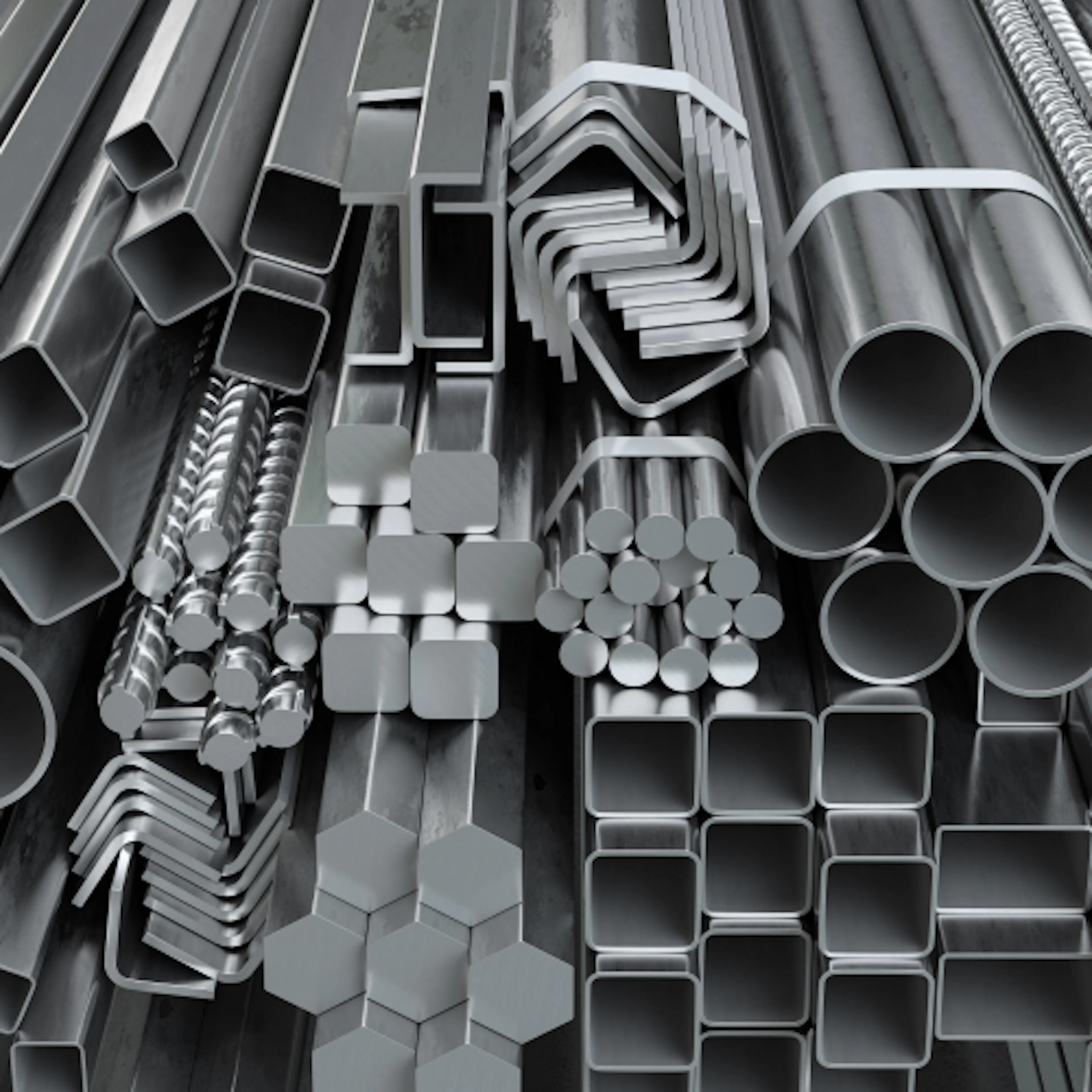

4130 steel tubing. Image Credit: Shutterstock.com/Maxx-Studio
4130 steel is a low-carbon alloy steel. It stands out from other steels as it has a high chromium and molybdenum content which reinforces the steel making it stronger whilst also improving its corrosion resistance. 4130 steel is used, as many sheets of steel are, for structural applications as well as cutting and milling tools, fasteners, aircraft landing gear, and in resistance welding.
