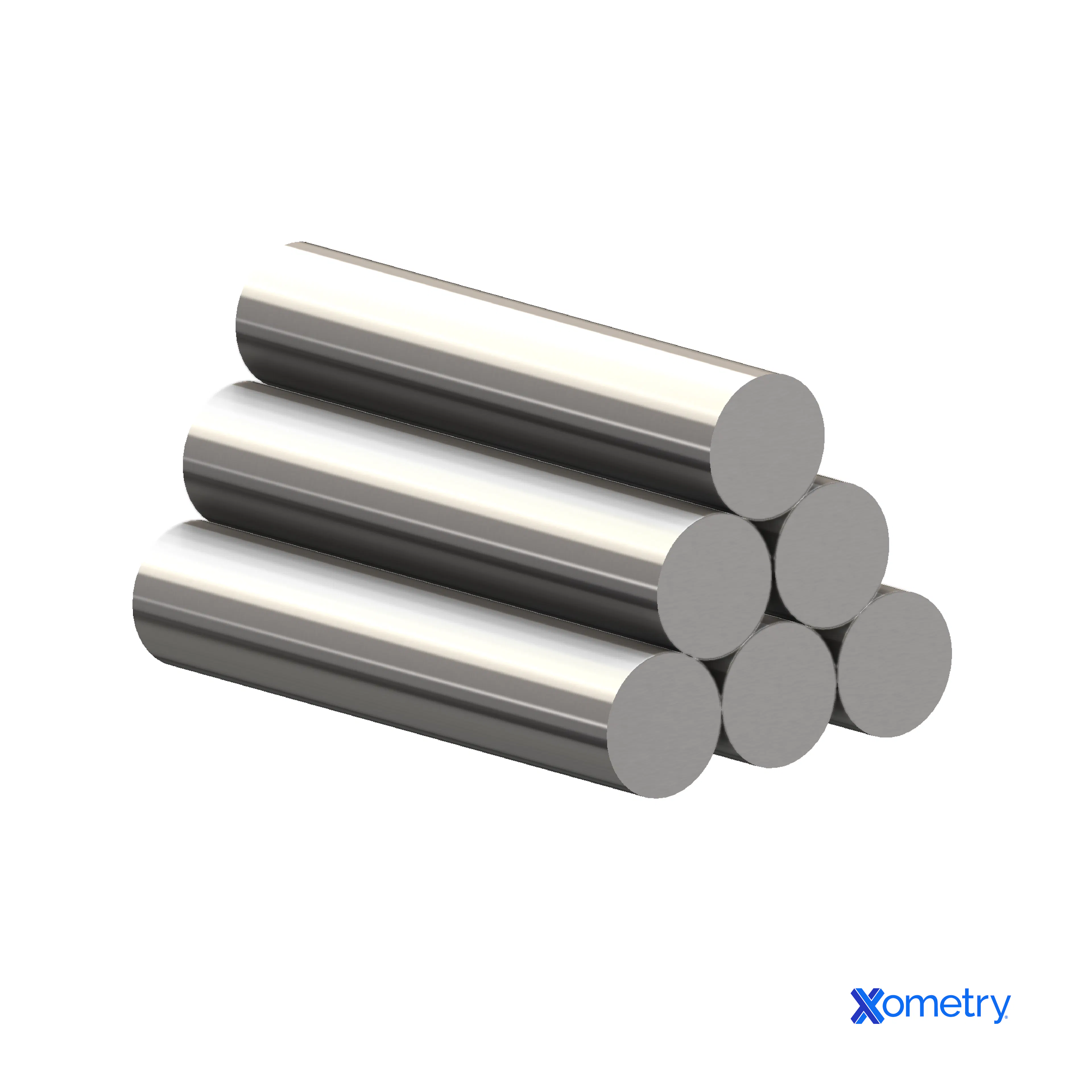

420 steel bars. Image Credit: Shutterstock.com/Maxx-Studio
