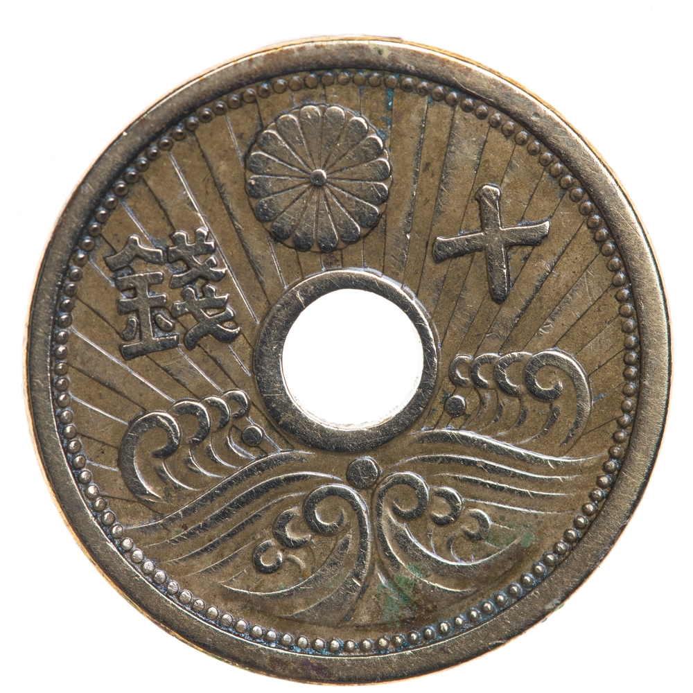

Aluminum bronze coin. Image Credit: Shutterstock.com/Runglawan Khrutjaikla

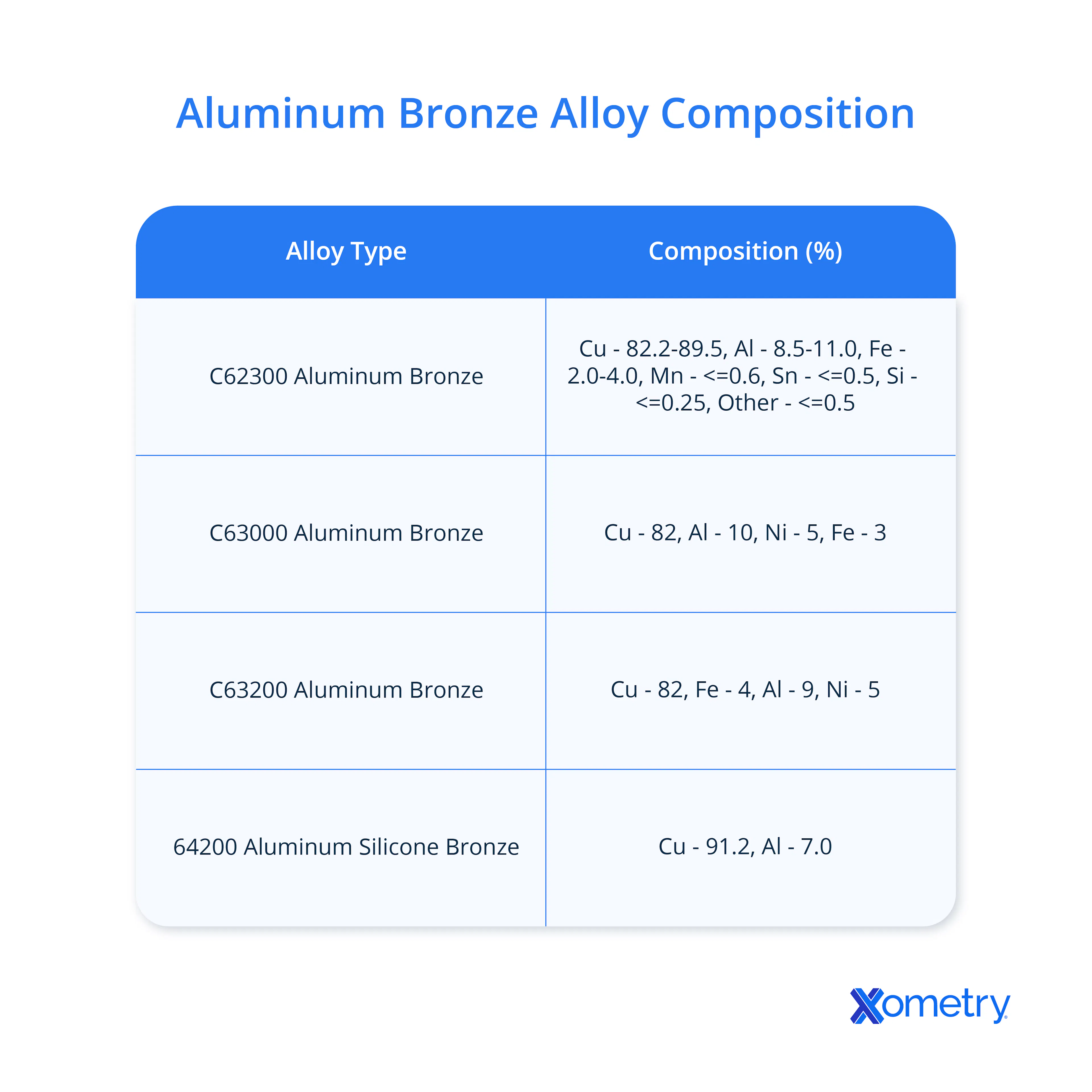

What Is Aluminum Bronze Made Of?
Over the years, hundreds of different aluminum-bronze alloy types have been developed, each with its own specific combination of materials which makes them ideal for different uses. Each type has its own Unified Numbering System (UNS) designation. In the table below, you’ll find examples of some of the most common types of aluminum bronze alloys and their compositions.
composition of aluminum bronze alloy
Aluminum bronze alloy composition.

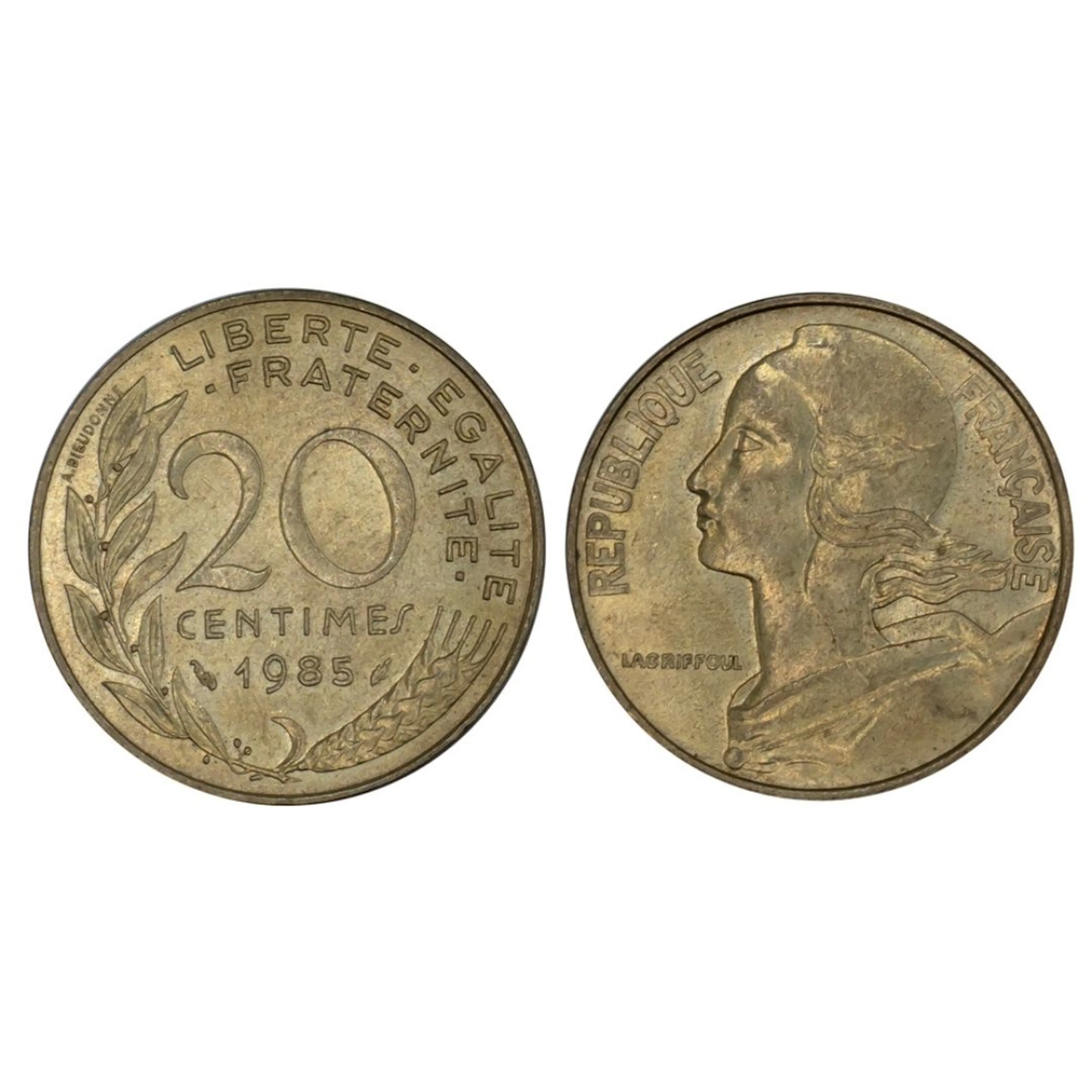

What Does Aluminum Bronze Look Like?
Below is an example of what a final aluminum bronze product can look like.
aluminum bronze coin
Coin made of aluminum bronze.
Image Credit: Shutterstock.com/CL Shebley
