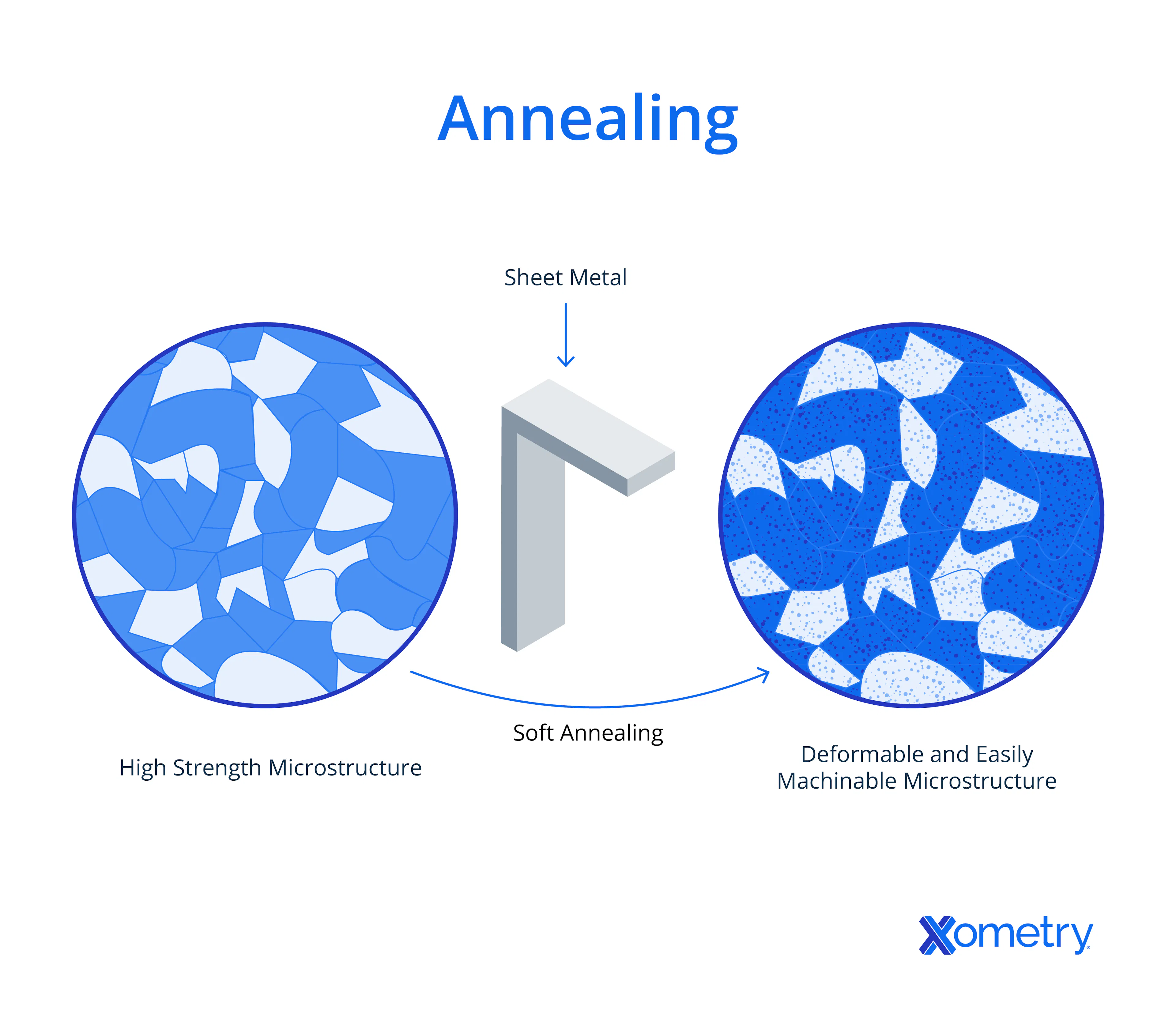

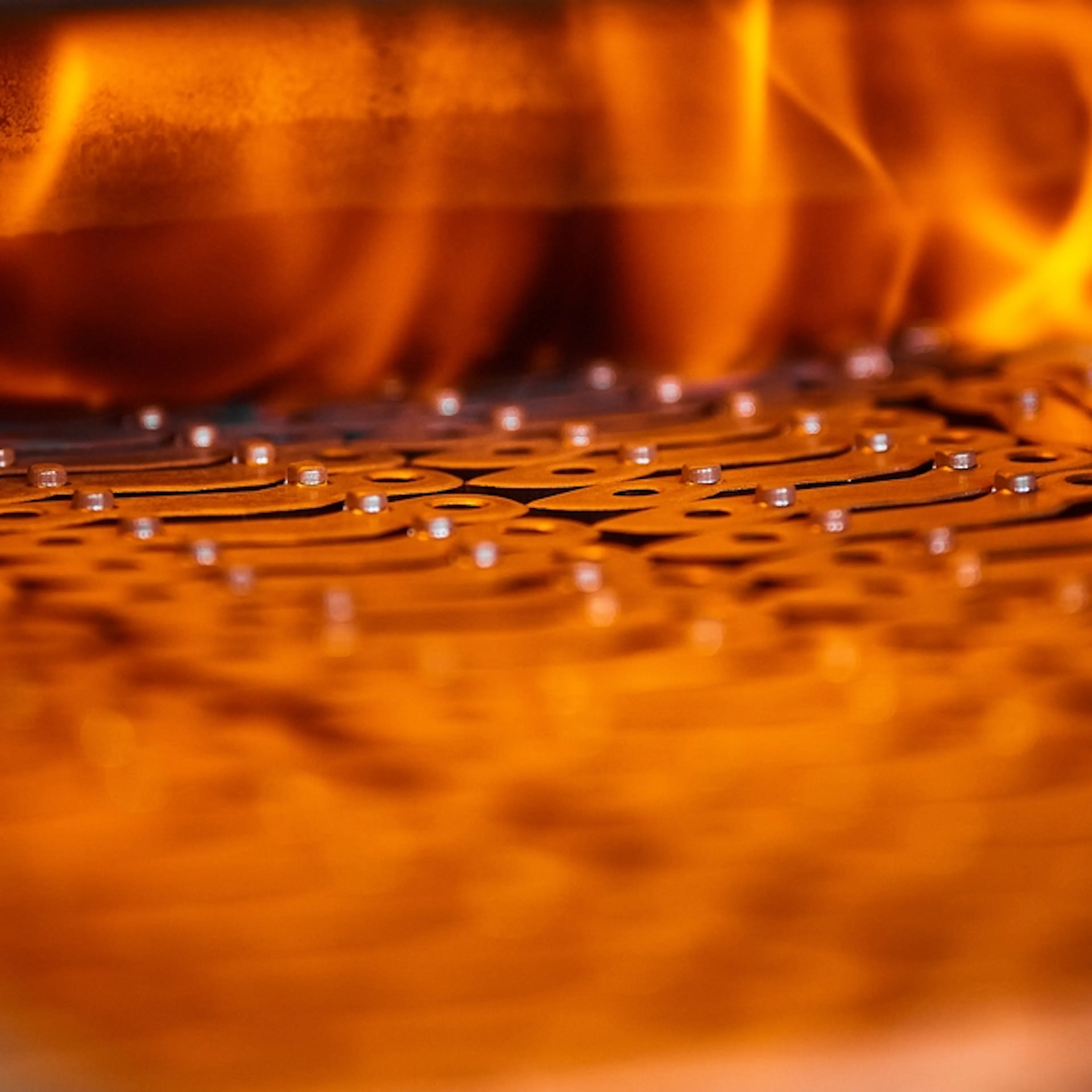

Annealing is a process in which metal is heated and then allowed to cool, in order to restore its original ductility and reduce hardness and brittleness. It is often used to rectify work hardening that occurs in cold-formed components like rolled sheets or drawn wires. Annealing has other benefits as well, such as having some control over the metal’s grain structure, which in turn can be used to improve machinability.
What Is Annealing?
Annealing is a heat treatment of metals or alloys that restores some of the material’s original physical properties. In particular, it increases ductility and decreases hardness. Annealing is done by raising the temperature of the metal to above its recrystallization temperature but below its melting point. This higher temperature gives enough energy to the metal to allow migration within the metal’s microstructures. This in turn results in dislocations being rectified, and internal stresses being relieved. Once the metal is cooled down again, its ductility will have been restored.

The main purpose of annealing is to relieve internal stresses in a metal, particularly after cold working has been carried out. Annealing also has the related purpose of restoring a higher ductility to a metal, which decreases its hardness as well. Annealing can also have the further purpose of controlling the types and sizes of grains that are present in a metal. As a whole, annealing aims to modify and restore the physical properties of a metal.
Why Is Annealing Important?
Annealing is important because it significantly reduces the risk of metal cracking from work hardening, and counteracts the work hardening that occurs during forming of a metal component. Annealing allows the original physical properties of a metal to be restored after the component has been formed, removing grain deformations or internal stresses that would have been introduced during forming.
Does Annealing Increase Ductility?
Yes, annealing does increase ductility. Annealing allows dislocations in the microstructure to be resolved, thus restoring the metal structure to a regular arrangement and optimizing its ductility. Eliminating the dislocations prevents the material from fracturing or cracking under strain.

How Does Annealing Work?
Annealing works by giving the atoms in the steel microstructure sufficient energy to be able to migrate within the structure. This energy is provided by raising the temperature of the steel, and the migration is the key action taking place. This migration of atoms within the steel microstructure allows dislocations and internal stresses to be resolved. It also allows (if the temperature is high enough) for more grains to be formed. Allowing all the atoms to migrate to form a complete and regular crystal lattice restores the original physical properties of the metal. Such migration restores full ductility and removes any work hardening that may have been created previously.

What Temperature Is Annealing Done?
The temperature at which annealing is achieved depends on the material being annealed, and the type of annealing being carried out. Annealing is typically carried out either just below the lower critical temperature of an alloy for stress relief annealing, or just above the upper critical temperature, for complete annealing. The values of these temperatures will depend on the specific alloy. For steel, stress relief annealing is typically carried out at around 700 °C, and for complete annealing, the temperatures can be as high as 1,200 °C.
