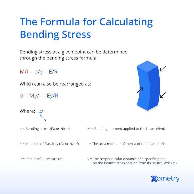

What Is the Bending Stress Formula?
Here is the formula you should know in order to calculate bending stress:
M/I = σ/y = E/R
Or you can write it like this:
σ = My/I = Ey/R
Here is what the following letters and symbols mean within this formula:
  • σ is bending stress (Pa or N/m²)
  • M = Bending moment applied to the object (Nᐧm)
  • y = the perpendicular distance between the neutral axis and a specific point on the object’s cross-section
  • I = the area moment of inertia of the object (m⁴)
  • E = modulus of elasticity or Young’s modulus (Pa or N/m²)
  • R = radius of curvature (m)
Bending stress calculation
How to Calculate the Bending Stress?
Bending stress is calculated through the bending stress equation:
σ = My/I
In this formula, M represents the moment, which is calculated by multiplying the applied force by its distance from a reference point. The variable y represents the perpendicular distance from the neutral axis to the specific point of interest, and I signify the moment of inertia for the item’s cross-sectional shape. It's essential to emphasize that this equation is valid only if we assume the material behaves elastically and adheres to Hooke's law. Hooke’s law describes the linear relationship between stress and strain in a material within its elastic limit.
