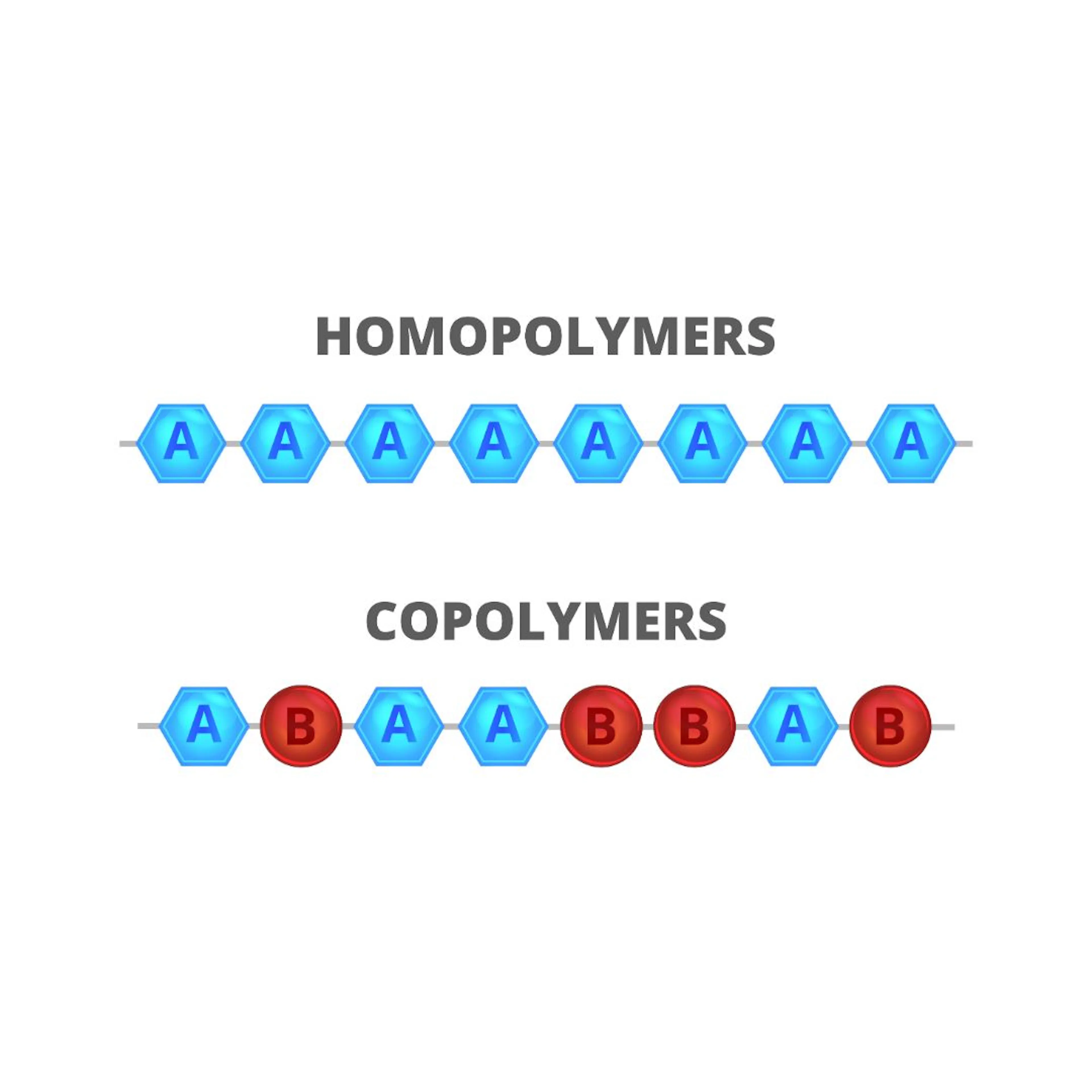

Homopolymers vs. copolymers. Image Credit: Shutterstock.com/petrroudny43
Copolymers and homopolymers are distinct groups of polymers defined by the makeup and arrangement of their chemical structures. Homopolymers are distinguished by the fact that they are formed of one type of repeated monomer. Conversely, copolymers are made of at least two variants of monomers in any form of repeating pattern. While copolymers and homopolymers have some varying mechanical properties they mostly share the same applications, including: textiles, piping, car trim, films, and battery cases.

How Do Copolymers and Homopolymers Differ in Structure?
Copolymers and homopolymers differ in their chemical structure. Homopolymers consist of one variant of monomer which is repeated multiple times in a chain. Copolymers differ from homopolymers in structure because they use two or more variants of monomer to produce a chain.
Additionally, copolymers and homopolymers differ in the way their monomer chains are connected. Copolymers are differentiated into linear copolymers and branched copolymers.
These two categories are further divided into alternating, statistical, and block for linear copolymers, and grafted and star for branched copolymers.
An alternating linear copolymer alternates consecutively as in Figure 2 (A-B-A-B-A-B). A block linear copolymer will alternate in blocks of repeating monomers (A-A-A-A-B-B-B-B). Lastly, a statistical linear copolymer comprises two or more repeating monomers that repeat in a statistically predictable pattern.
