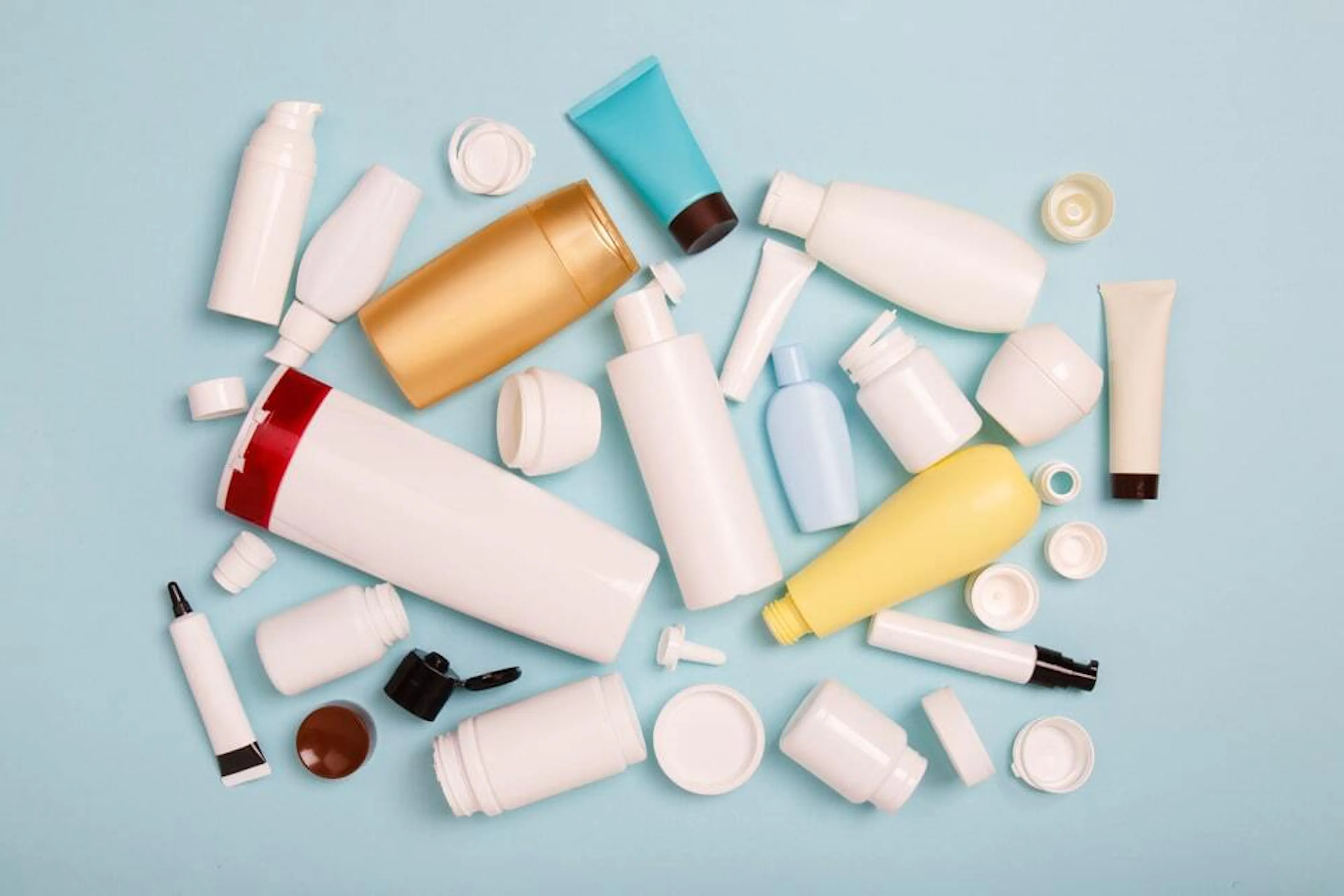

Assorted HDPE bottles. Image Credit: JasminkaM/Shutterstock.com

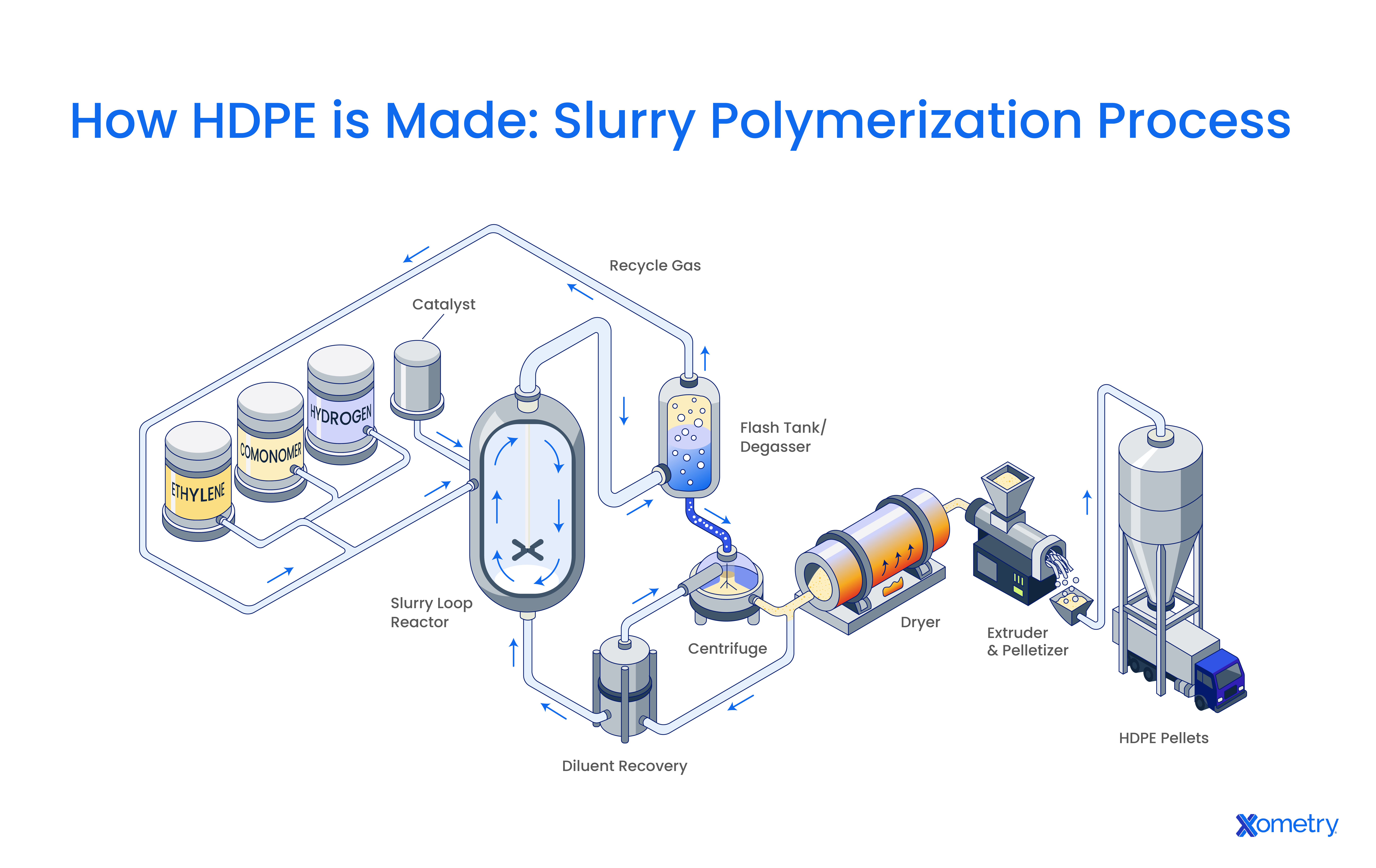

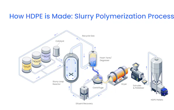

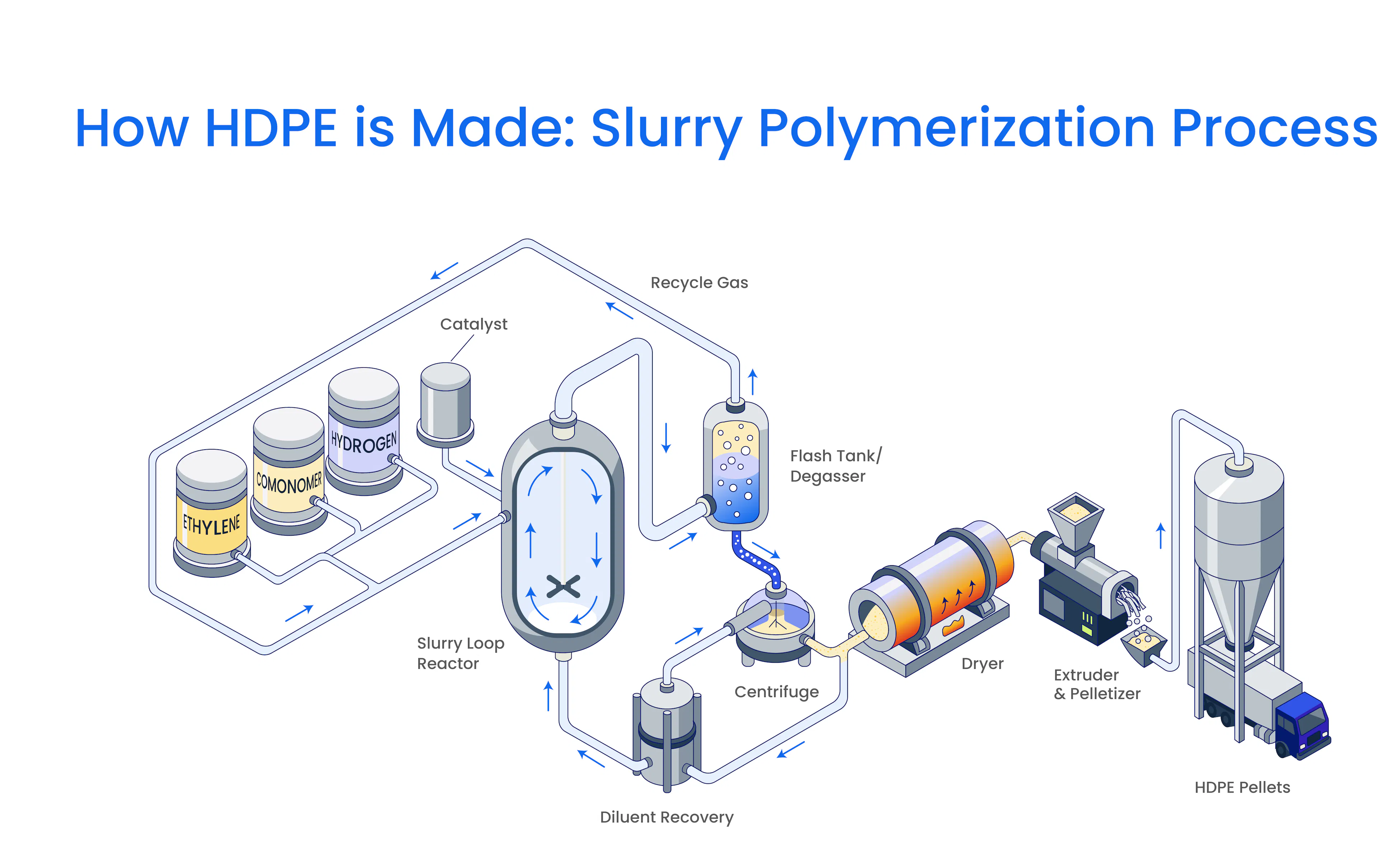

How is HDPE Material Made?
HDPE (High-Density Polyethylene) is made by polymerizing ethylene gas under low pressure, or using low-pressure techniques with Ziegler-Natta or chromium catalysts.  The ethylene molecules are linked together to form long polymer chains during the process. HDPE is produced using Ziegler-Natta or chromium catalysts, which help control the polymer structure and properties (density and crystallinity). The catalysts allow manufacturers to fine-tune the material’s characteristics, resulting in HDPE's strength, rigidity, and chemical resistance. The controlled polymerization process ensures that HDPE is durable and suitable for a wide range of applications (packaging, pipes, and containers).
How HDPE is Made Slurry Polymerization Process
