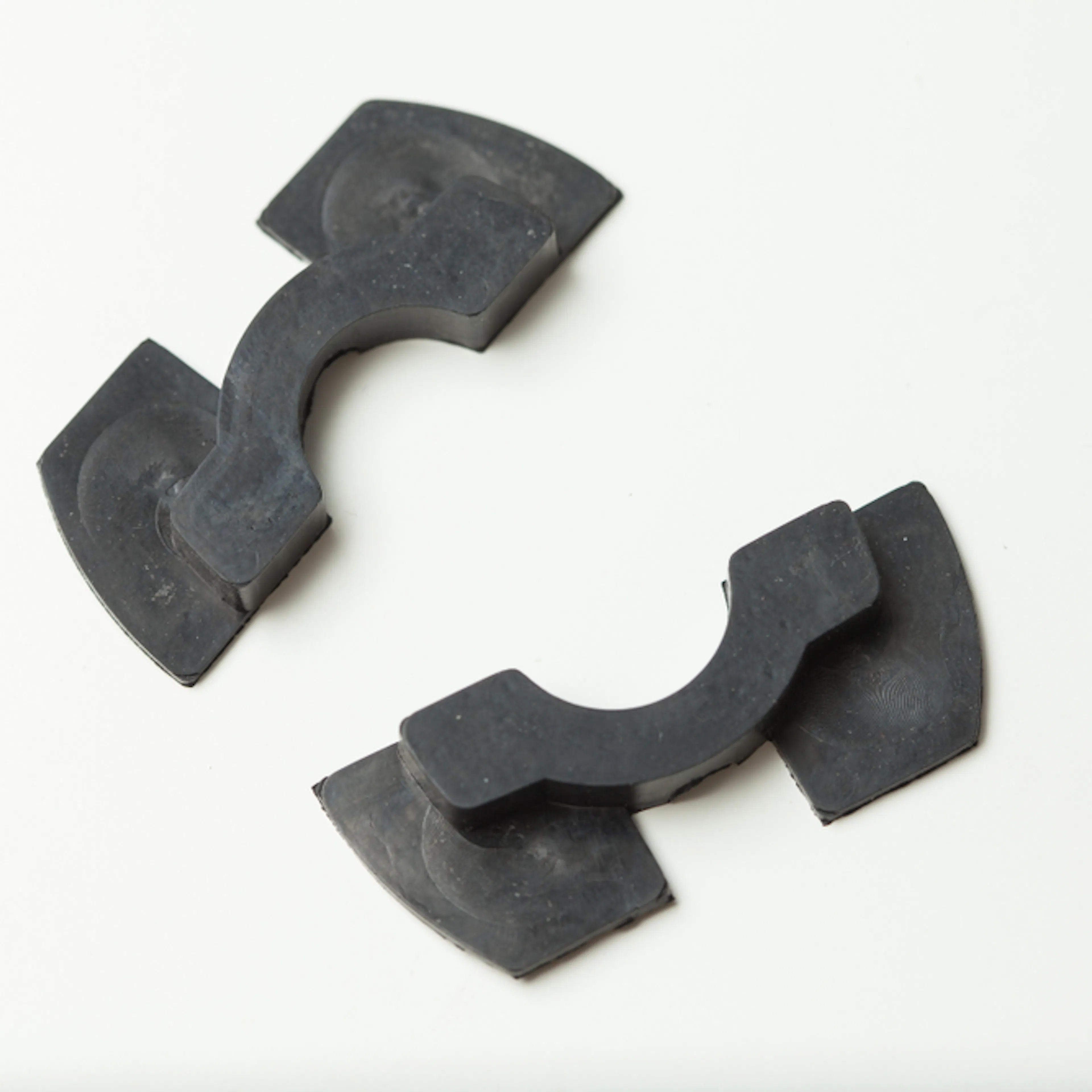

Vibration dampers. Image Credit: Shutterstock.com/Cryptographer
