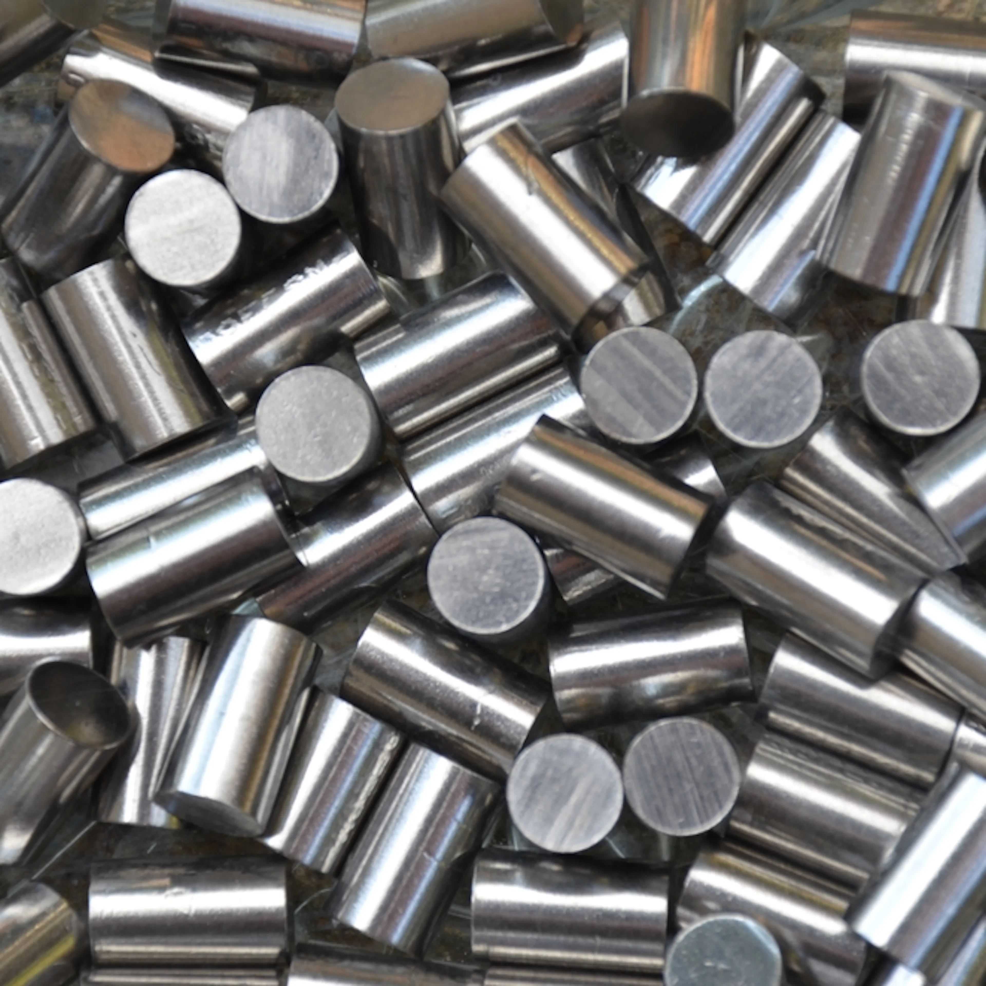

Nickel alloy. Image Credit: Shutterstock.com/Choc'art

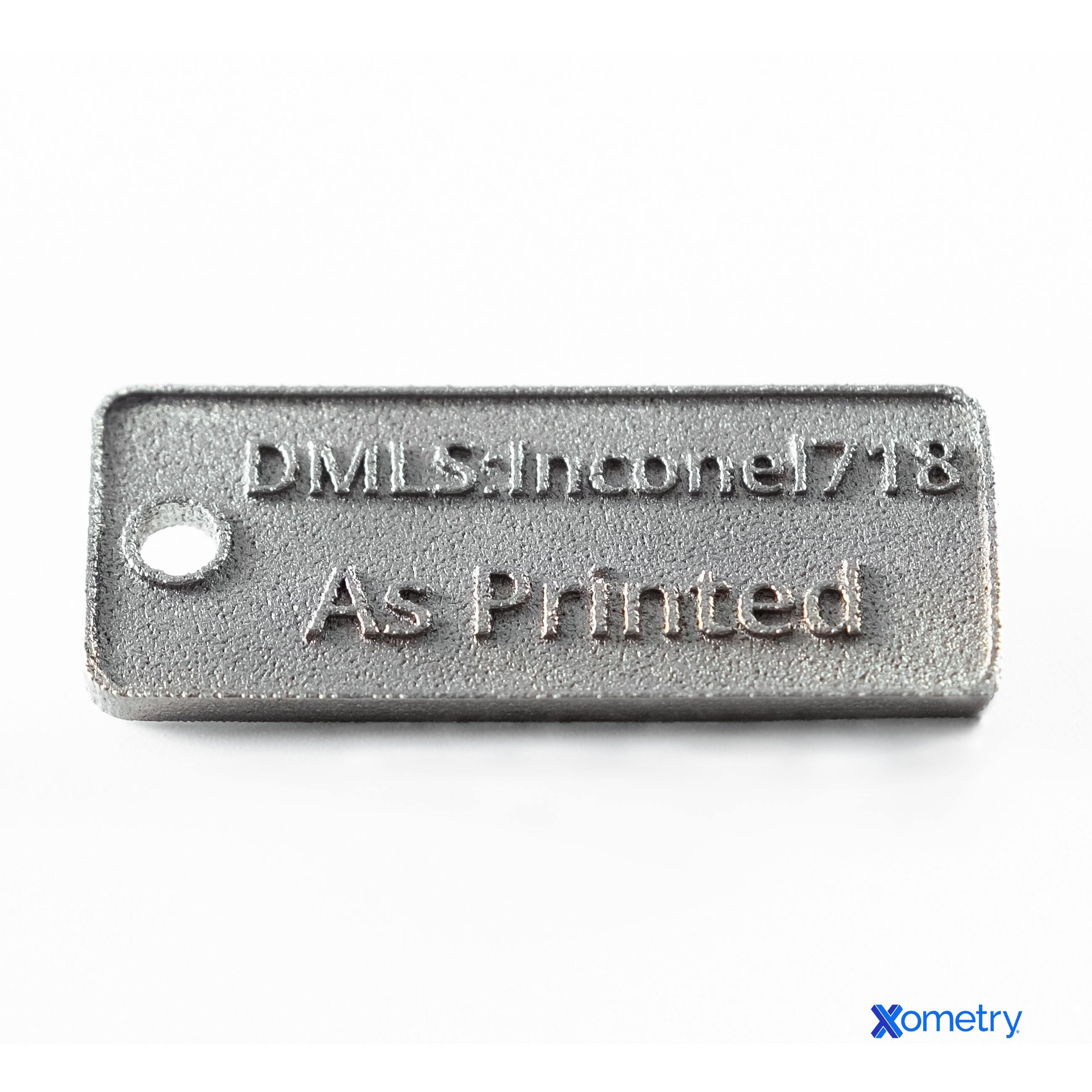

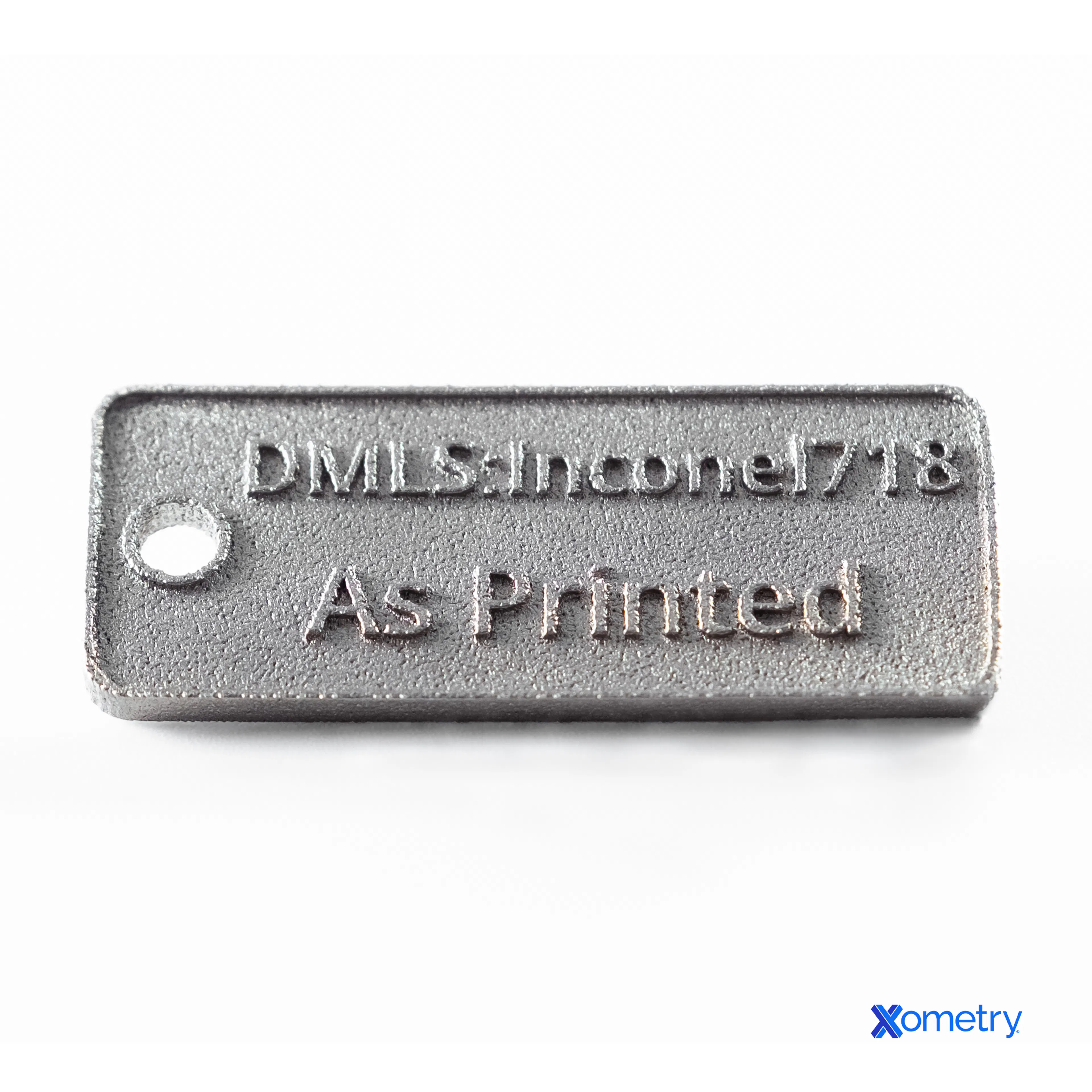

DMLS part made with Inconel

  • Powder Metallurgy (PM): PM processes atomize molten Inconel into fine powder, which is consolidated by hot isostatic pressing (HIP) or selective laser melting (SLM) to produce near-net-shape components with uniform microstructure and reduced material waste.
For complex geometries and low-volume production, 3D printing Inconel can produce near-net-shape components while reducing material waste compared with conventional subtractive methods.
