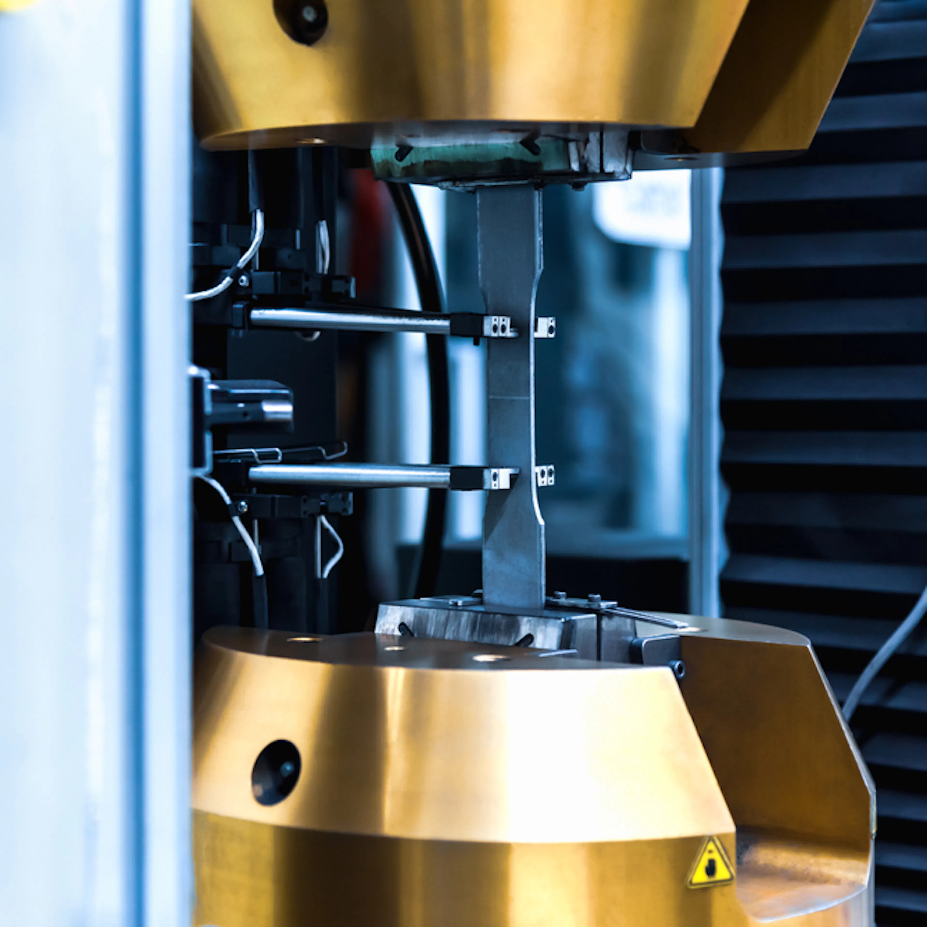

Tensile testing machine. Image Credit: Shutterstock.com/N_Sakarin
Lap shear testing measures the force required to break a bonded joint by applying a load parallel to the bonded surface. Engineers across manufacturing sectors depend on accurate bond evaluations to ensure structural integrity in high-performance assemblies. Adhesive bonding failures cause catastrophic damage in load-bearing applications, making reliable test data a foundational requirement. Industries from automotive to aerospace rely on standardized procedures to validate joint performance before components enter service. Construction firms evaluate structural adhesives through controlled shear loading to meet building codes and safety requirements. Metal substrates, composite panels, and polymer assemblies all undergo evaluation to confirm bond durability under mechanical stress. The relationship of the applied force and the bonded area determines whether a joint meets performance specifications. Composite materials present unique bonding challenges that require specialized evaluation protocols to capture accurate failure data. Strength evaluation methods follow precise procedural guidelines that enable repeatable, comparable results across laboratories. The data generated informs material selection, process development, and quality assurance decisions throughout the product lifecycle. Manufacturers targeting compliance with international quality certifications depend on rigorous procedural adherence during any lap shear test.

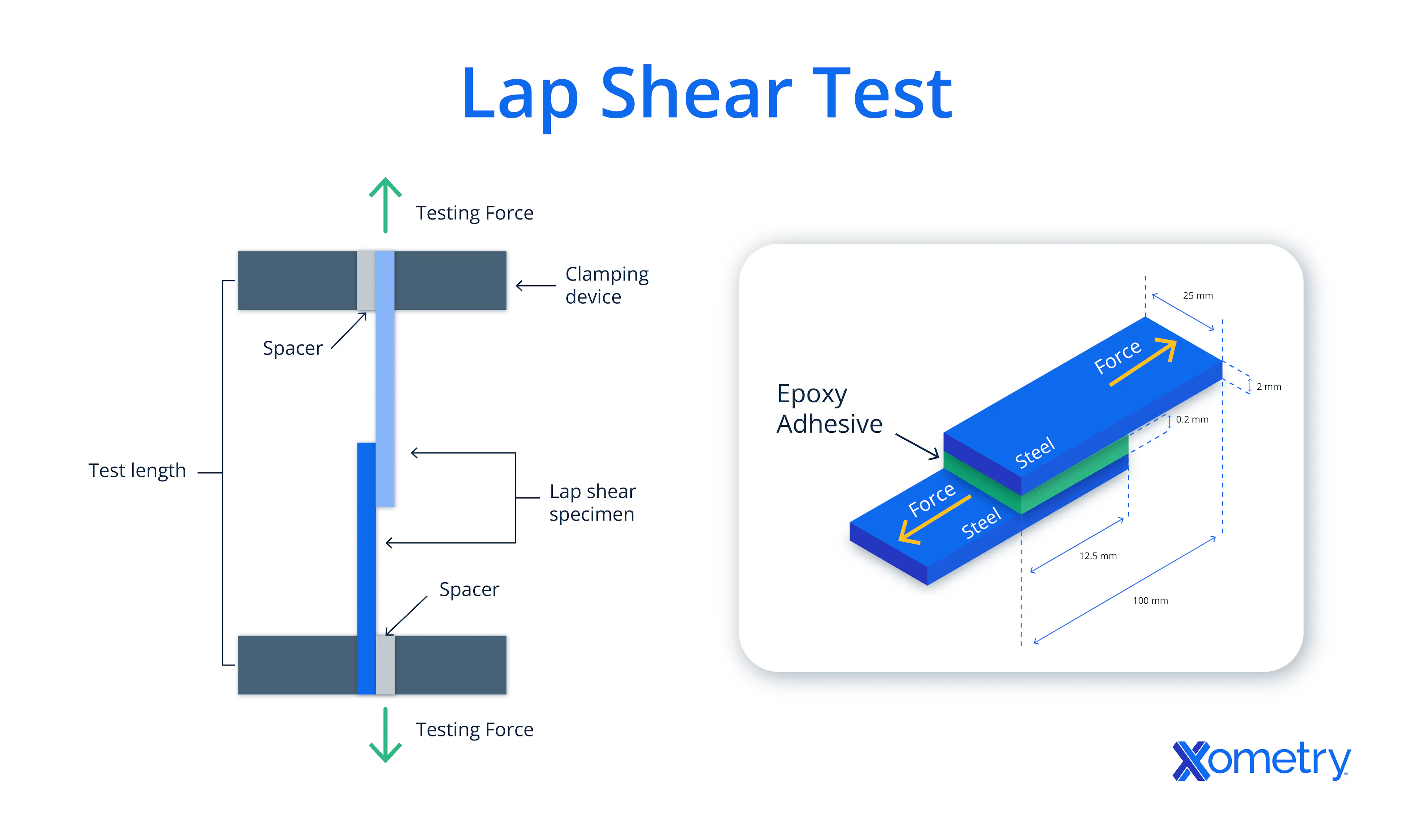

Lap shear testing measures the shear strength of a bonded joint by pulling two overlapping substrates in opposite directions along the adhesion plane. The two flat specimens are bonded over a defined overlap area and loaded until failure. The maximum force at failure, divided by the bonded area, gives the shear strength value in pressure units. The method evaluates joint integrity, showing how well adhesives or fastening systems perform under real-world conditions. Automotive manufacturers use lap shear testing to validate structural adhesives in body panels and crash-critical structures. Aerospace engineers rely on it to certify composite joints in airframes where bond failure is unacceptable. The lap shear testing, in construction, evaluates structural glazing and prefabricated panel connections. The test evaluates shear behavior while acknowledging inherent secondary peel forces, making results directly relevant to the joint pattern. Material scientists analyze failure patterns to improve adhesive formulations. The precision of the lap shear test makes it the preferred method for qualifying bonds across industries. Lap shear strength data support finite element models that predict structural behavior under service loads. Standardized procedures ensure consistency across labs and supplier qualification programs.
An example of a lap shear test.
How Does a Lap Shear Test Work?
The lap shear test works by clamping two substrate specimens in opposing grips of a tensile testing machine, then applying a tensile load that forces the bonded overlap area to experience shear stress. The load acts parallel to the bonded interface, not perpendicular to it, which distinguishes shear testing from peel or tensile pull-off tests. Specimen geometry follows strict dimensional requirements, including defined overlap length, width, and total specimen length, to ensure consistent stress distribution across the bond area. Surface preparation directly affects bond quality, so substrates undergo cleaning, abrading, or chemical treatment before adhesive application. Fixture alignment keeps the load path centered on the specimen assembly, minimizing additional bending moments that would distort the measured failure load. The bonded assembly cures under controlled temperature and pressure conditions before testing begins. A crosshead moves at a fixed displacement rate while the load cell records force continuously until the joint fails. Peak load, displacement at failure, and load-displacement curve shape all contribute to the complete dataset. Failure surface inspection after testing identifies whether the adhesive, substrate, or interface zone controlled the fracture. The entire procedure demonstrates lap shear behavior under repeatable, controlled conditions that translate directly to engineering pattern data.

What is the Single Lap Shear Test Method?
The single lap shear test method evaluates the shear strength of a joint formed by overlapping two specimens. Technicians bond the coupons with a specific overlap area and pull them apart in a tensile tester. The load alignment is applied parallel to the substrates to evaluate shear performance. Stress distribution across the joint remains non-uniform due to the eccentricity of the load. High stress concentrations occur at the ends of the overlap area. The method is the most used because it reflects common industrial joint patterns. Manufacturers prefer the mentioned setup for its simplicity and cost-effectiveness in routine quality checks. The test reveals the effectiveness of the adhesive under typical structural loads. Engineers use the resulting data to set pattern limits for bonded assemblies. Consistent execution of the single lap shear test provides a baseline for material performance.
