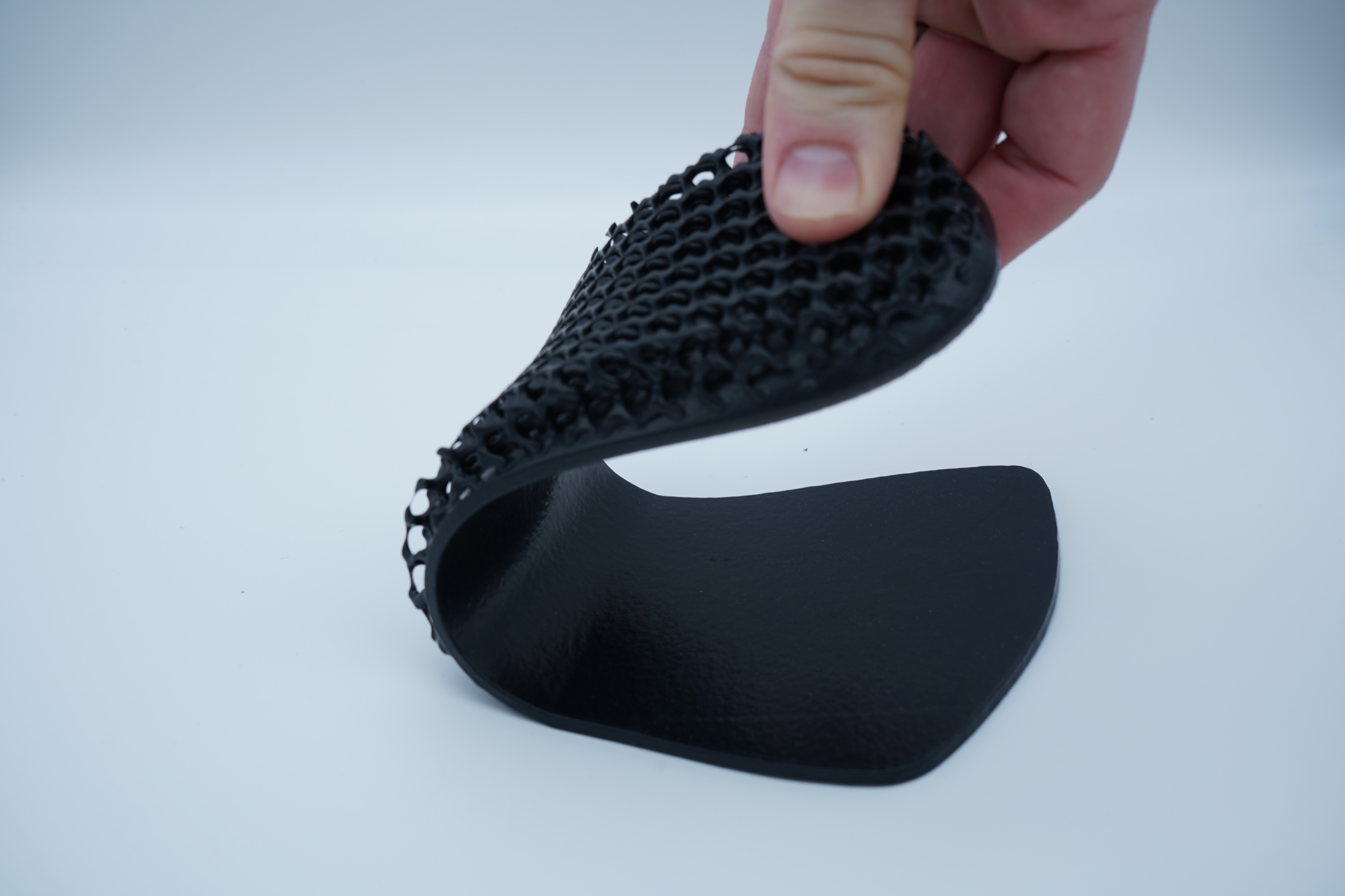

Nylon 11: Durable and Ductile
Nylon 11 is a thermoplastic material known for its optimal mechanical properties and ductility. It is derived from renewable castor oil, offering a reduced environmental impact.
  • Strong and ductile
  • High elongation at break
  • Good impact resistance
  • Ideal for prostheses, insoles, sports goods, snap fits, and living hinges
  • Can be dyed black and vapor smoothed
Nylon 11 creates durable, ductile, parts
