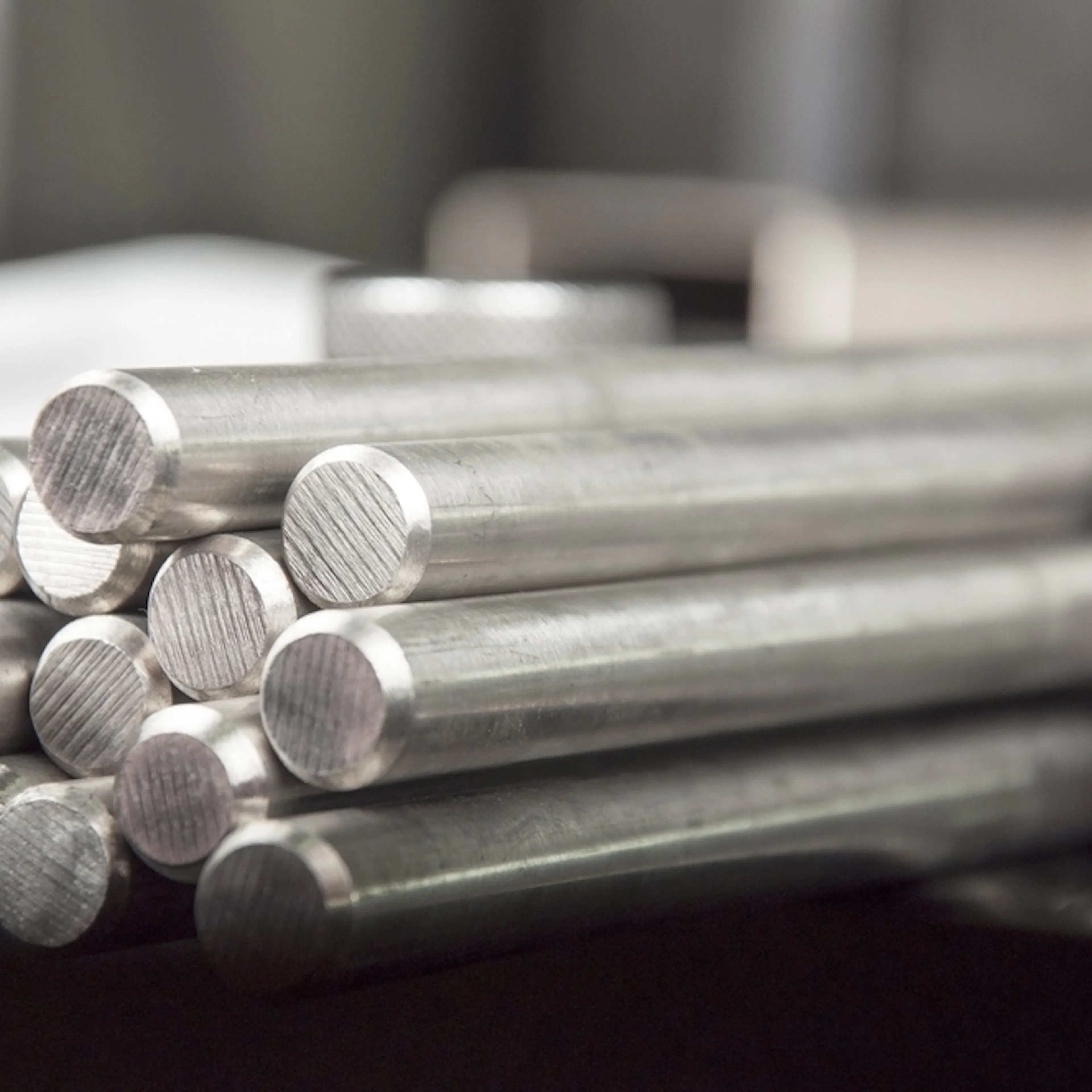

Stainless steel rods. Image Credit: Shutterstock.com/dedek
Stainless steel and Monel may both be classed as alloys and even share many of the same characteristics, but their composition, uses, and strengths and weaknesses are quite different. This article is for all of our customers who want to know which alloy to use for their specific manufacturing needs. If you’d rather watch an explanation of these differences, playthe video below.

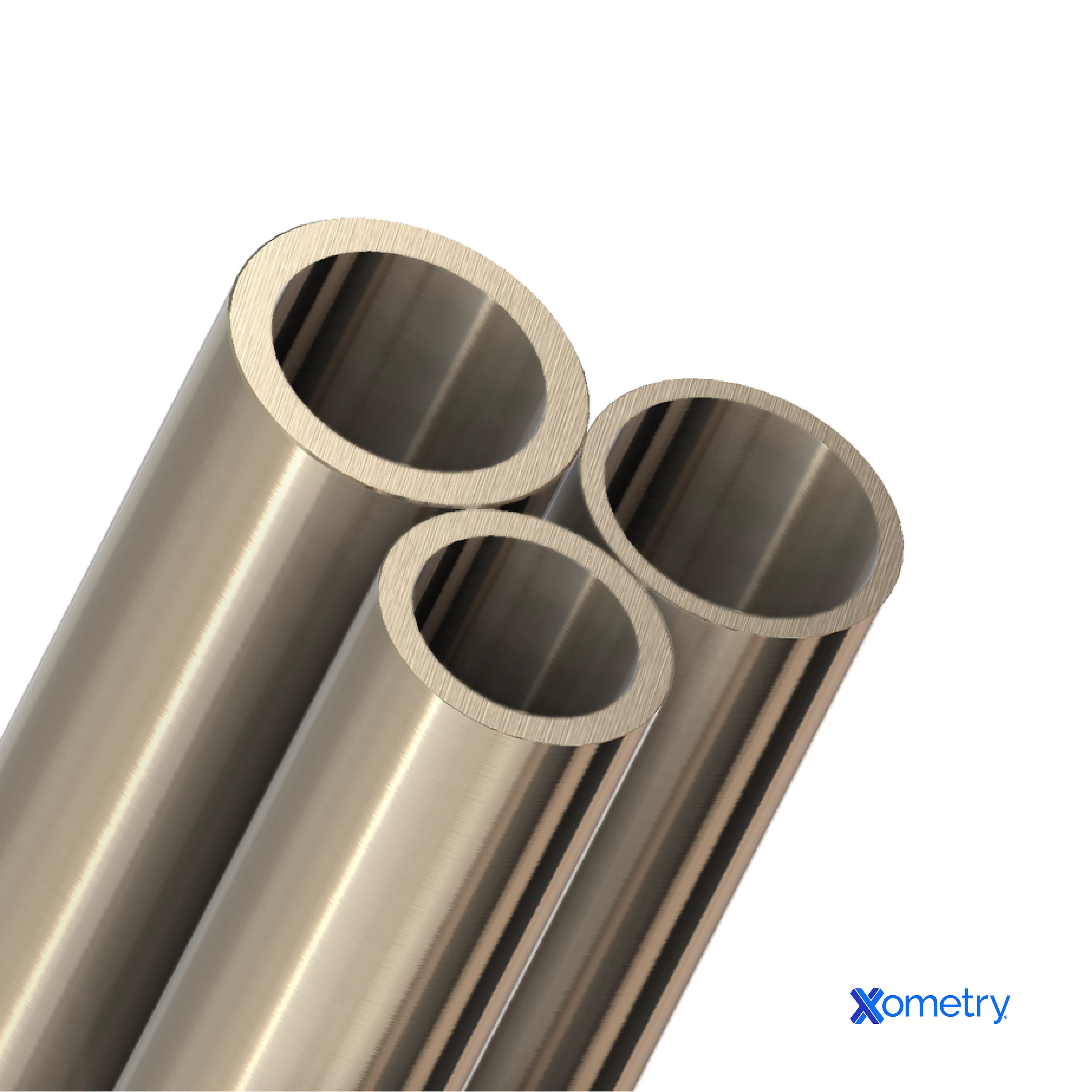

An image of monel
An image of monel
There are a few caveats, though. If Monel comes in contact with a different metal and an electrolyte, it could experience galvanic corrosion due to the electrical interaction between the metals (kind of like how a good apple can start to rot next to a bad one). While it does have good heat resistance, it is not as high as some other alloys, and its density means it won’t be suitable for making lightweight objects. To machine Monel, you’ll need specialized processes and tools. It’s also not as readily available as some other materials, so you might yourself struggling to get a hold of some.
