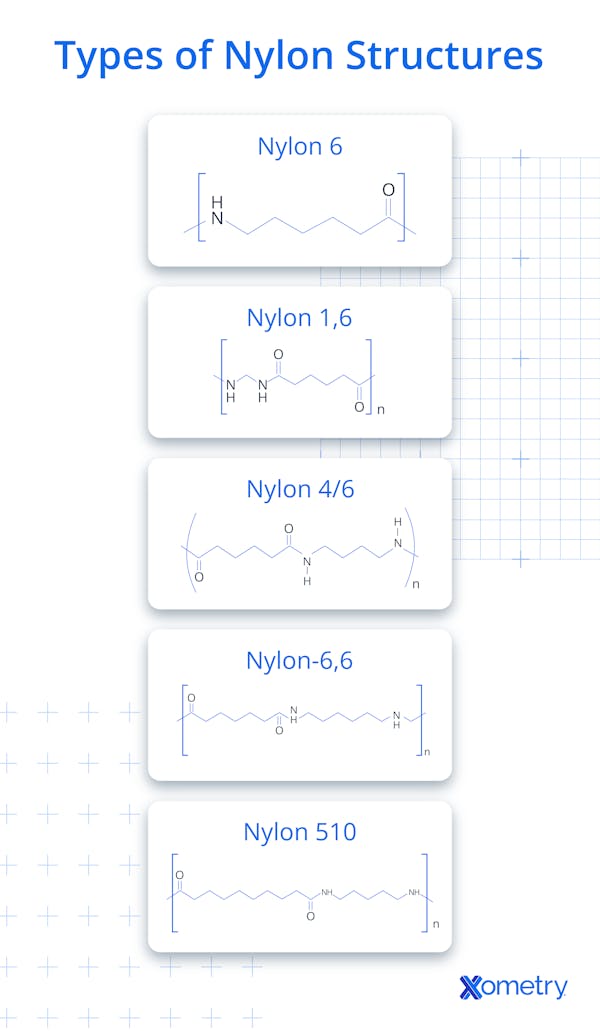

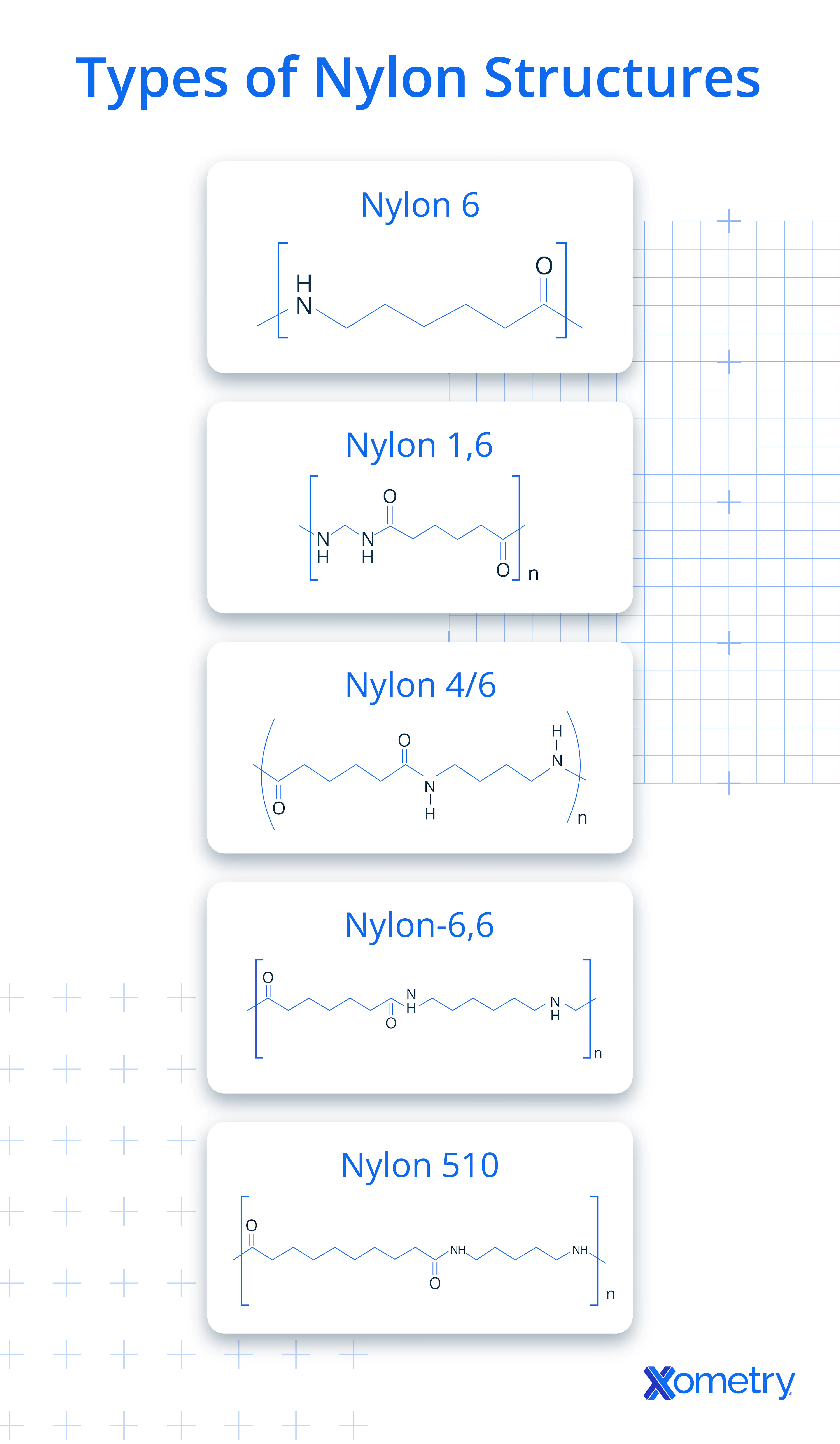

An infographic showing nylon 6; nylon 1,6; nylon 4/6; nylon 6,6; and nylon 510

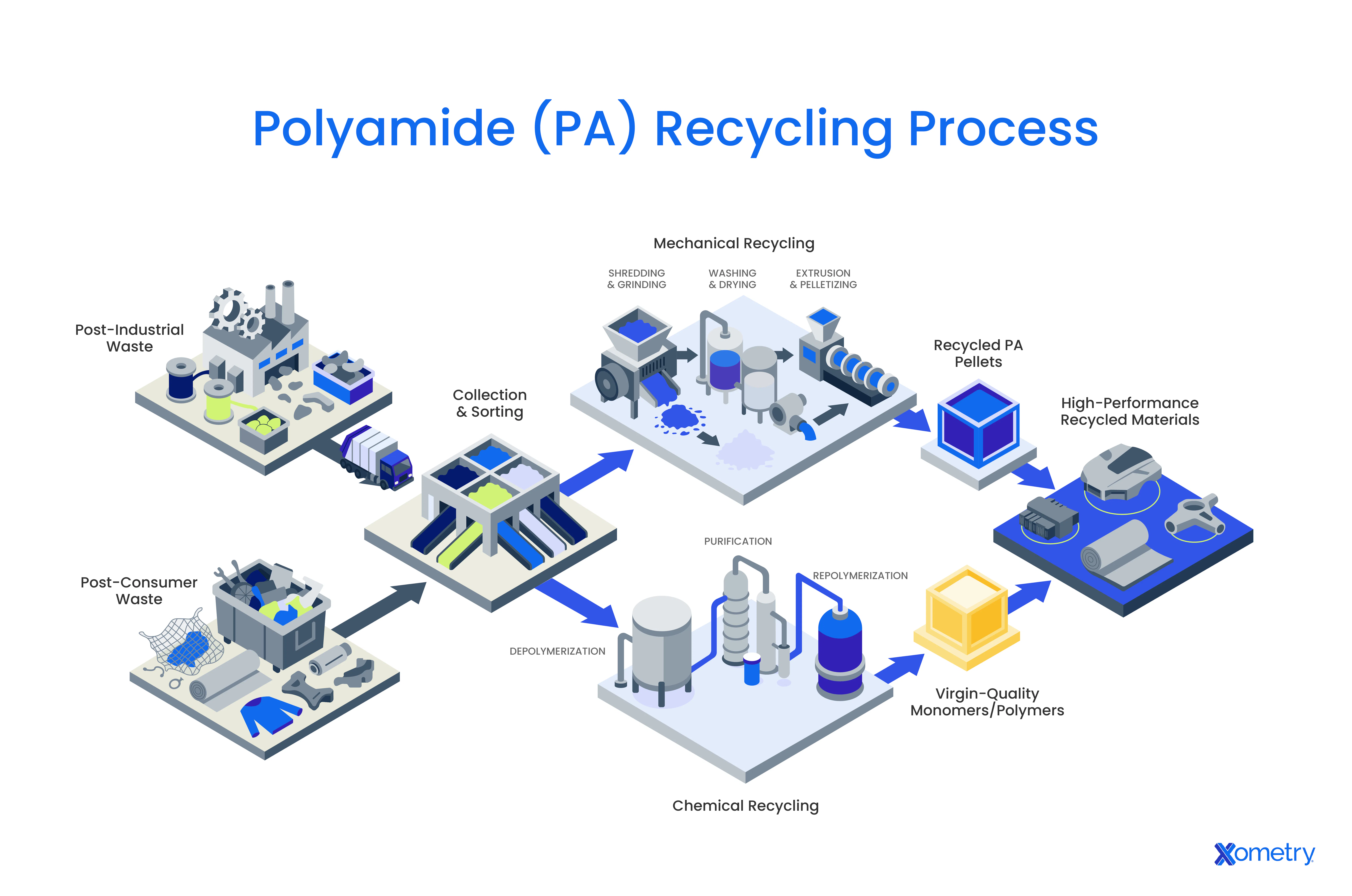

Polyamide (PA) Recycling Process
