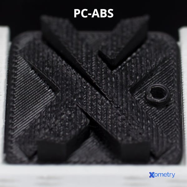

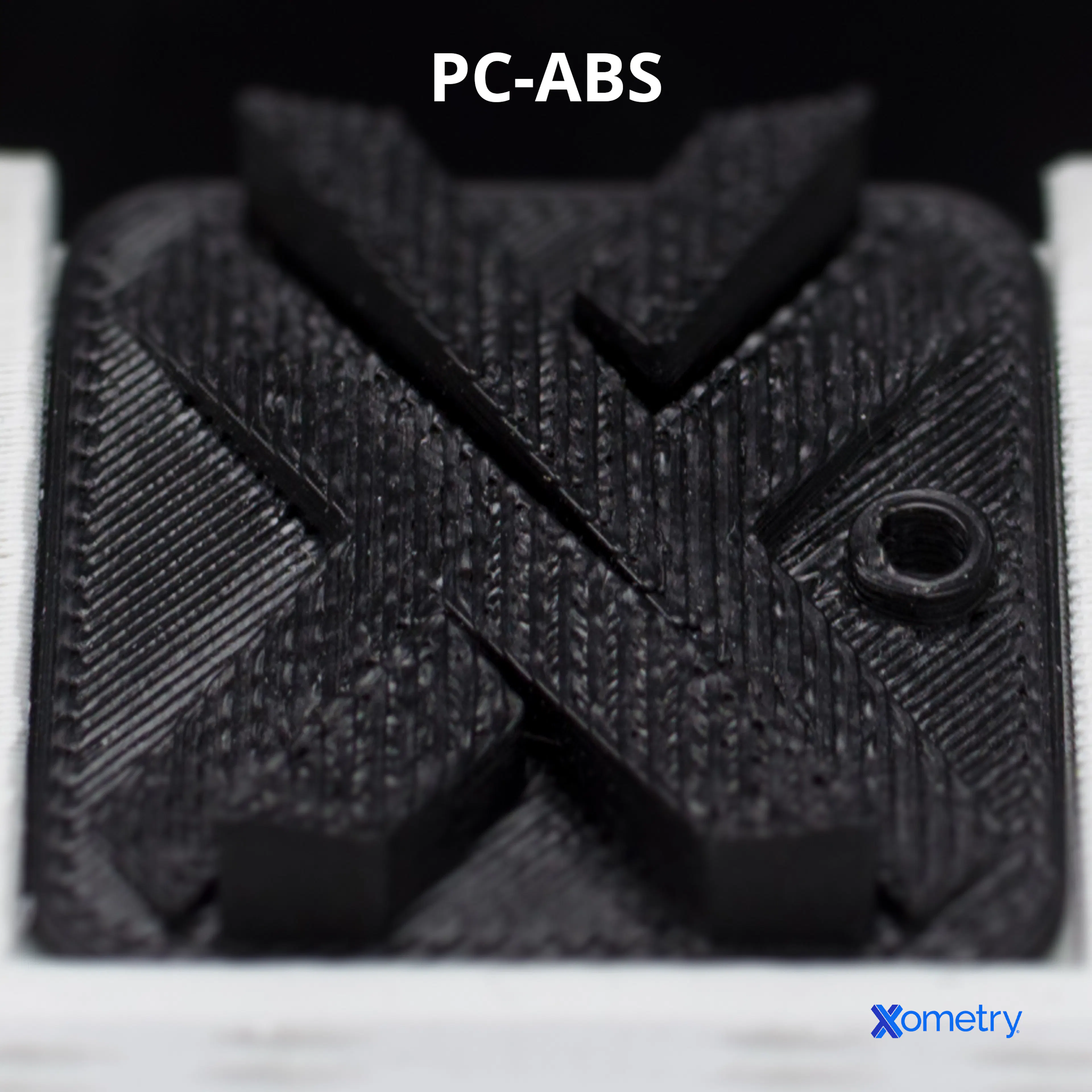

Two of the most common manufacturing thermoplastics are polycarbonate (PC) and acrylonitrile butadiene styrene (ABS). PC is tough and heat resistant, and ABS is flexible and processable. What do you get if you cross PC and ABS? A hybrid plastic with all the aforementioned perks (and then some) called PC-ABS. So, what specifically is so special about it? We can think of six things in particular and break these down below.
PC-ABS Xometry X
PC-ABS Xometry X
