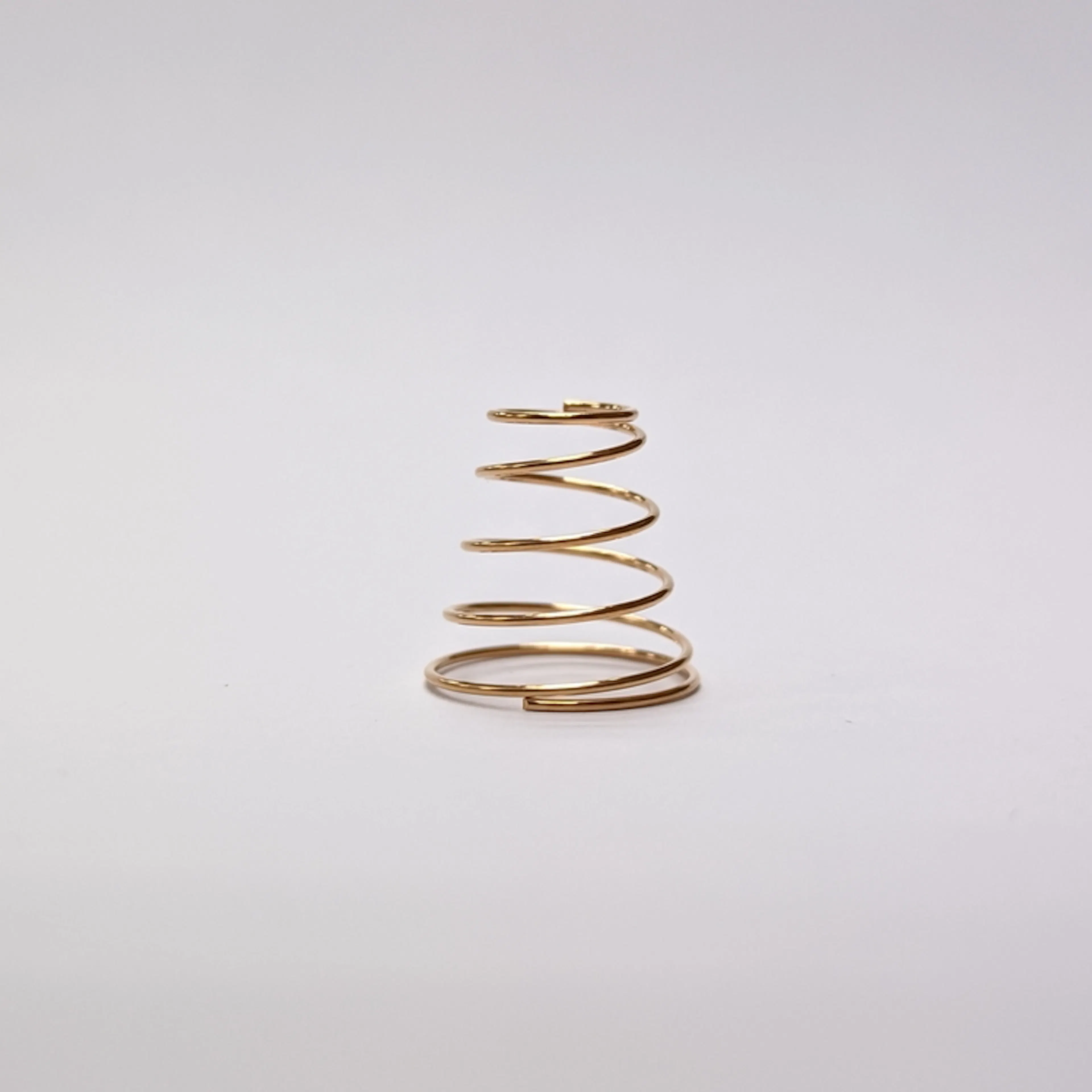

Bronze cone spring. Image Credit: Shutterstock.com/MOHD HASRI BIN HAMZAH
