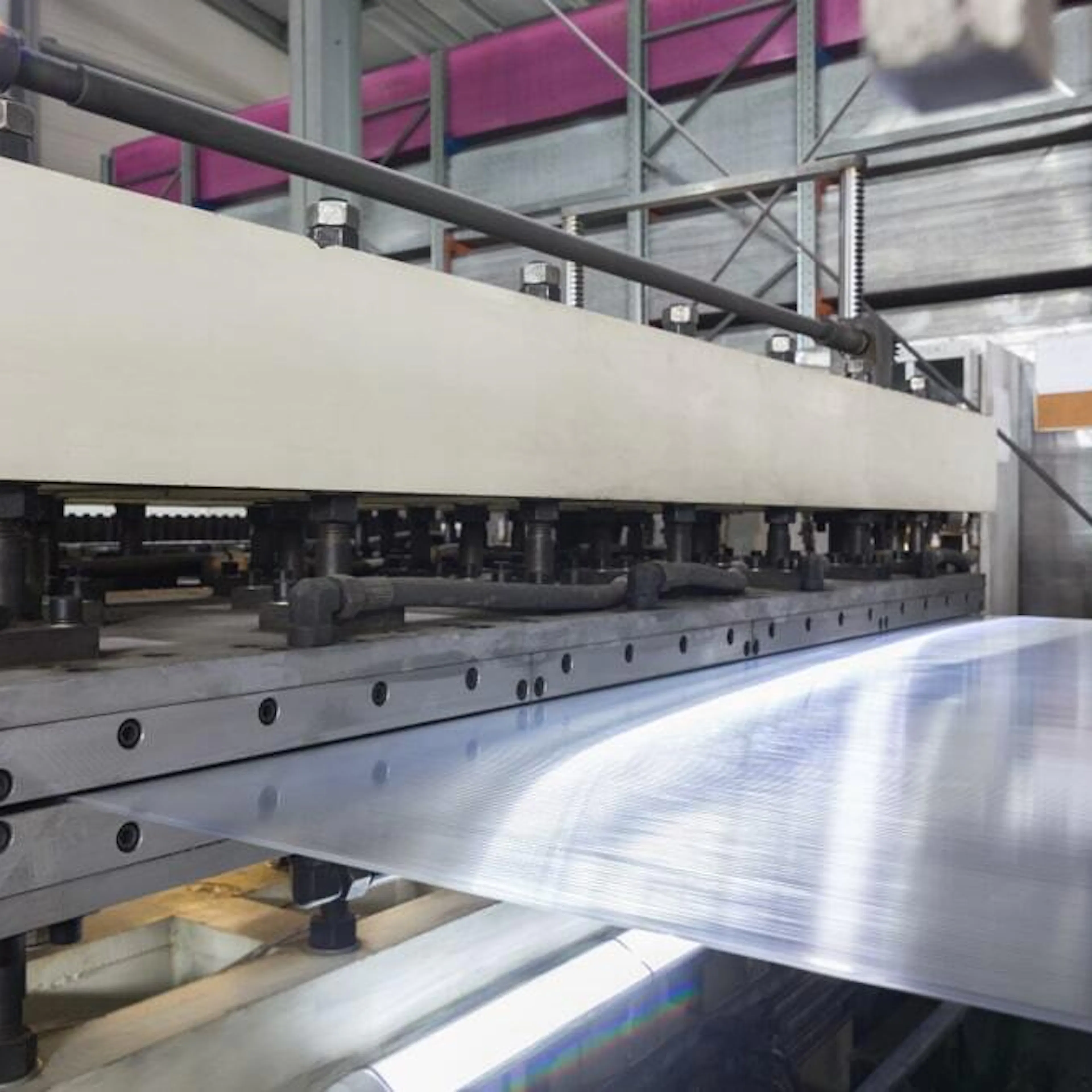

Production process plastic polycarbonate. Image Credit: Usacheva Ekaterina/Shutterstock.com

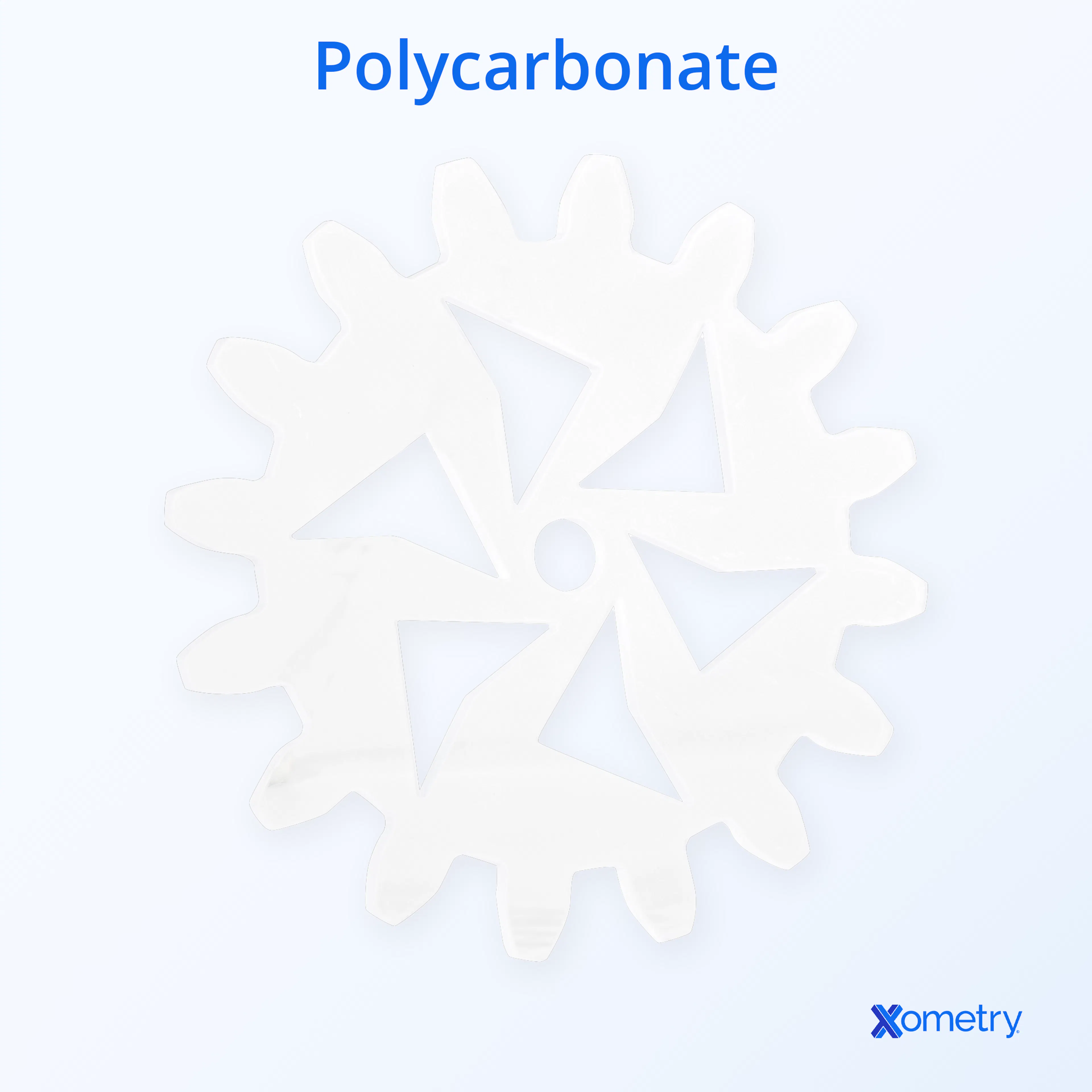

An example of polycarbonate 3D printed by Xometry
