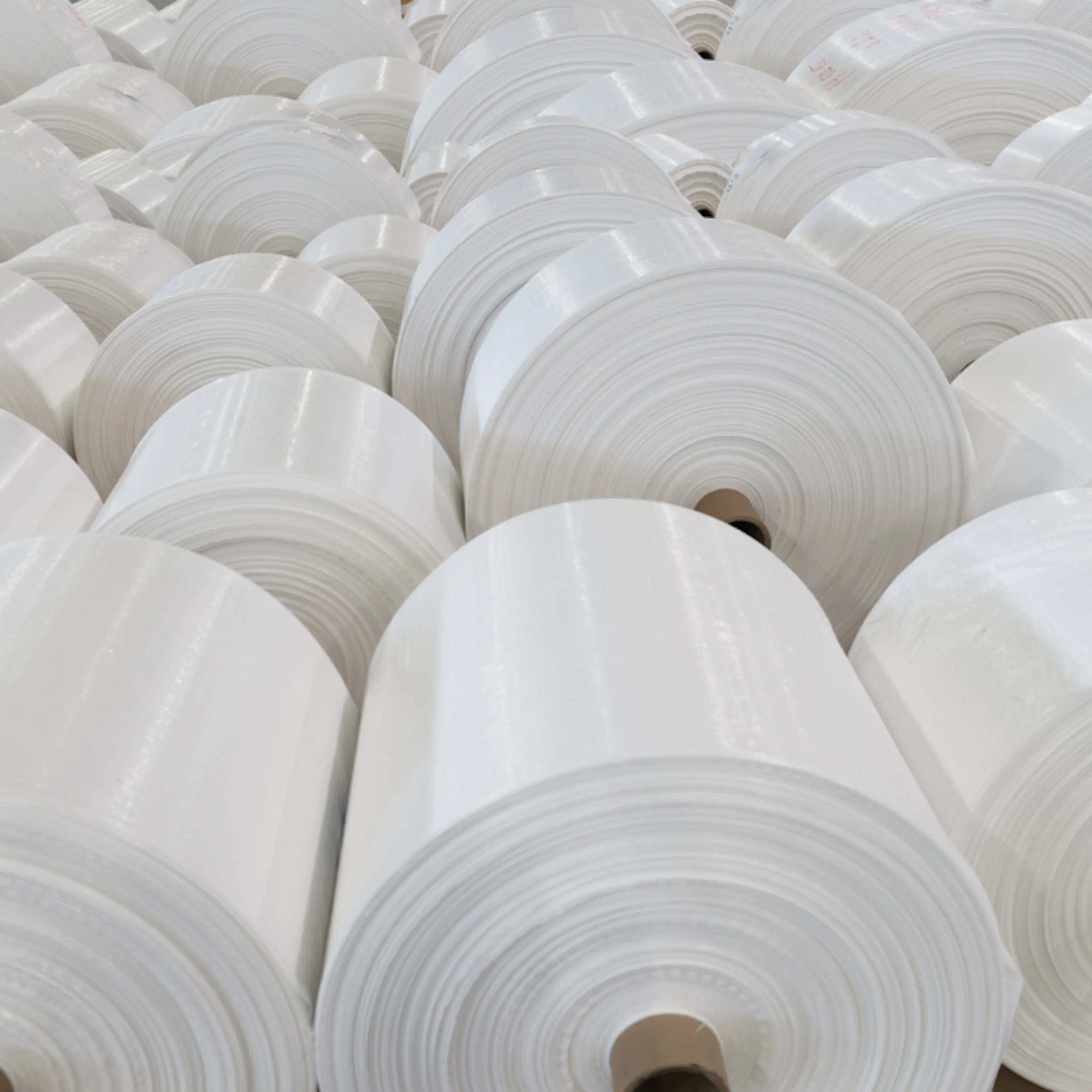

Packaging polypropylene rolls. Image Credit: Shutterstock.com/AYRAT ALPAROV

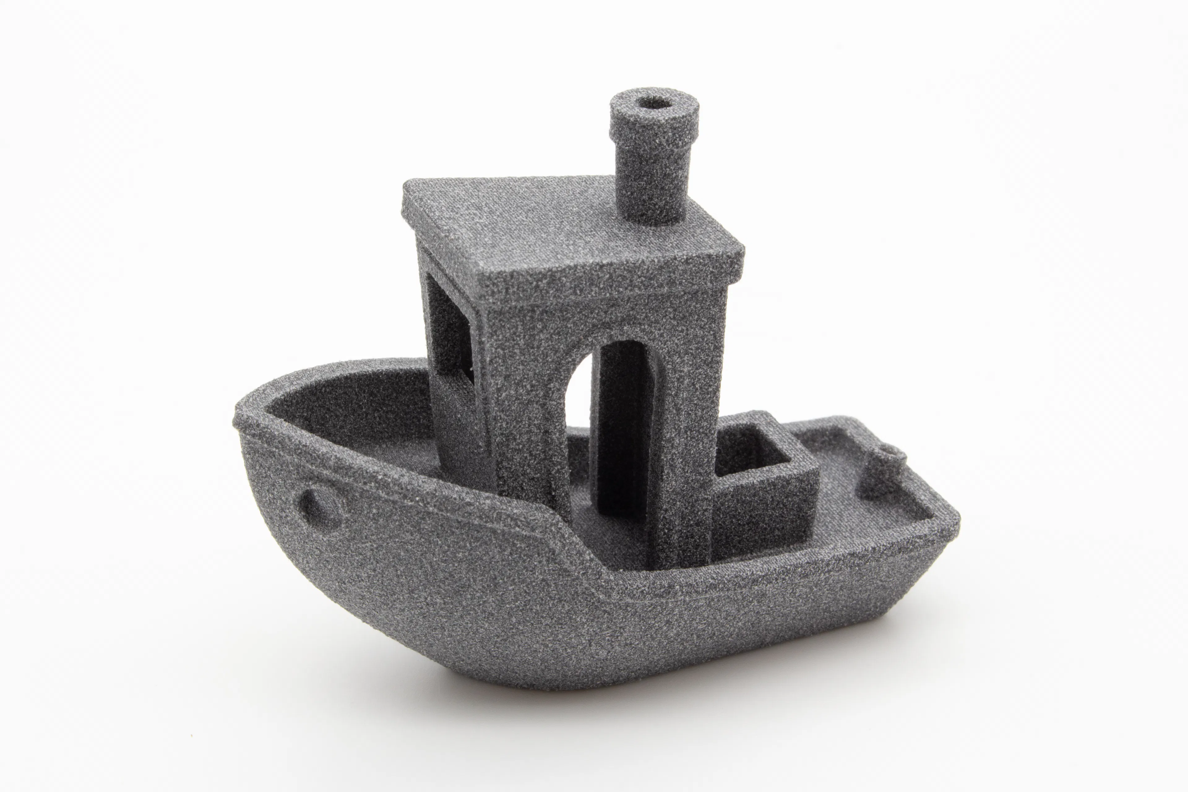

MJF polypropylene part
