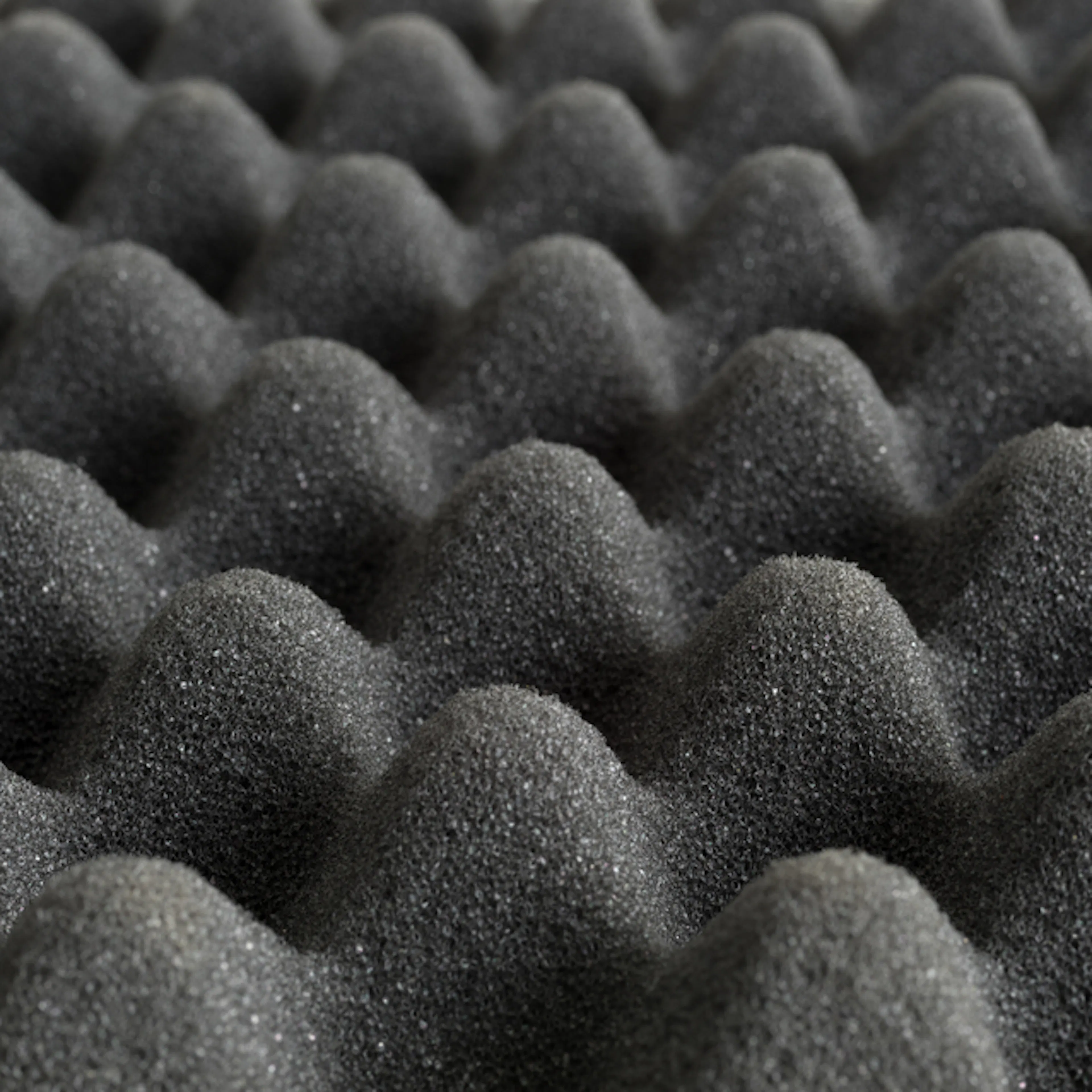

Polyurethane foam packing material. Image Credit: Shutterstock.com/Louella938

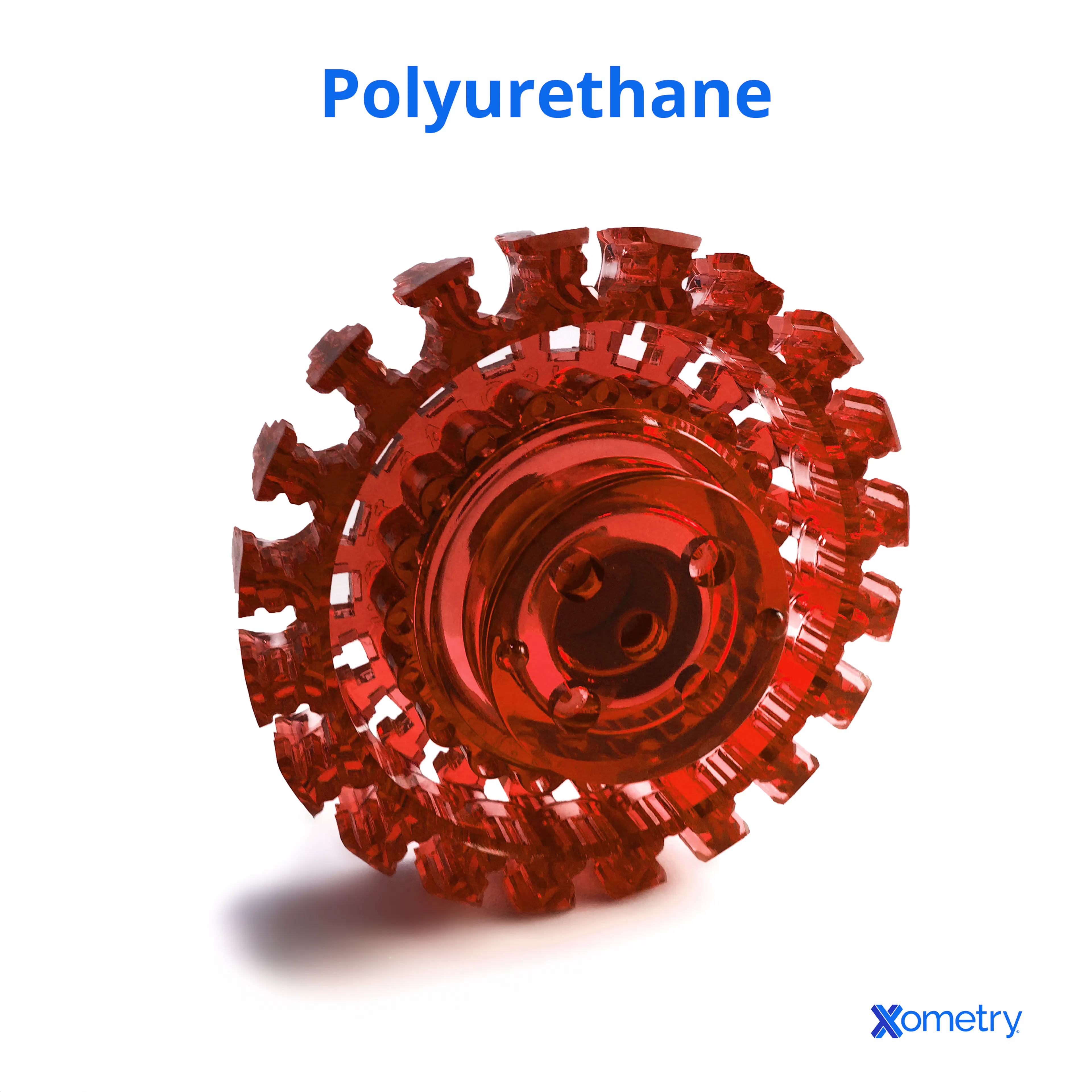

Polyurethane comes in both thermoset and thermoplastic forms. Both are created in chemical reactions that take place between diisocyanate and polyol. The thermoset variety should not be confused with a thermoplastic. Though both of them are polymers, they do not behave the same way when exposed to heat. Unlike thermoplastics, thermosetting materials cannot be melted or remolded. Any attempt to reheat a thermoset item will only char it. However, this is not always a disadvantage because, in high-temperature applications, thermoset polyurethane is more capable than polypropylene. Figure 2 is an example of polyurethane:
polyurethane part
polyurethane part
Polyurethane offers flexibility in design. It can be tailored to make the surface as soft as foam or as rigid as metal. Polyurethane can be used to manufacture a lot of parts including: cushioning for furniture, shoe soles, car parts, insulation for refrigerators, rollers, and sportswear. Water, grease, and oil do not affect the stability of polyurethane. Moreover, it bonds well with other materials such as wood, metals, and other plastics. The adaptability and design flexibility of polyurethanes make them convenient for manufacturing processes such as reaction injection molding (RIM), casting, thermoforming, and extrusion blow molding.
