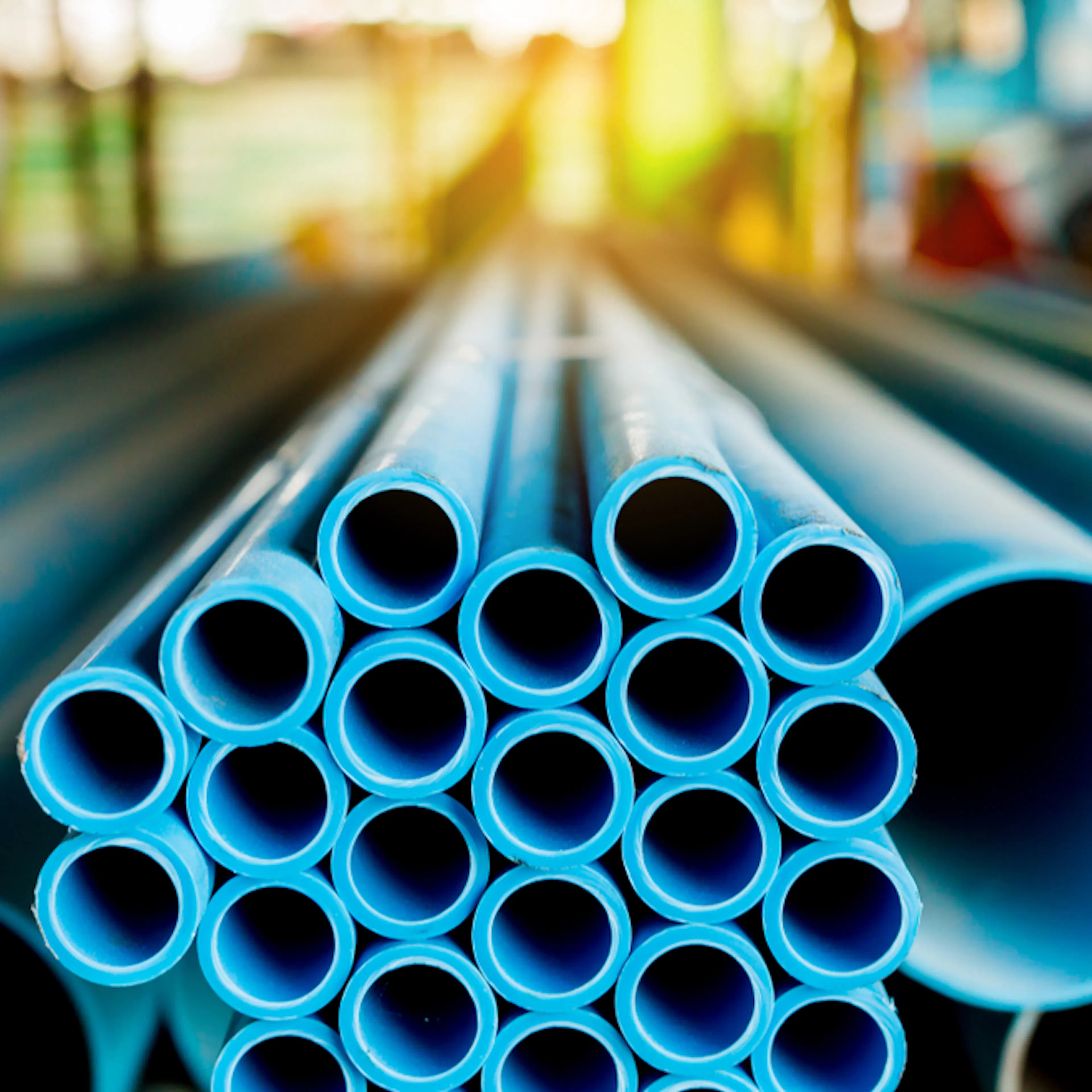

Blue PVC pipes. Image Credit: Shutterstock.com/koonsiri boonnak

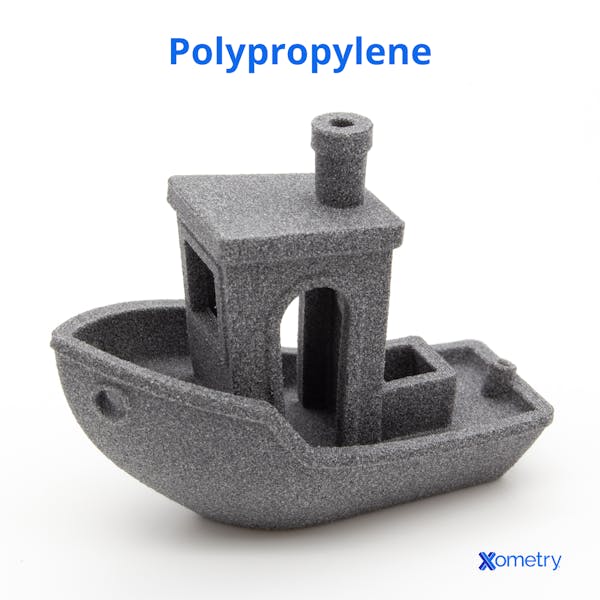

MJF polypropylene part

PVC pipe
PVC pipe
