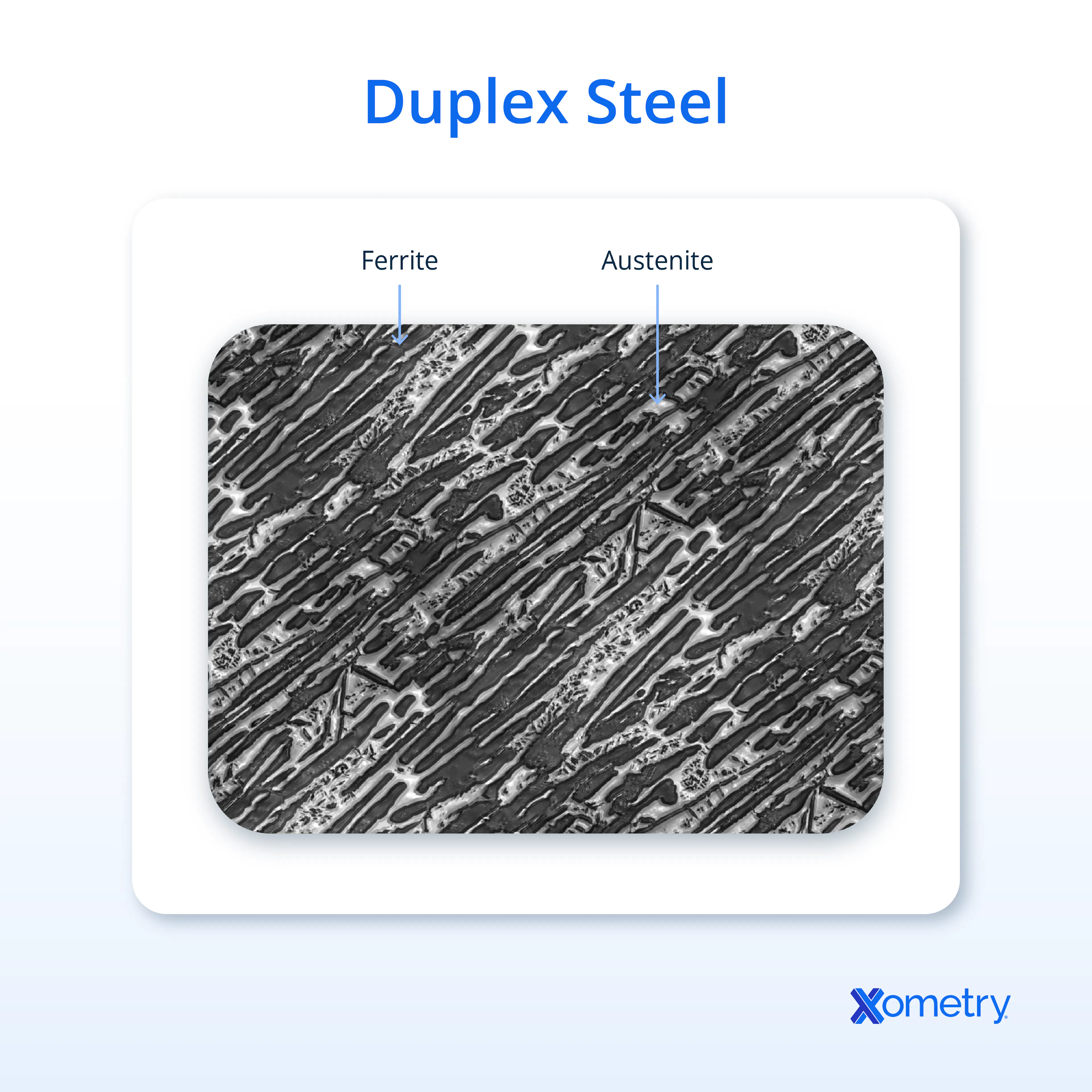

- Duplex Stainless Steel: Duplex stainless steels combine the properties of both austenitic and ferritic stainless steels. They have a mixed microstructure of austenite and ferrite, which provides excellent corrosion resistance and high strength. Common grades include 2205 and 2507 (Super Duplex).

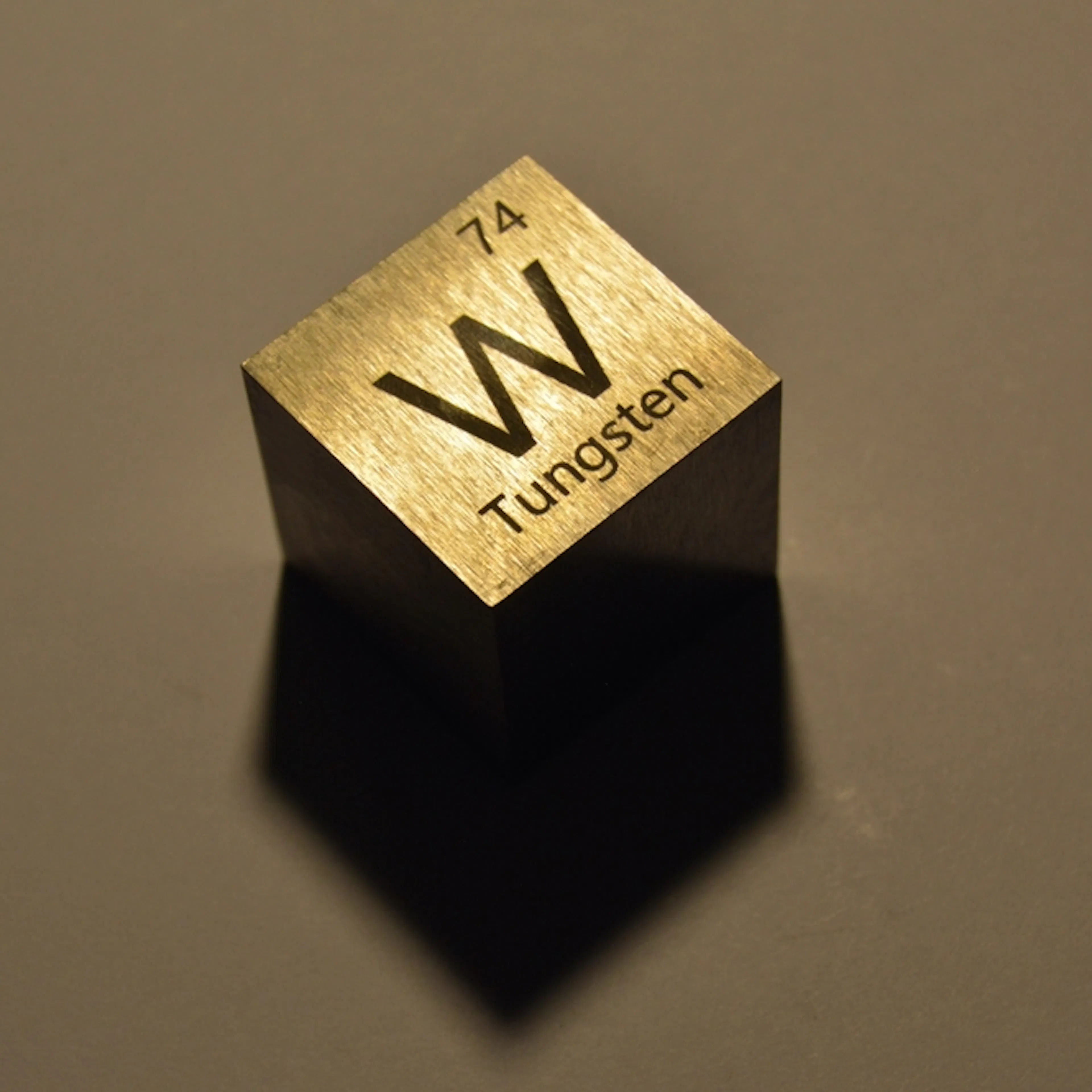

What Is Tungsten?
Tungsten is a chemical element (symbol W, atomic number 74) from the transition metals group. It is extremely dense and has the highest melting point of all metals (about 3420 °C). These properties make tungsten valuable in applications such as electrical wires and filaments, high-temperature jet and rocket parts, and as an alloying element in steel to improve hardness and durability. Tungsten is also used to create tungsten carbide, an extremely hard compound widely used in cutting tools, wear-resistant parts, and abrasives.
