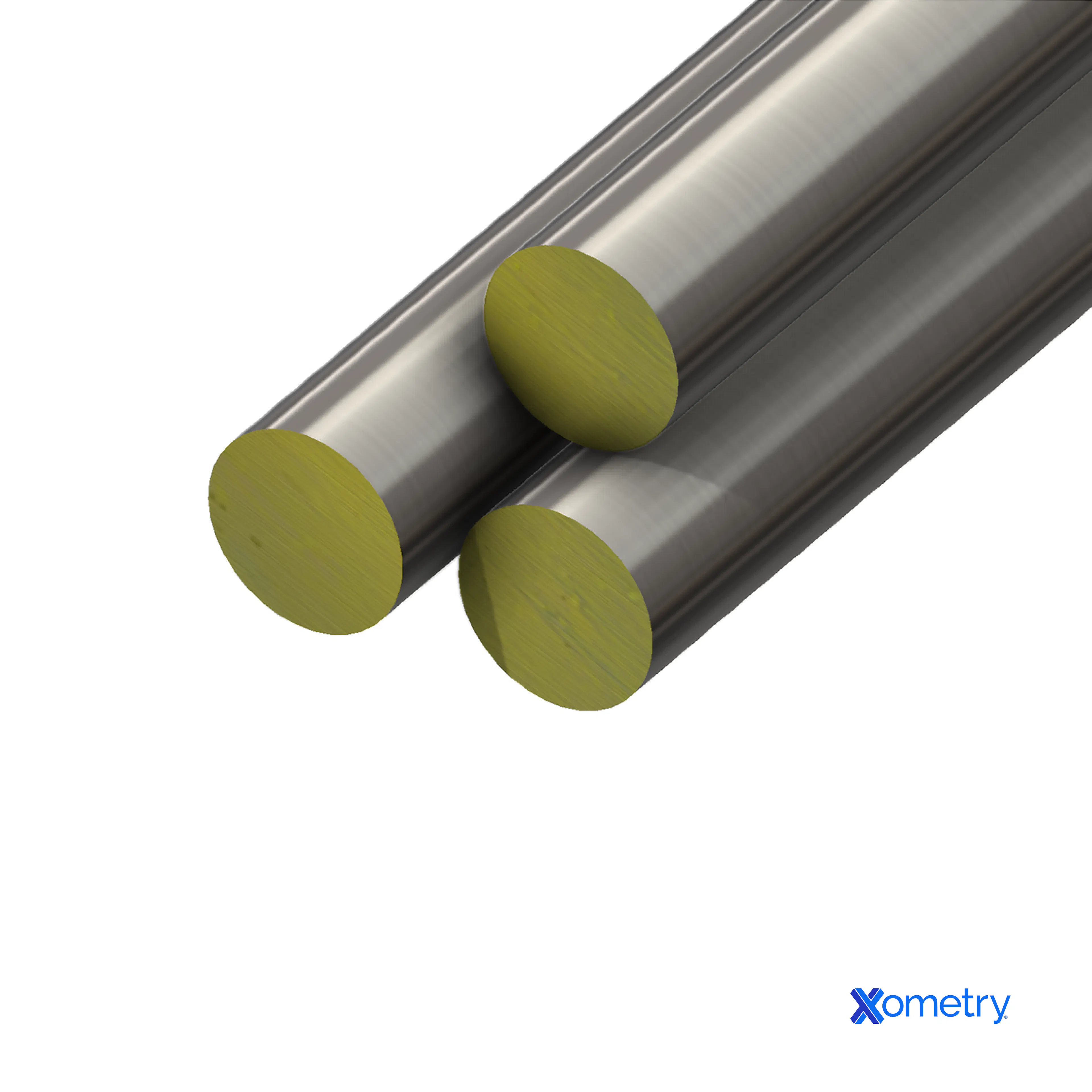

image of tool steel
Tool steel
In addition to carbon, tool steels will have other elements to improve their strength and change their properties according to what exactly the tool is needed for. For instance, nickel or cobalt can be added to give the metal extra strength and high-temperature resistance, while adding carbide former made from different combinations of iron-based alloys, like tungsten, vanadium, chromium, and/or molybdenum, can make it more wear-resistant.
